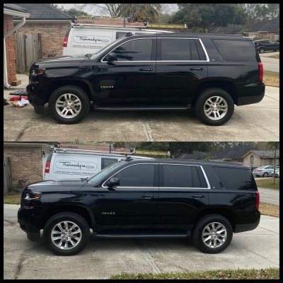

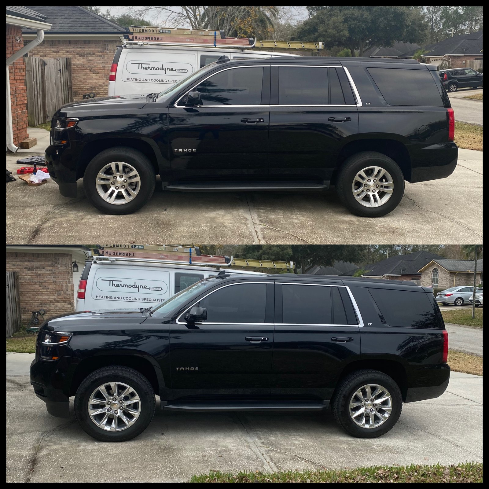

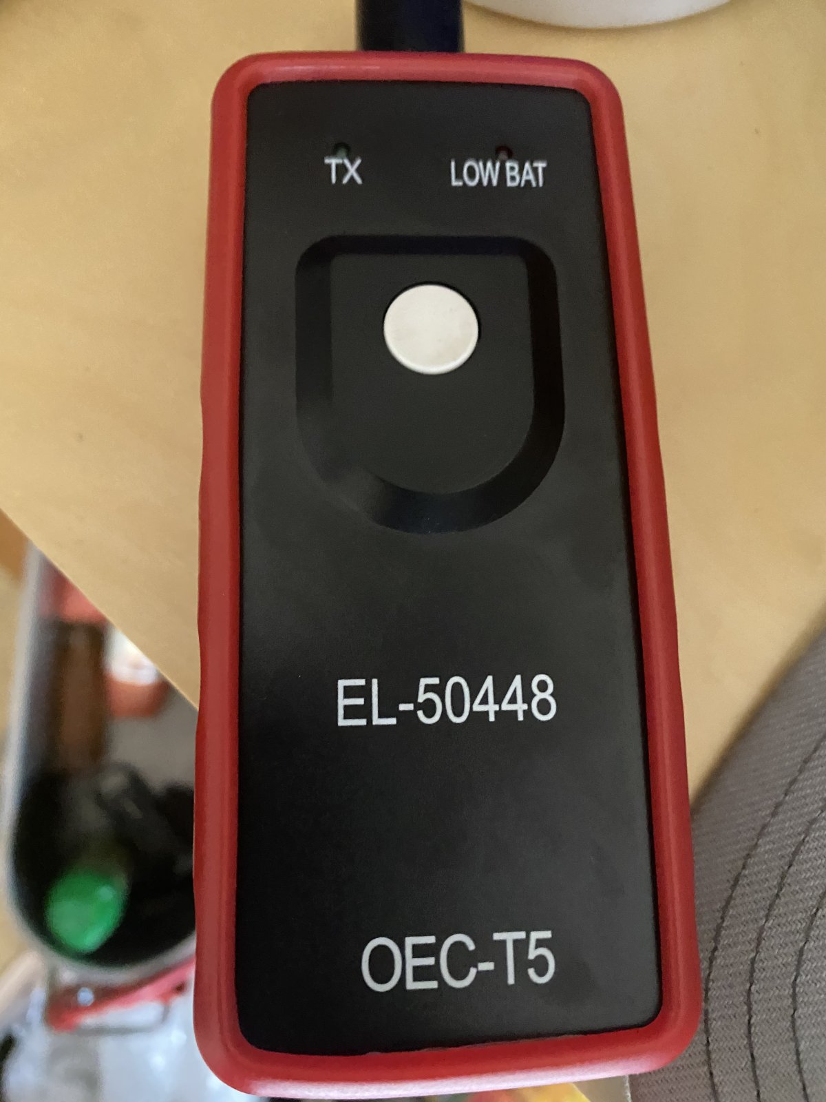

Looking for guidance on my TPMS sensors. Bought wheels and tires from a guy who has a 2021 Silverado. He went straight to the tire shop from the dealer to get something different. All they did was pull his wheels and tires off the truck and they left the TPMS sensors. I can’t get my 2018 Tahoe to relearn the sensors on these new wheels now that they are on my Tahoe. I have the EL-50448/OEC-T5 relearn tool. Thanks in advance for any help.

also do you know if the tool is working? Did you mess with your stock tires to confirm recently?

Yes, I did roll one of my original wheel/tire up to the front driver side while the truck was in learn mode and it did connect to that sensor. So I know the tool works, just not sure if it works with my new TPMS sensors. But I’m betting it’s just something to do with 2021 sensors? I wonder if everything would be just fine if I had found a guy selling wheels and tires off a 2020 Silverado instead of 2021 lol.

It seems the pre 21' used the 315 MHz system and in 21' they now use the 433 MHz system, that system can reset themselves without using a reset tool, just by driving. Your 18' truck can't talk to the new pressure sensors from what the service manual says
