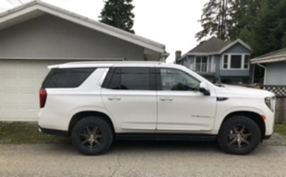

After three 2-hour visits to a tire shop — first to install the new tires, then to diagnose and replace a sensor they thought was faulty, and finally to install GMC OEM sensors — I have learned, the hard way, that our 2021 trucks’ TPMS sensors are not compatible with the previous models’.
So make sure to get OEM sensors when installing new tires!
Pictures to attract attention.

Love the stance! Are you running a lift? And can you tell me who makes your 18's? I was under the impression that Denali's brake calipers wouldnt clear anything less than 20". Would love to know your tire/rim setup, thanks!
