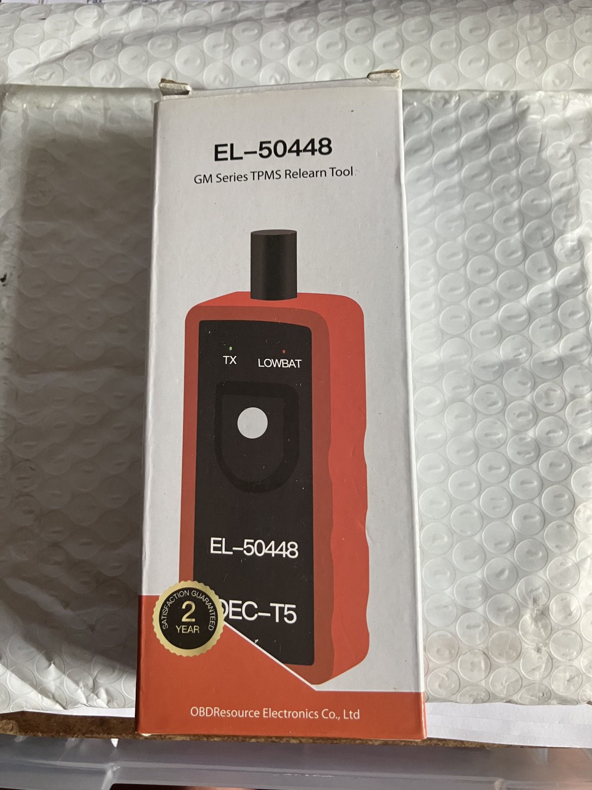

This is the tool I use (Amazon $13). When used as described in the owners manual it does the job. With that said you may have bad TMPS sensors, which you could ignore if you have a direct pressure reading gauge, until you find the correct replacements. You may want to disconnect the battery for around 15 minutes to let things settle and return to “normal “ when you reconnect the battery. Everything should return to original settings and you’ll need to reset the clock, stereo and such. Then try and relearn the TPMS as per the owners manual. Be patient and take your time, some can be touchy. Hold the tool against the tire above the valve stem. If they still won’t relearn then the next tire change get new TPMS Sensors that are for your model & year truck. Hope that helps.
Anyone else got any ideas? Aloha!!!
P.S. The previous owner might have used a tire sealant to slow leaks. The tire sealant ruins the TPMS Sensors and they need to be replaced. Plus when you break the bead of the tire it spews out and gets all over the place, so be careful. Also, inform the tire guy so he won’t get spewed upon. He/She will thank you.
