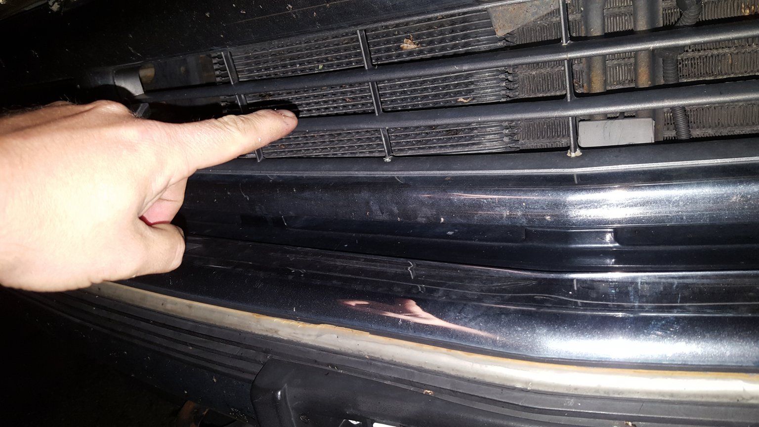

With electric brakes and a weight distribution hitch you will be fine. The weight distribution hitch will help contol some of that bounce that was mentioned if its setup correctly. And as braking you want the dial on the brake controller turned up so it feels like there is nothing behind you when you brake. If its too high you will hear the tires.on the trailer lock up and if its too low you will feel the trailer try to push you. 5-6k i would suggest adding an aux trans cooler. Nothing big or it will run too cold just a small basic one from local parts store.
gbsharon
Jan 17, 2016
i believe tow package trucks came with an aux transmission cooler. Mine has the tow package and has one that looks to be factory.
drakon543
Feb 15, 2016
2,473
1,722
Ive seen some that didnt have it on anymore. It should be there if it has the tow package but if its not it should have one put on.
drakon543
Feb 15, 2016
2,473
1,722
You will see a small cooler mounted infront of the radiator. Looks kinda like a mini radiator. You should be able to see it right through the grill.

Just got home when i was responding when i remembered mine still has its cooler. They are right out front and they are pretty durable coolers but a stick, animal or whatever can damage them. Not uncommon in various makes and models to just remove damaged auxiliary equipment instead of replacing it. Best to check and make sure its there and hooked up rather than assume it is.

Yeah I have one. So I should be ok. It's funny, on the way back from closing on the travel trailer, I saw a big travel trailer merge onto the highway in front of me. As I got closer I saw that it was being towed by a 2 dr Tahoe as well. Made me feel better instantly and took it as a bit of a sign. I hardly ever see any 2dr tahoes on the road much anymore and I don't think I've ever seen one tow anything significant and there was both in one shot as I was feeling nervous about towing.
