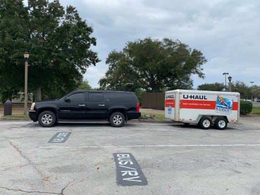

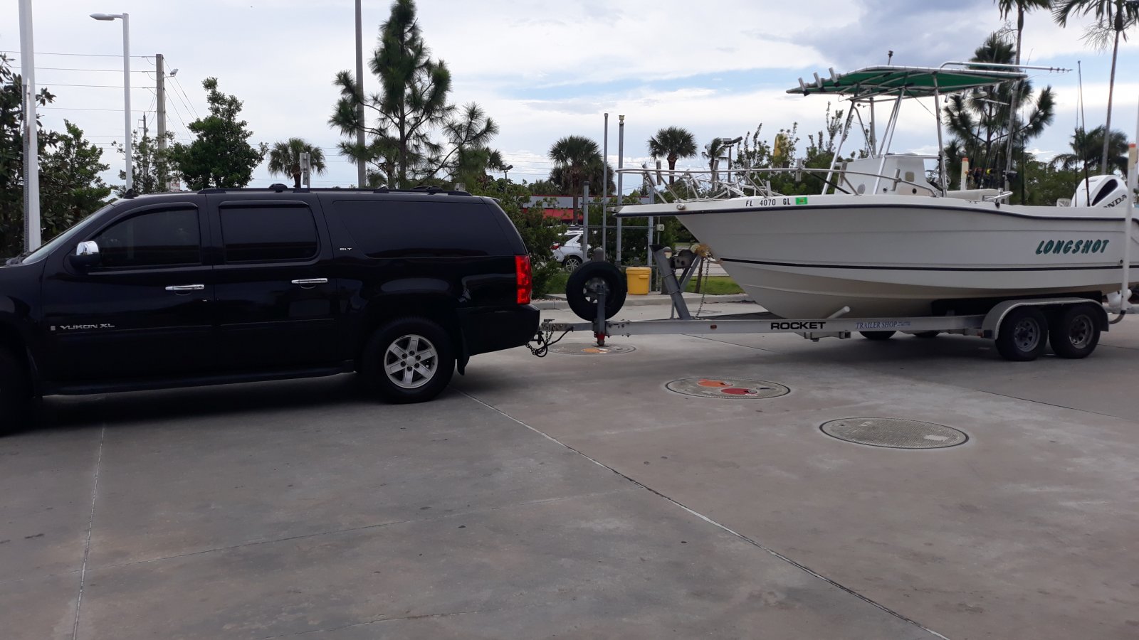

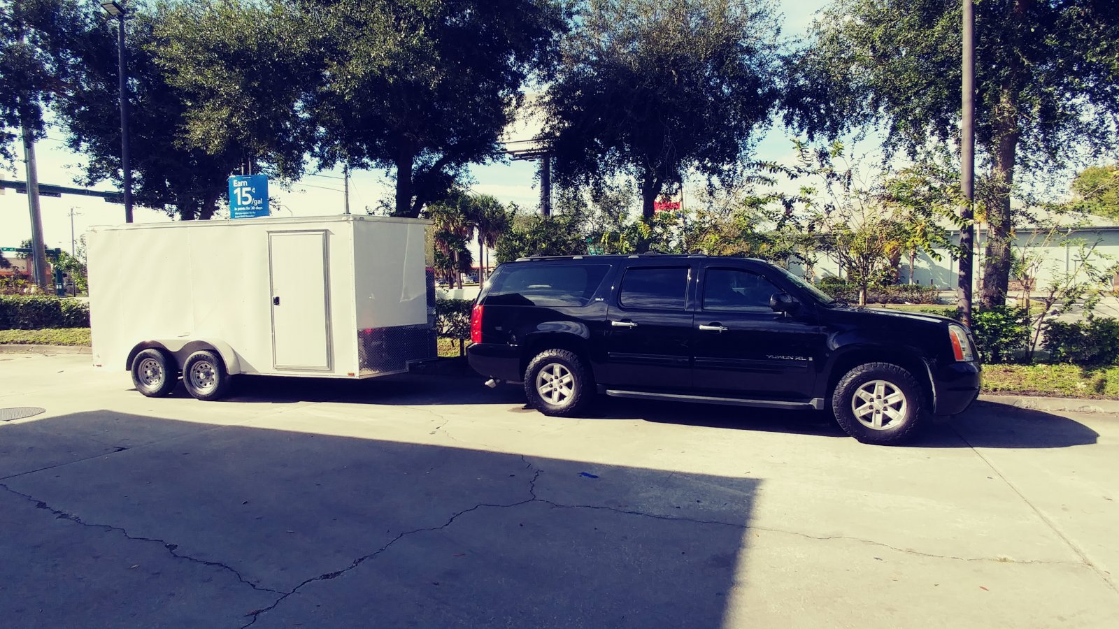

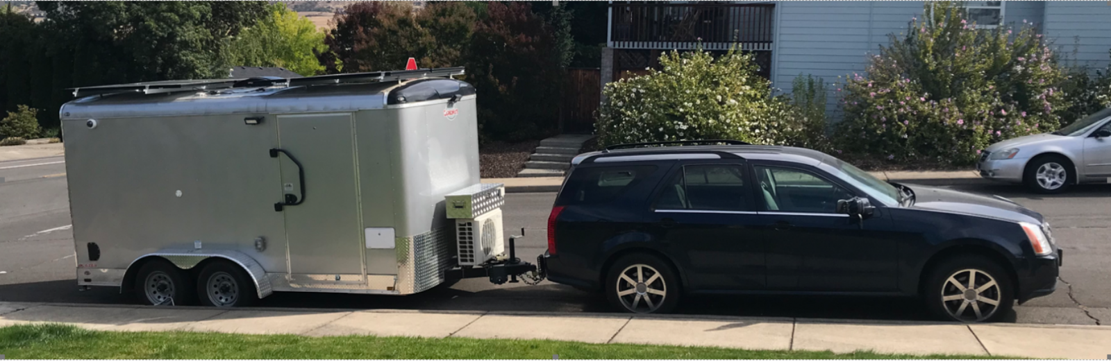

Interesting. Here's a pic of the trailer - and level is ~14.5" to top of the ball. The Caddy's receiver is ~14" to the center.
I ordered Blue Ox BLU28XR Adjustable Drop Hitch Receiver Adapter - 2" Hitches - 8" Rise/Drop - 10,000 lbs - https://www.etrailer.com/tv-review-blue-ox-adjustable-hi-low-adapter-blu28xr.aspx
The 2004 SRX (pic above) has 320hp V8 and with Blue Ox stabilizer + weight distribution pulls OK - but overheats going up a even a moderate grade >60F. Have to have heater blaring to pull temp back down and haven't risked anything over 75F ambient :(
I have to say, the Yukon was waaaaaaaay better in yesterday's test - and at 107F - what a pleasure to drive!! :)
