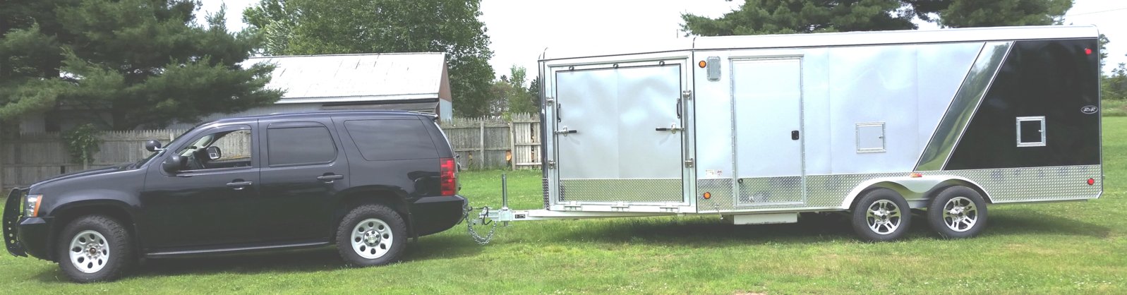

I pulled this smaller sled trailer with my 02 and 14, both with full tow packages. (02 had auto-level and everything you have). It would pull 85 if I wanted, but the mileage even at legal speeds was 7 mpg, so it was working hard. And with the 4 speed there if you wanted to go 3 mph faster the thing would downshift and kick up 700 rpm. I started driving by keeping the tach steady, not the speedo.
I love pulling the same trailer with the 14 so much more. Better power and the 6 speed trans. (Don't get hung up comparing the rear gear ratio on these two. The tow package on the 02 had 3.73, the tow package on the 14 has 3.42 due to the trans ratio being different. )
Now went with a trailer weighing all most twice as much but narrower, and better mileage yet. Wind resistance, not weight, was my issue.
