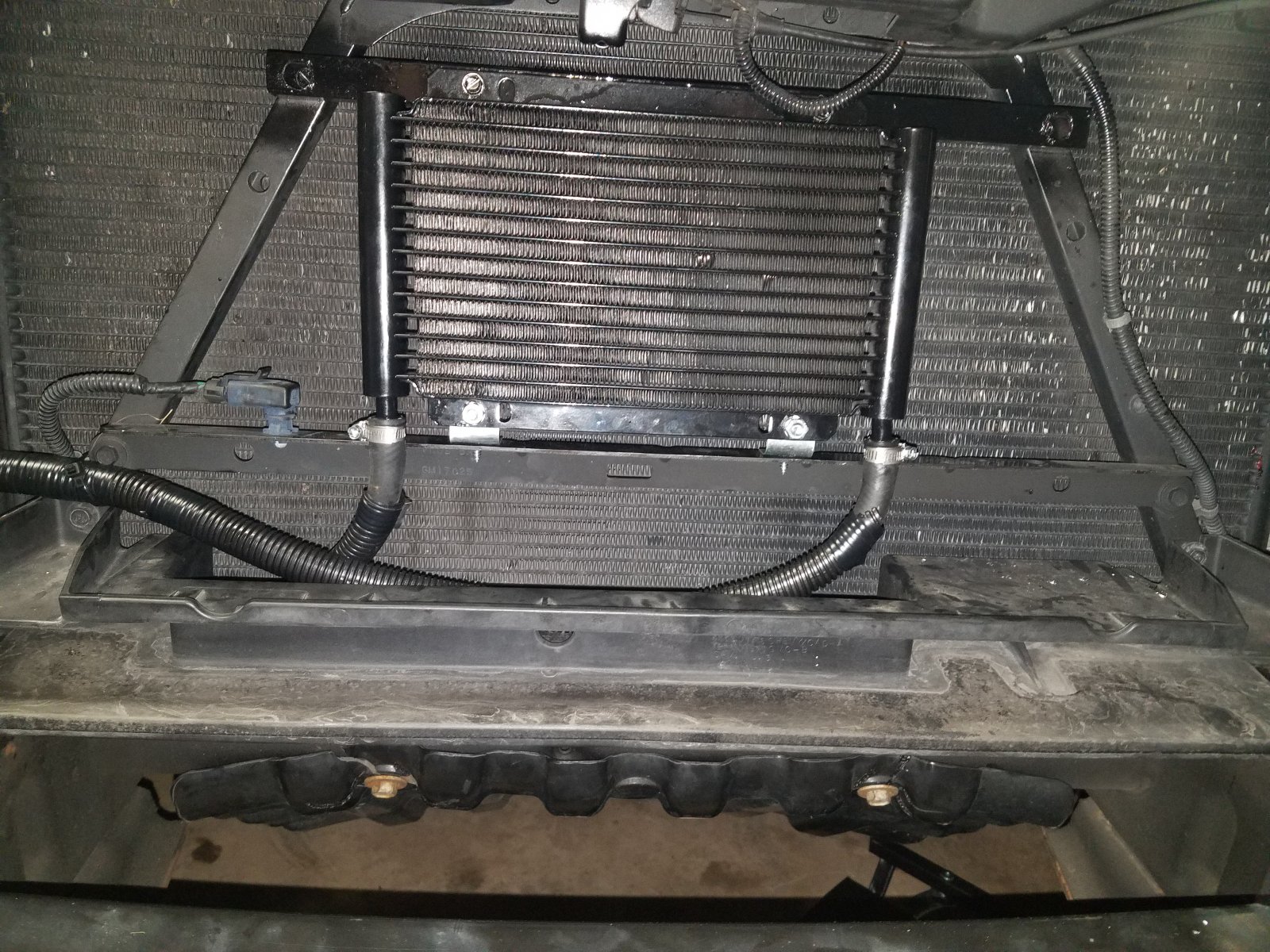

My truck is currently at the tuners so i cant look at rpo code right now but you are correct 09 5.3 4x4 short body no external cooler factory and no built in brake control factory. But i do have 3.42s i do remember that when looking at rpo codes when i got it.
I guess i did " upgrade" to the K5L package with adding a second cooler that is external so it goes through rad and then into external cooler amd back into the trans i may add a fan im not sure yet. Plus the brake controller.
So with that being said i should be able to tow up to 8400 and be within GM'S reccomended tow rating. As i not technically have that trailering package?

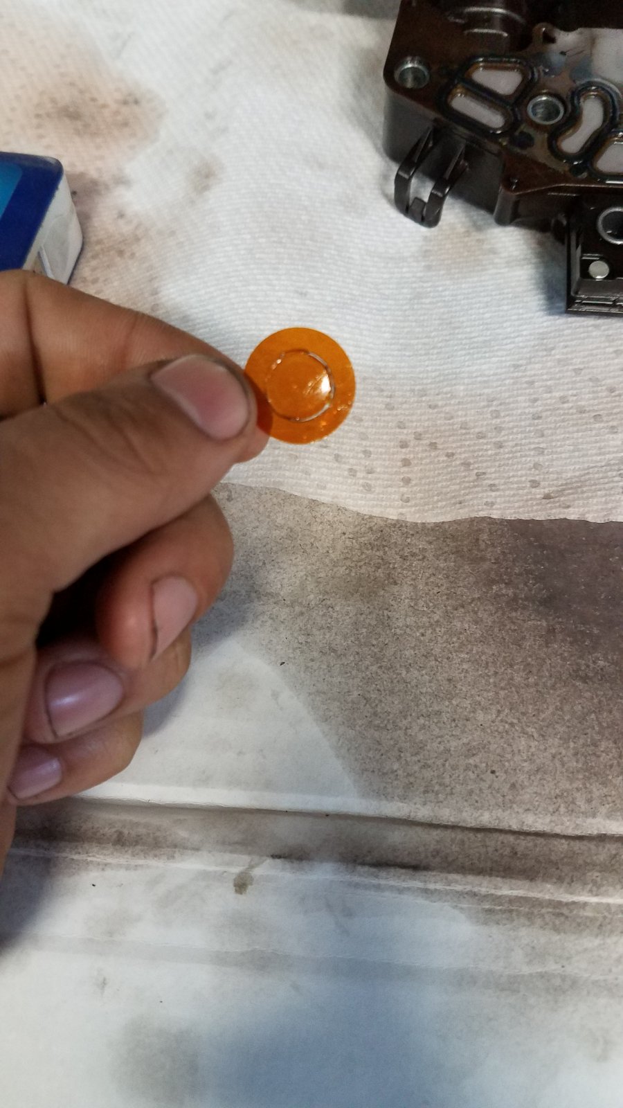

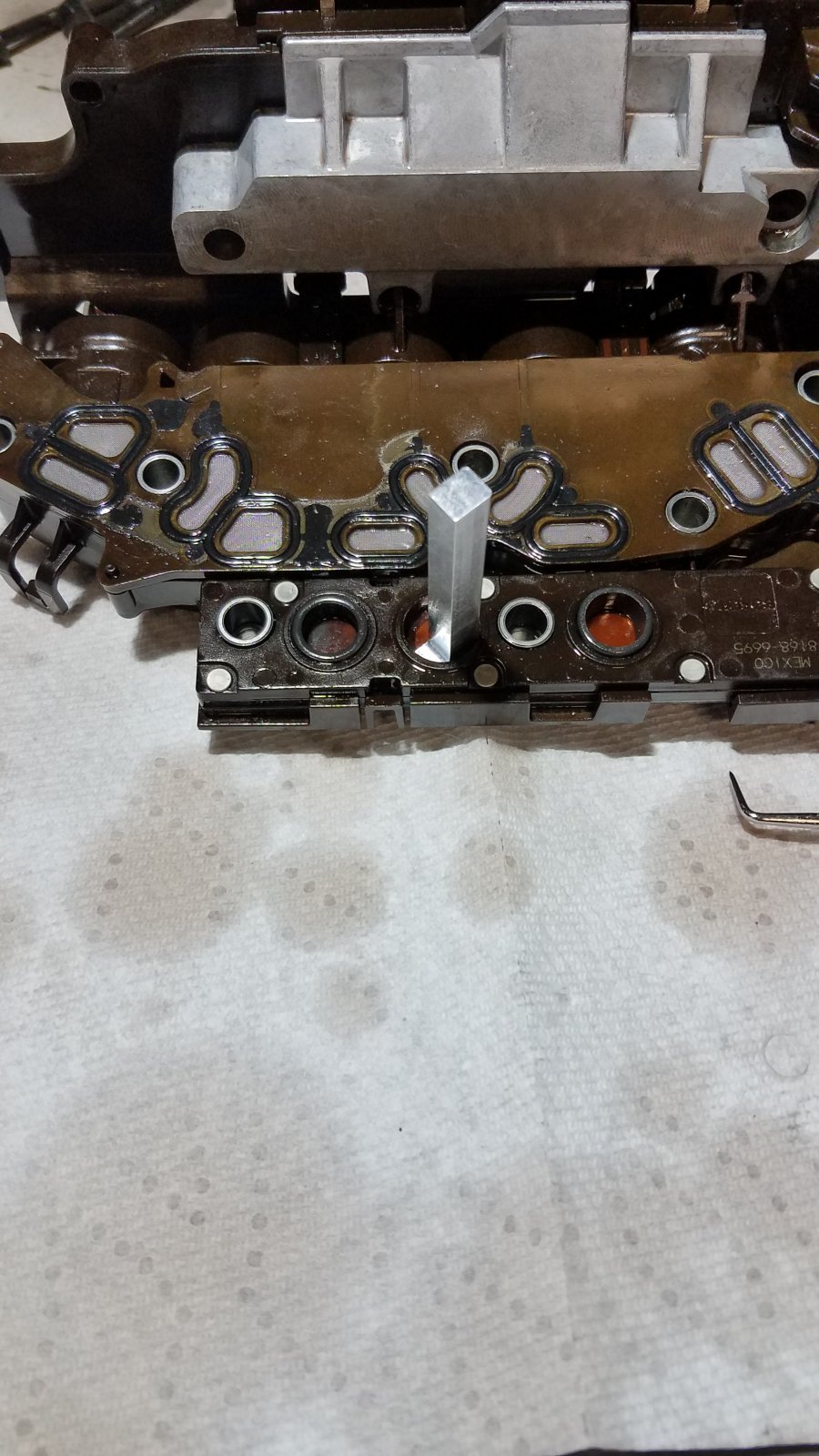

I did the valve body and pressure switches on Friday, installed in the truck did the transmission relearn procedure.
before that i flashed my tcm back to the orignal program to revert my pressure changes to see how it performs.
Took it for a drive, and I'm loving the improvement!
I added the transgo shift kit regulator valves, and the separate transgo tcc kit (was mentioned in the transgo shift kit instructions as an option)
Topped off with sonnax non shrinking check balls, and their end plug kit.
I found one of the laminate disks was about to fail.
When removing the disk separated right in the middle.
The rest came out fine, but i replaced all of them for good measure.
Also installed a new ac delco separator plate and the pressure switch screen kit.
the screen kit also came with new vb to case seals.
it was pretty clear looking at the old vs new, the old had flattened a tad...
Transmission shifts much faster now.
Still a slight delay in what i believe is the 2-3 shift...
I also bought the sonnax tool to install the laminates and the pressure switch seals.
I found them to be very helpful, and very slick to install the seals!
The transgo shift kit came with the seals, and the laminate disks, as did the sonnax tool.
Having a full extra set of spares was very handy.
I found it a little difficult to get the disks in with out adding a crease, but right at the end i finally got the hang of it with one laminate disk left... :rolleyes:
I was also able to get a good look at some of the clutches with the valve body removed, i haven't looked up to see what clutches, but they all have a ton of life left.
Anyways, figured i would share my experience.
