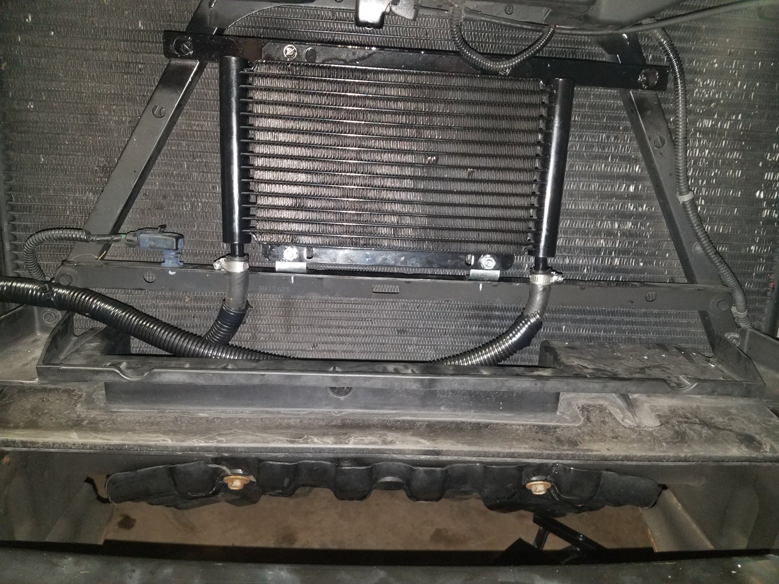

I guess i did " upgrade" to the K5L package with adding a second cooler that is external so it goes through rad and then into external cooler amd back into the trans i may add a fan im not sure yet. Plus the brake controller.
So with that being said i should be able to tow up to 8400 and be within GM'S reccomended tow rating. As i not technically have that trailering package?

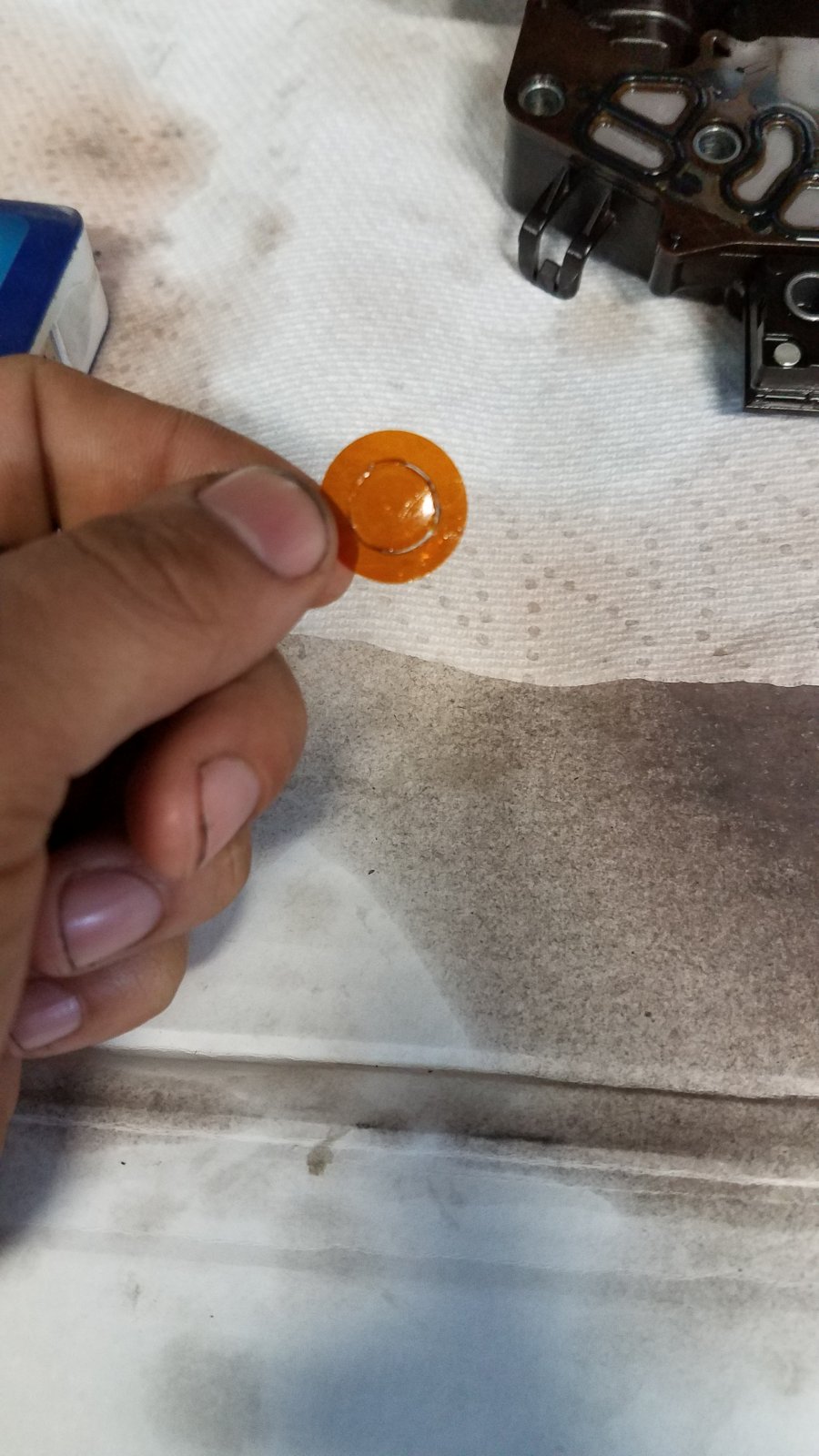

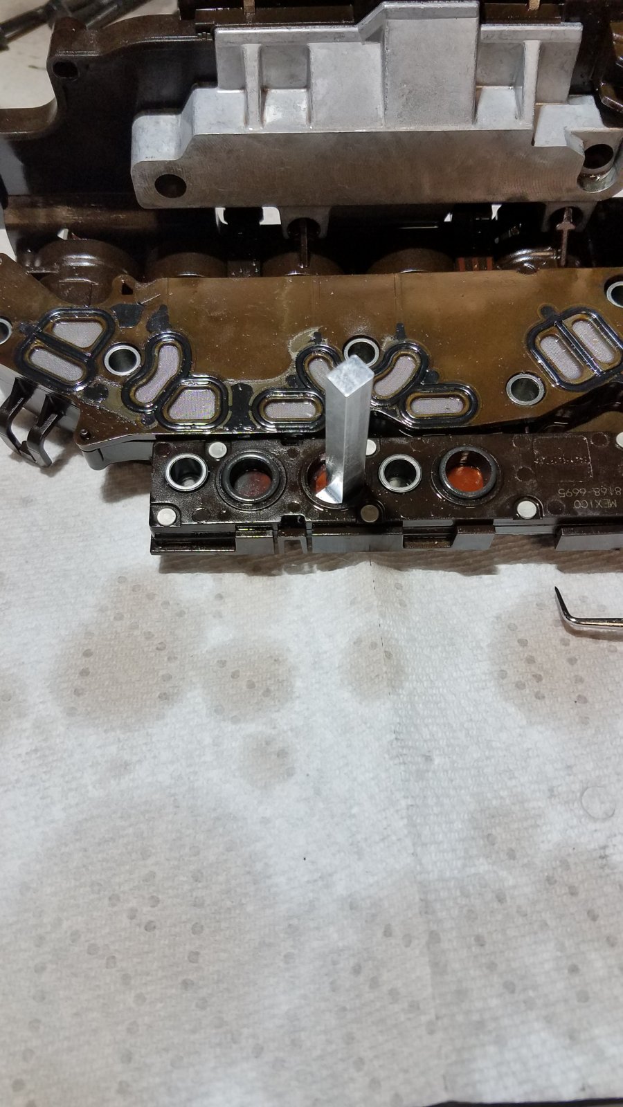

TECHM went slow lol. I found all of the valve body tq specs and procedures,all the placements of the check balls. I watched countless videos and just took my time and it fixed all of my trans issues with the exception of the 2-3 flare. 3 out of 4 diphgrams where cracked/ blown out. I replaced all the check balls, new plate in the valve body i also took some of the springs out and did an overall cleaning of the valve body. I cut open filter and took it to local trans shop and they said it looked perfect for 113k trans.
View attachment 245780 View attachment 245781 View attachment 245786
I'm glad that went well and hope that your experience inspires others to rebuild their TECHMs too and avoid unnecessary rebuilds.
If your 2009 was built prior to December 2008, the cause of the 2-3 flare maybe caused by leakage in the sealing ring area on the pump cover which feeds the 1-2-3-4 and 3-5 reverse clutch packs. GM has a new design pump cover with 2-piece sealing rings with anti-rotation tabs which will also work on older design pumps. New pumps come with them already installed, 24248573. Must use a pump alignment tool. No genius here, just picked up a copy of the ATSG 6L80 Rebuild and Service Manual.
It really wasnt bad as long as you take your time. If anyone has questions they can contact me.
Man i wish i knew that was the fix when i had the motor out, I could have pulled converter put and swapped put the trans pump probably wouldnt take long if i had all the tq specs and what not.
Yeah, but still not a big deal if you're physically able to pull it out, fix it and pop it back in over a weekend or even a whole Saturday. Oh to be young again, we used to pull a race car into our shop and 60 minutes later the motor was a bare block!

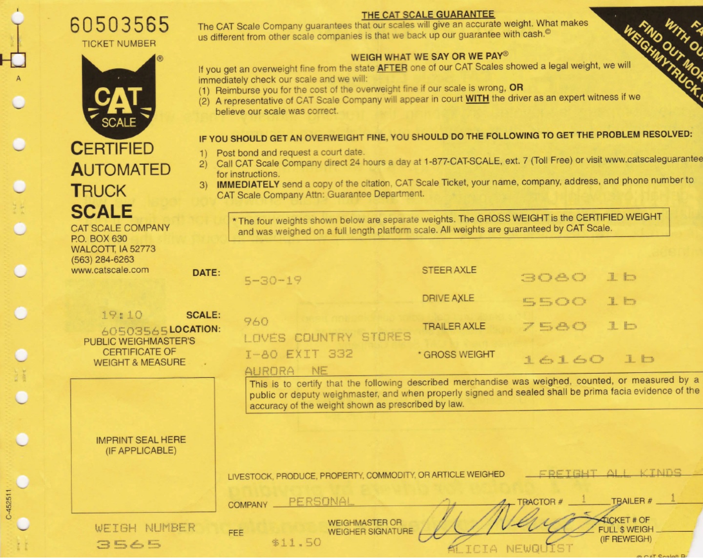

ETA: Weigh slip from my last long haul to Wyoming last year. Plug these numbers in for a Tahoe, and let me know how that works out...

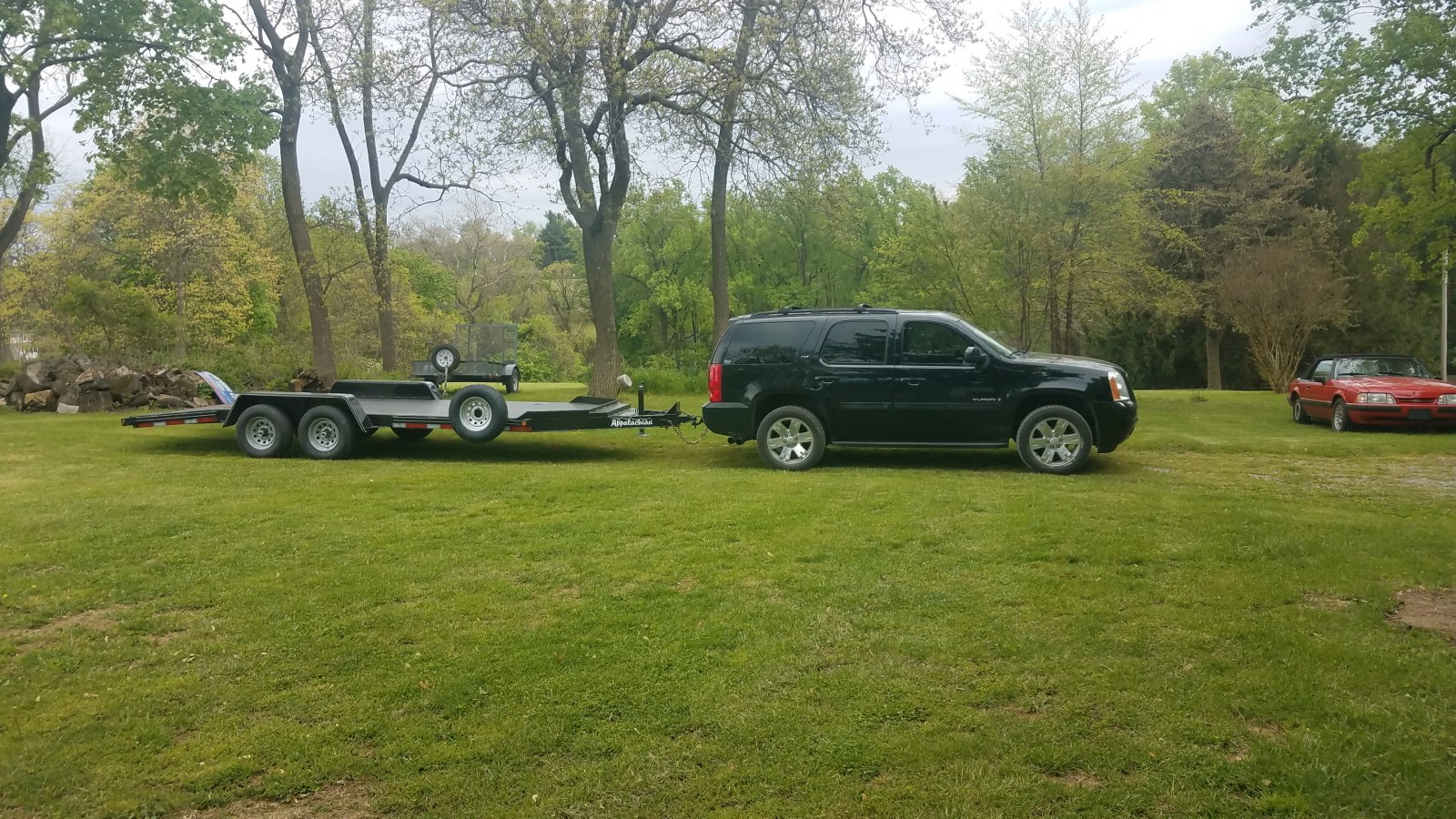

Picked up the trailer yesterday with towhaul its not bad at all, It levels the yukon out empty, When i load mustang up it squats pretty good so ill freshen up the rear with new oem shocks new springs and a ill install some air bags in the springs to help out.
