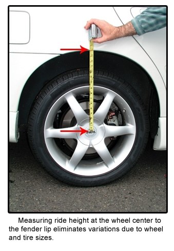

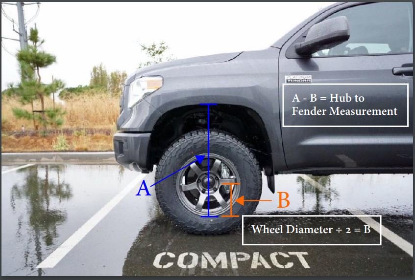

The most accurate way to measure corner height is from the bottom of the fender, directly over the vertical center line of the wheel, down to either the top wheel lip, center of the hub (wheel centercap) or to the bottom of the wheel lip. You don't go from fender to ground since this can be skewed by tire. You also have to roll it forward or back after lower it back down off the jack so it's settled. Ideally, you'd go for a short drive up and down the street or around the block, bonus points if there are speed bumps or rough roads to ensure the suspension is settled.

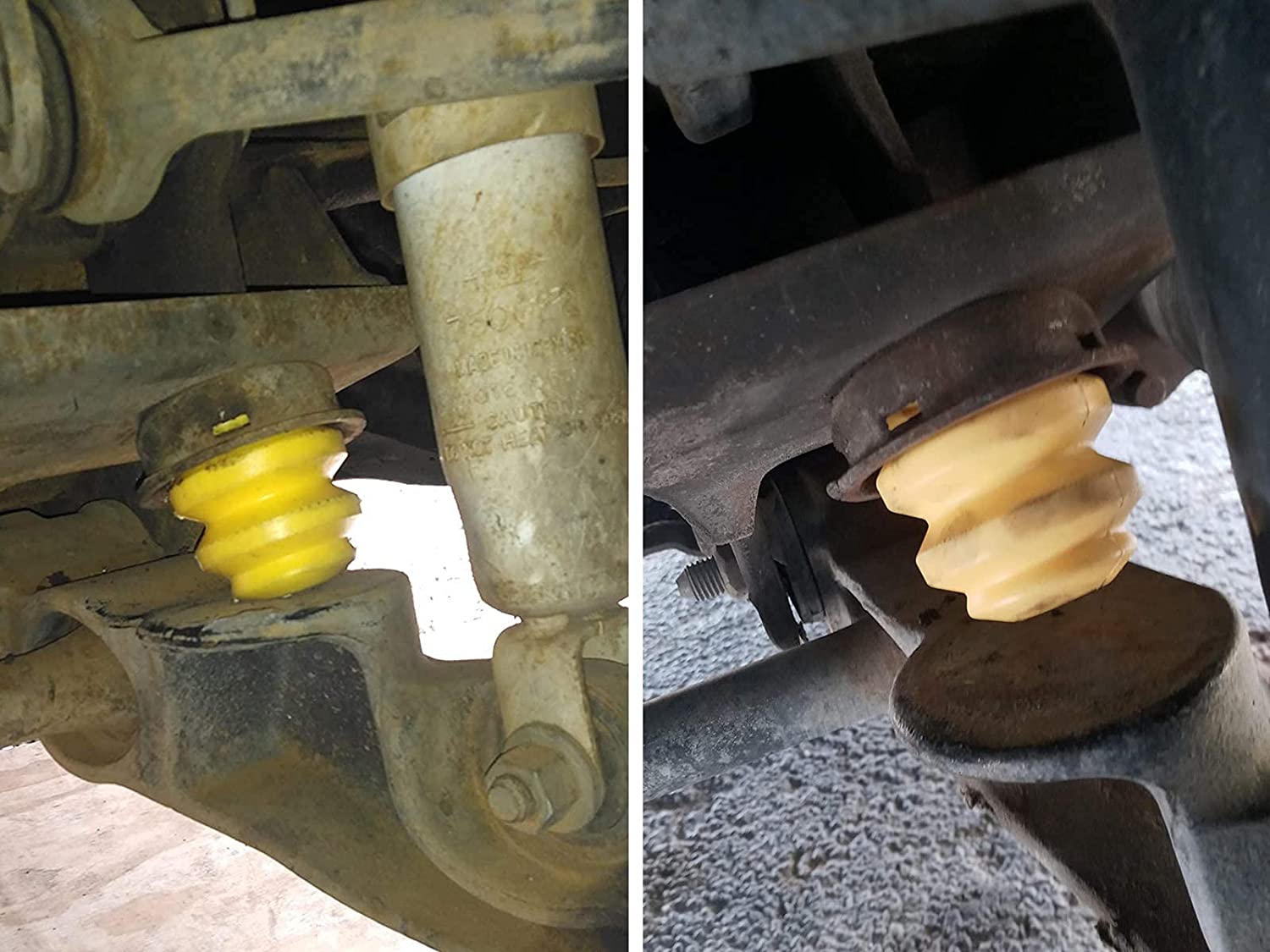

To get an idea of where they should be set from the factory, you'd first need the jounce stops to be in good condition. These are the foam, originally yellow bump stop-looking things on the frame right above a circular pad on the control arm. At ride/resting height, they should be just a hair away from touching the pad or lightly pressed onto it. If they're old and squished, and with yours being lifted, there's bound to be a decent gap between them. Replace 'em and see how it sits and rides.
Measuring points-
Fender to hub/wheel center:
Fender to lower lip, through center line ("A" in this example):
Jounce bumpers:

Are there jounce bumpers in the rear also? I don't remember what the front ones look like, but I do remember seeing something like those on the rear and they looked old and dry-rotted. I didn't think much of replacing them, because I thought they were only there in case you hit a bump so hard that it bottomed out. I would assume if they are the same thing on the rear as they are on the front, and the rear ones looked that bad, I should just replace all of them.
Thanks for the detailed explanation of everything. It definitely helped.
The ones in the rear are bump stops. They're very similar to the ones in the front in appearance. The difference is the front ones are to supplement the springs. They are constantly under load and squish along with the cycling of the suspension. The rears are to give a soft impact when limiting maximum upward travel of the rear axle.
