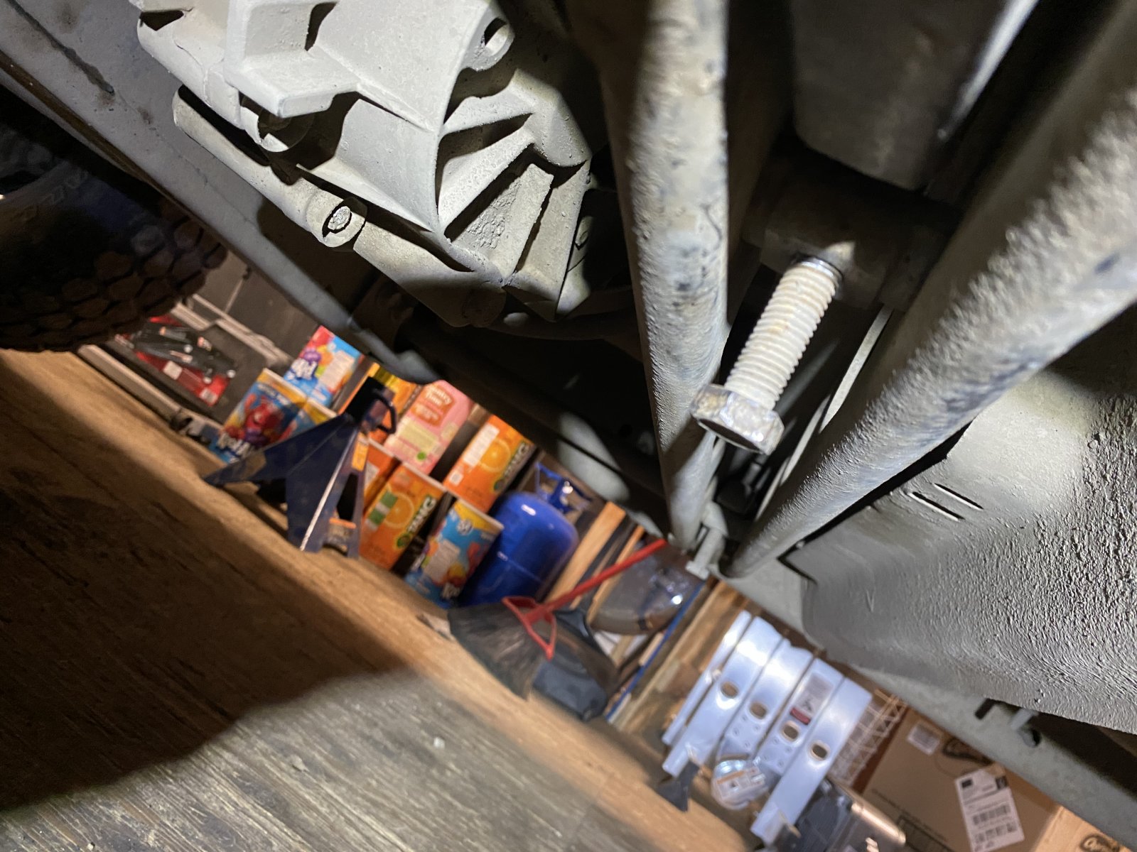

Alright I’ve searched the thread and haven’t been able to compile enough info to answer my questions.
I’ve got my 2005 Yukon in the garage right now. I can’t figure out this damn suspension.
I replaced the entire front end a few months back and a few days ago I got back from work and decided I’d take the Yukon out for a drive.
It rides like crap ….
When I pulled the LCA’s I left the corresponding torsion bar with key in the old LCA. Then I just swapped it over the new LCA and with the correct key and installed from there.
With the Yukon sitting currently on tires it’s throwing the CV angle what seems like way out of whack and I don’t have the key cranked up at all.
However in searching through the forum I saw that someone had said that the bars have one side of them stamped on the end and the stamped end is supposed to face the rear. My stamped end is in my front LCA….. is this my problem? Are they able to be flipped like that ? Is there a possibility the guy before me flipped them to attempt to keep the ride height higher ?

Guys…. I’m an idiot. This has an obvious lift under it so I’m guessing these keys are for a lift. I have a spacer on the bottom of my strut that I realize now isn’t factory. Holy crap…. I’m an idiot hahahaha
Okay so how can I help my cv’s with this lift? I feel I’m probably height maxed out with my cv angles and I would have to do a diff drop to correct it. Am I correct in assuming this.

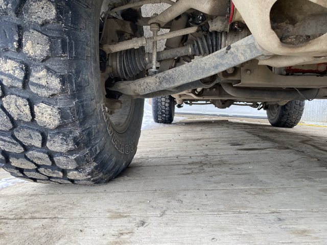

If your second picture is NOT of the vehicle lifted with a jack or supported by jack stands then yes you are at max lift. See how the upper control arm is all but touching the frame piece below it.
More than likely what you have is a leveling kit. A full on lift kit will drop your differential and ease your CV angles. It will probably also bring the front up more. Lowest actual differential lift kits that I am aware of start at 4 inches.

It was not supported in the photos my Jack is just chilling there for a photo op.
Currently aligning the front end, went for an around the block cruise snd it seemed the cv’s settled a little after I backed off the keys last night. Let y’all know how the test drive goes.

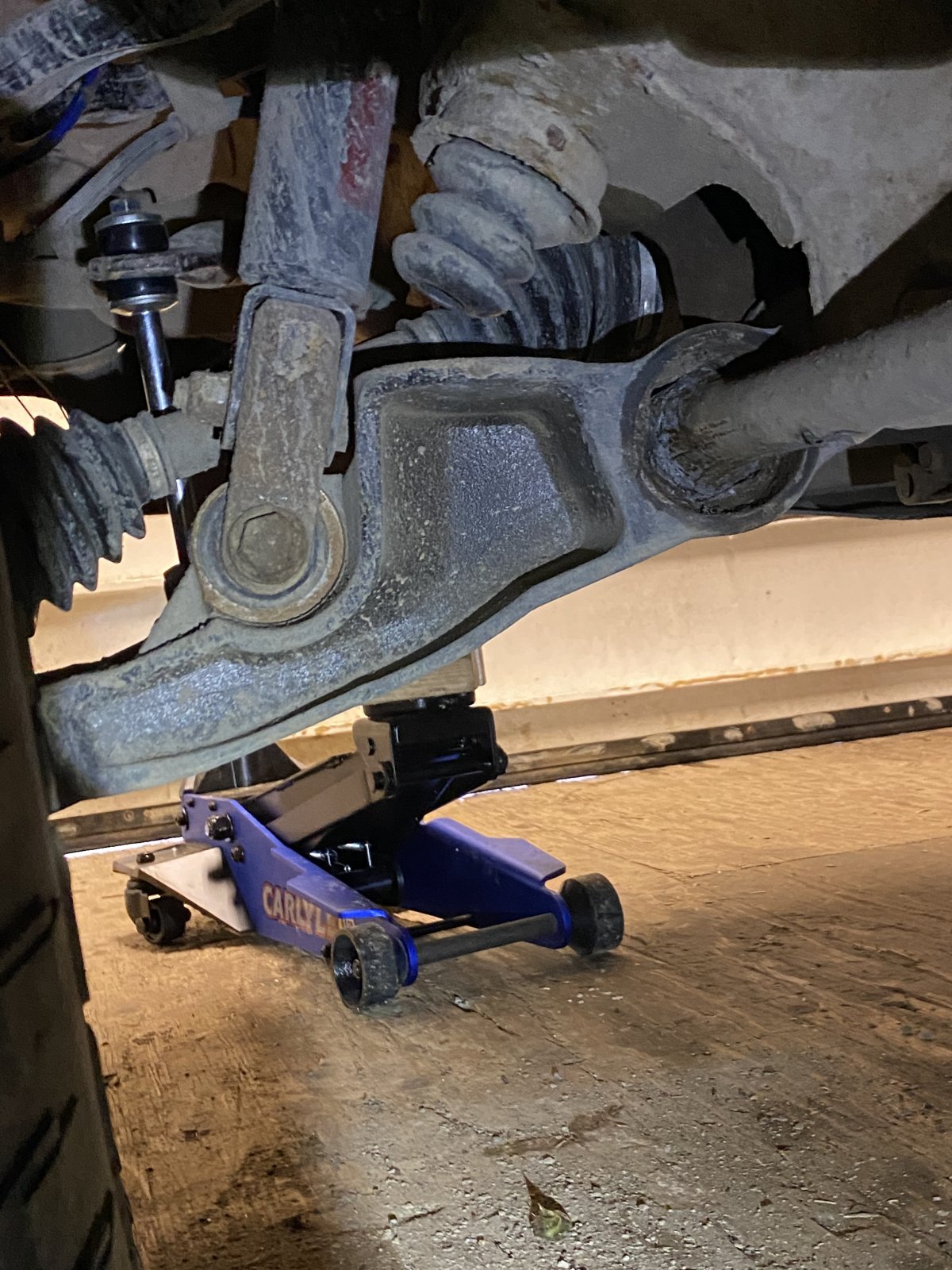

And looking through your pictures again the right torsion bar seems to be installed backwards. On my GM vehicles of the same era the R & L were at the keys.

I’m no expert on the NBS torsion bar suspension, but it sure looks like there is a larger than normal gap between your jounce stop and the lower control arm. It’s my understanding that with torsion bar systems, the bounce stop should be almost touching when the vehicle is at rest.

The front suspension on these is designed for the jounce stop to be contacting the lower control arm; it's a fulcrum point and having a gap will cause issues.

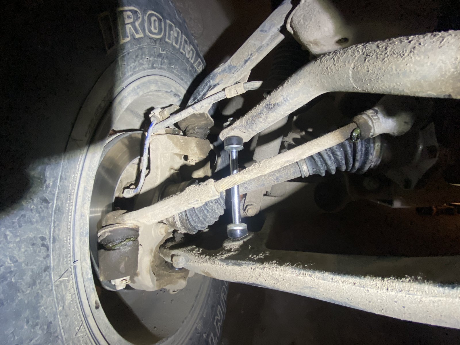

Alright here’s a couple
Pictures of the new cv angles after finally
Getting a decent toe/camber alignment finished last night and cranking the T bar keys bolts basically all the way out this is what my cv axels angles look like and hy basically all the way out I mean my torsion keys are pretty much resting on the blocks.
I’m going to get it back in and flip the torsion bars front to back maybe that’ll give me a little more give in the front end so it’s not so brick like.
