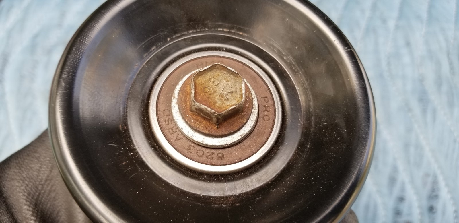

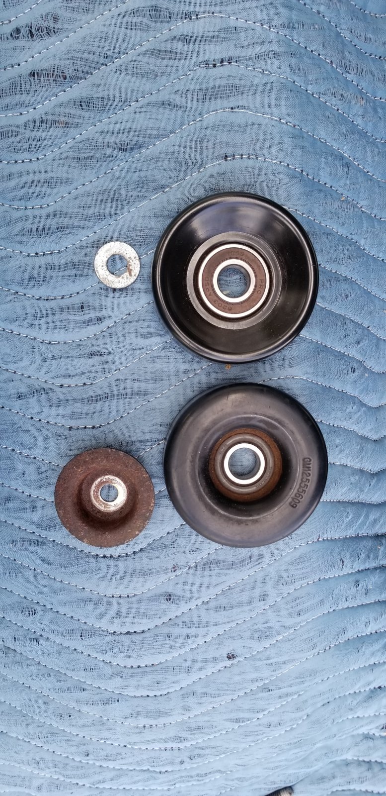

Didn't do everything I wanted to do today. I did do the new belt, and I messed with the new idler pulley.

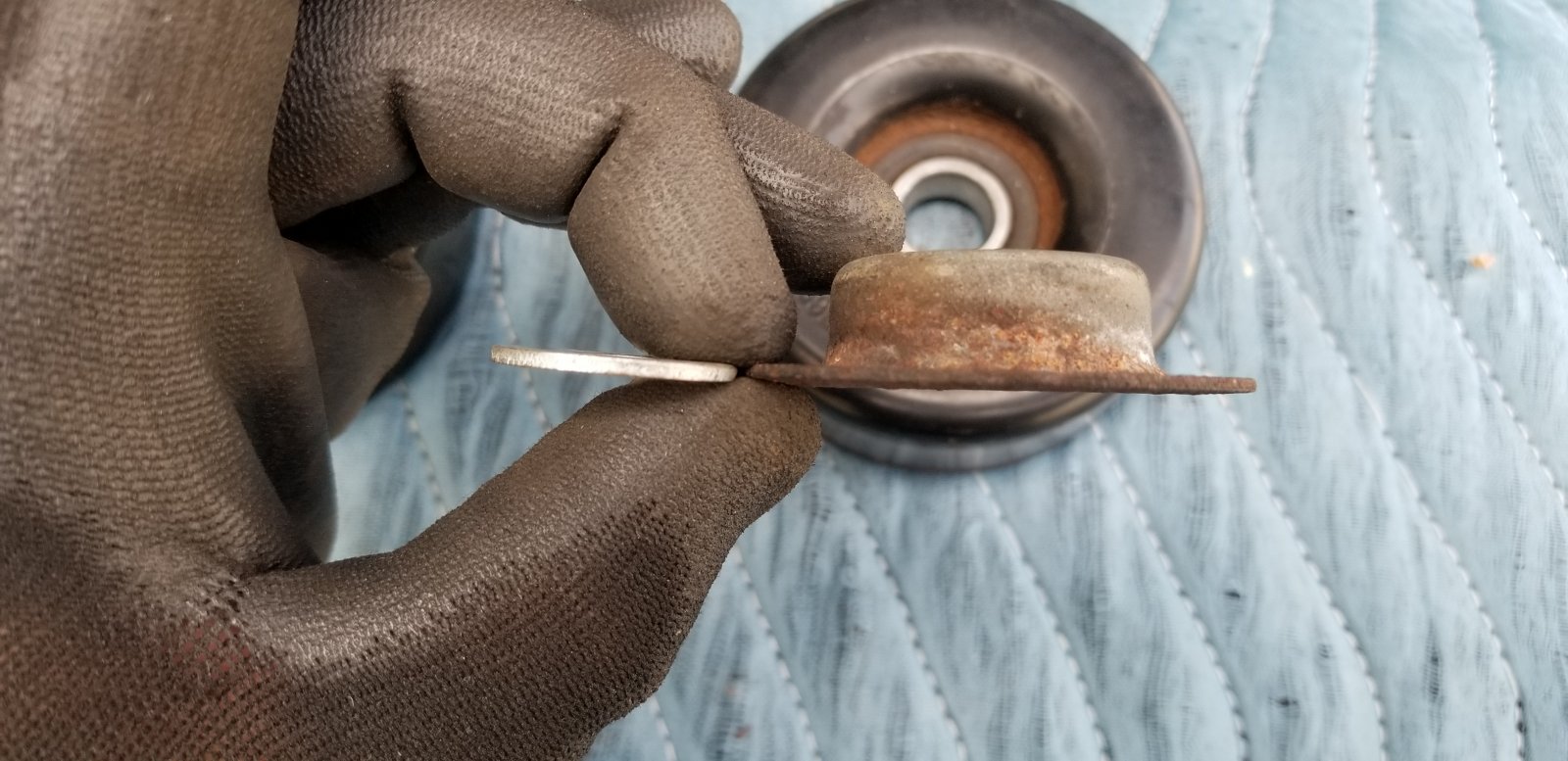

I removed the original concave washer and used a smaller flat washer.
I noticed the idler wasn't spinning with the old washer, thus the smaller, flat washer--spins now. I'm hoping that's the fix.

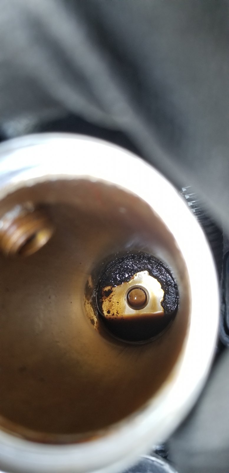

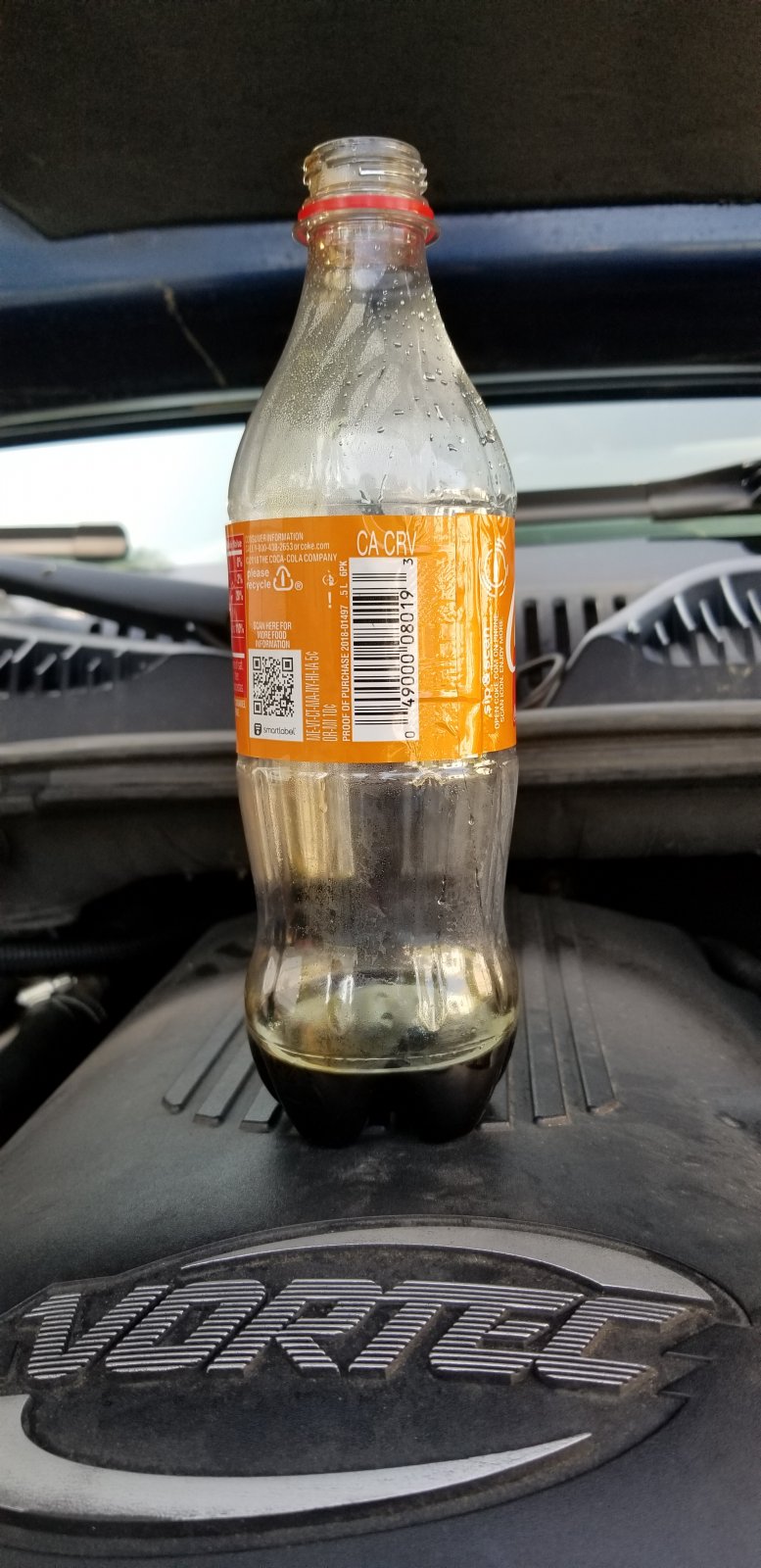

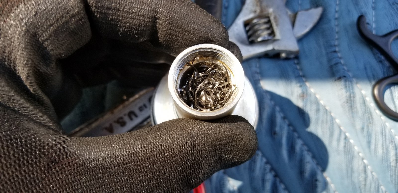

There was some sludge on the bottom of the catch can too.

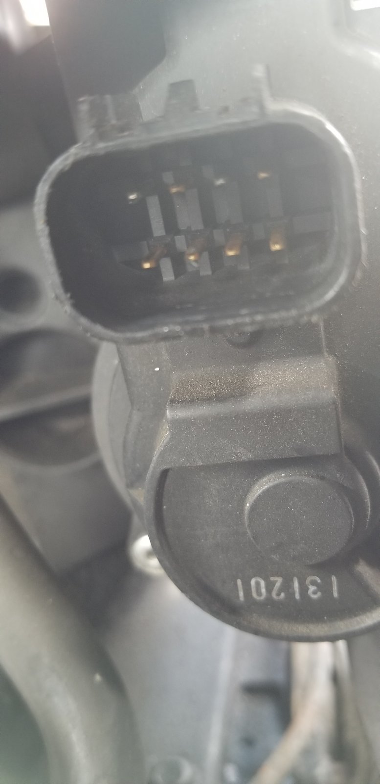

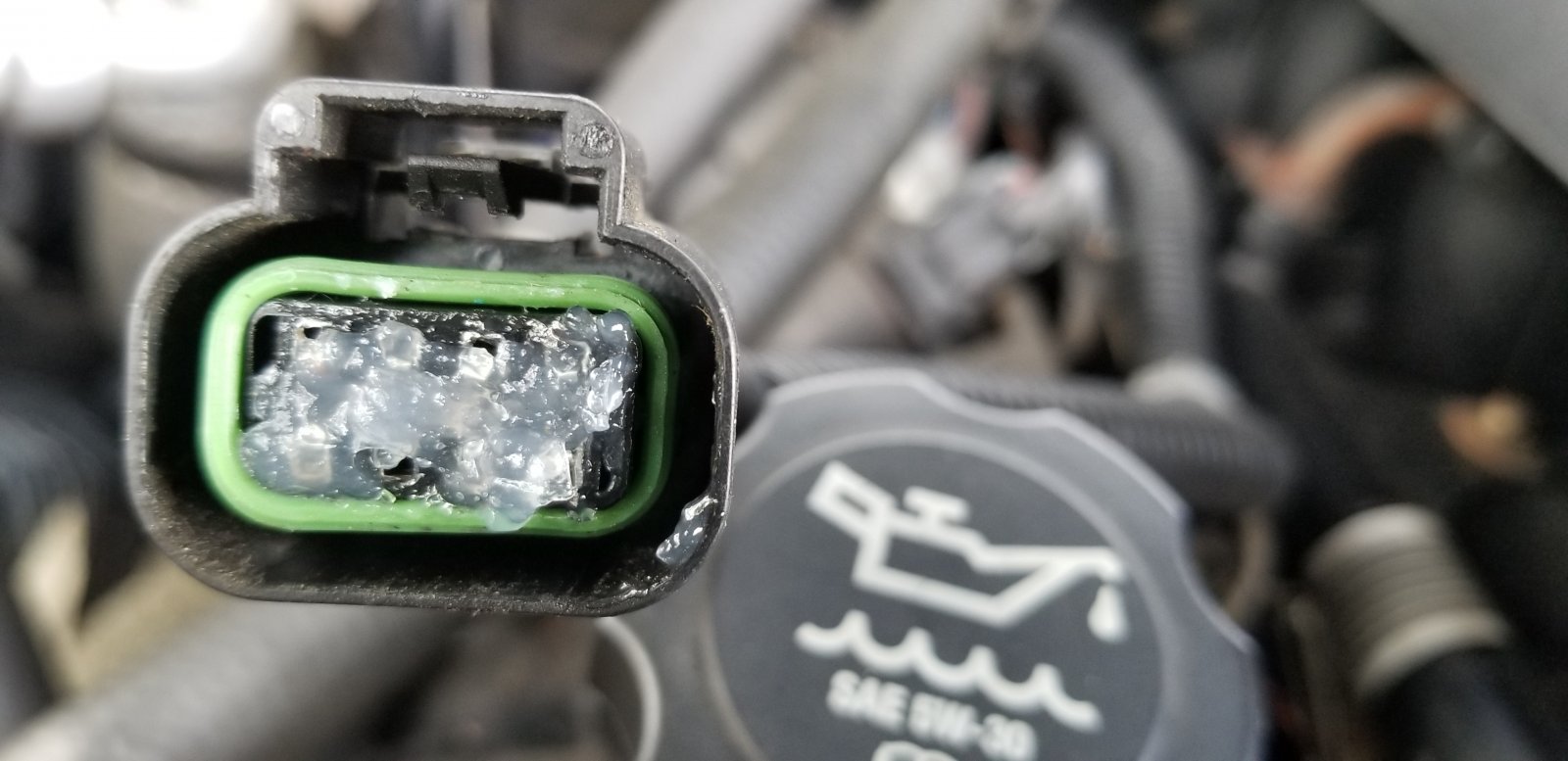

I tried tightening up some of the tabs in the tps pigtail. Also put a nice gob of dialectic grease in there.

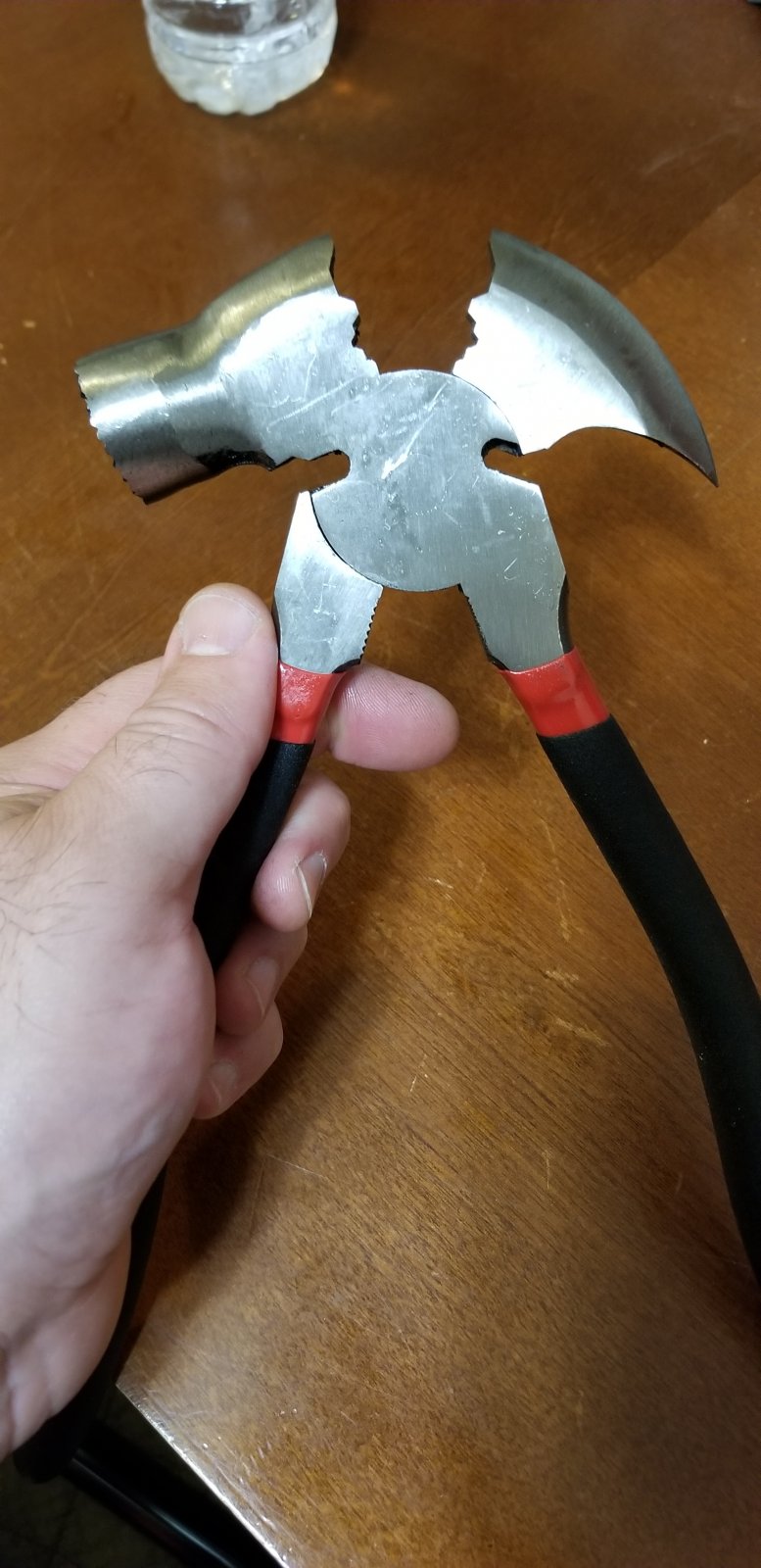

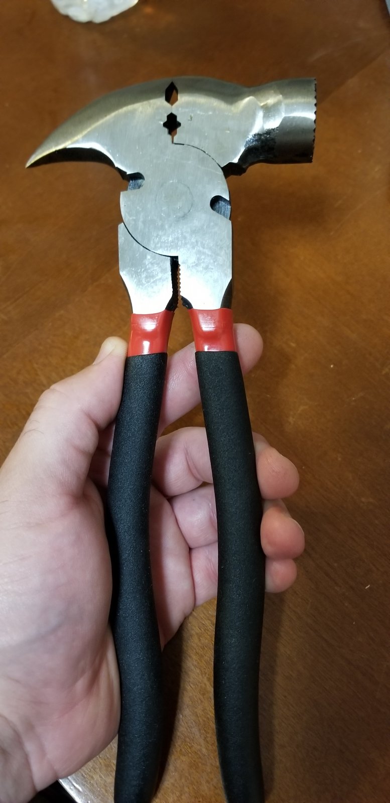

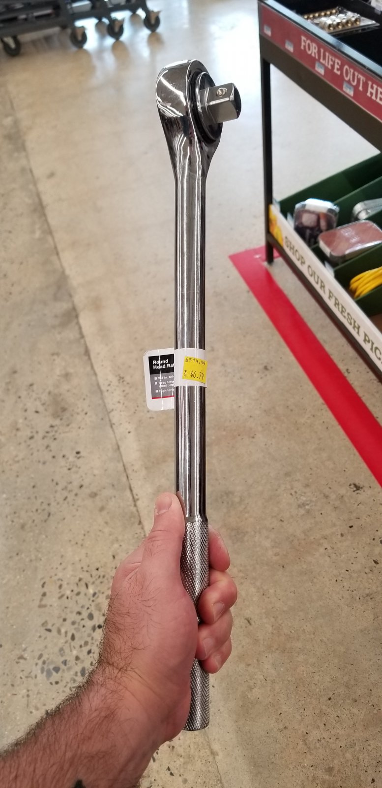

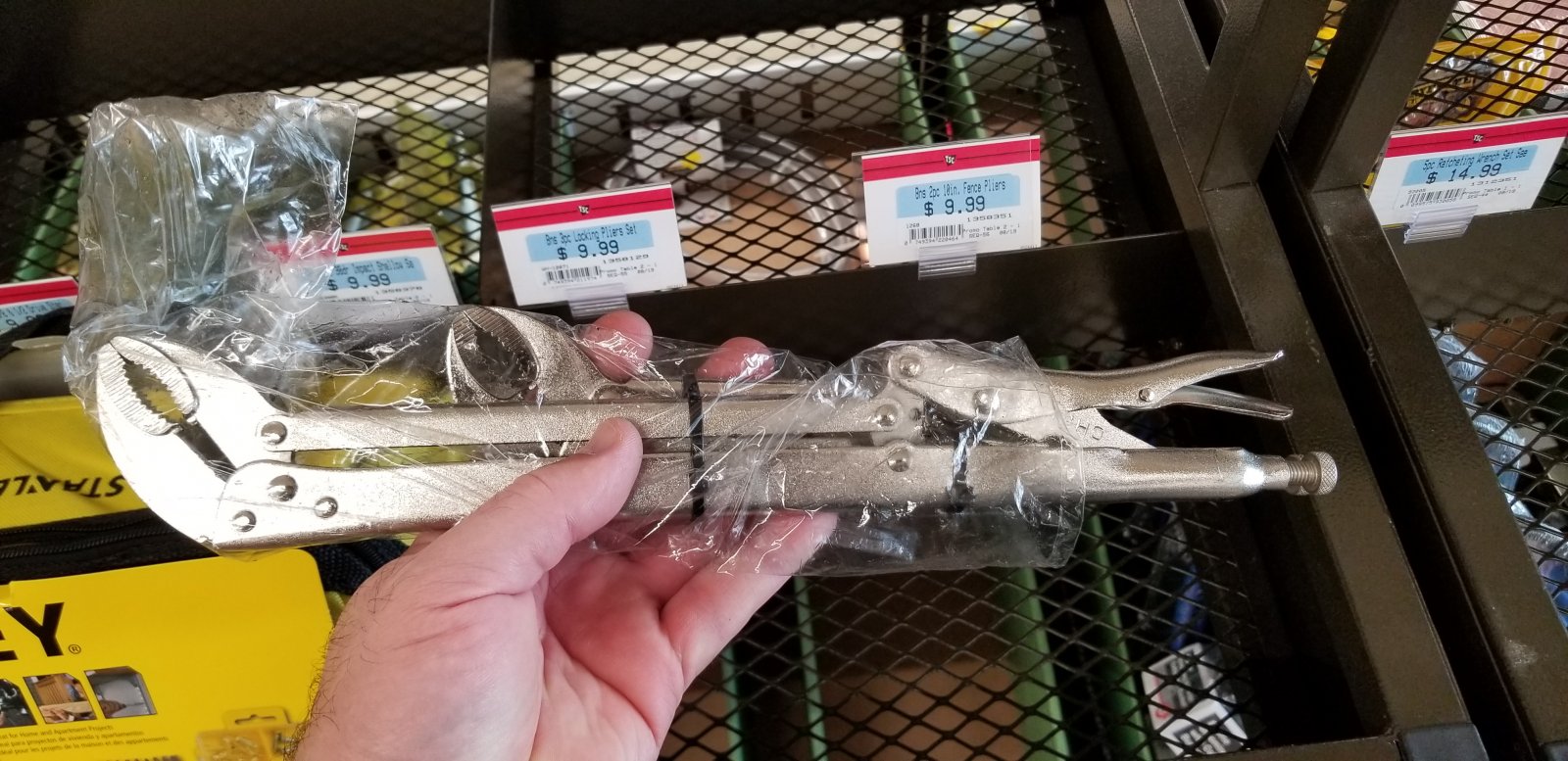

I went to the new Tractor Supply. Saw these--
Picked these up--

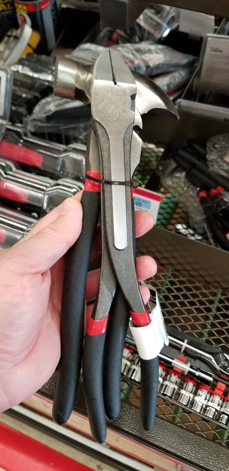

I just needed the long snips, no idea what I could use that other tool for. I think it's some kind of fence snip deal. Anyone know what it is? Gonna try to wind my day down now, gotta wake up 4:30 am. Another long Sunday for me.

Hmmm, wonder why my catch can has the sludge on the bottom of it.View attachment 228916 I wonder what the bottom of my oil pan looks like.
It's just crud in your oil that settled out of suspension. The bottom of your oil pan will have a thicker layer.
Well, maybe not since your motor isn't original. I'm sure the pan would've been cleaned if they took it off.
Pan is my old one from 4.8. The 6.0 original was cracked. Motor probably fell when it was yanked.

Didn't do everything I wanted to do today. I did do the new belt, and I messed with the new idler pulley.View attachment 228867View attachment 228871 I removed the original concave washer and used a smaller flat washer.View attachment 228868 View attachment 228869
Spins good now. View attachment 228870
Wait a minute- you put that pulley on and didn’t check if it spun freely? Or it spun when you originally installed it but at some point it quit? How seized was it? Where’s the video of it NOT spinning freely?
33,215
51,478

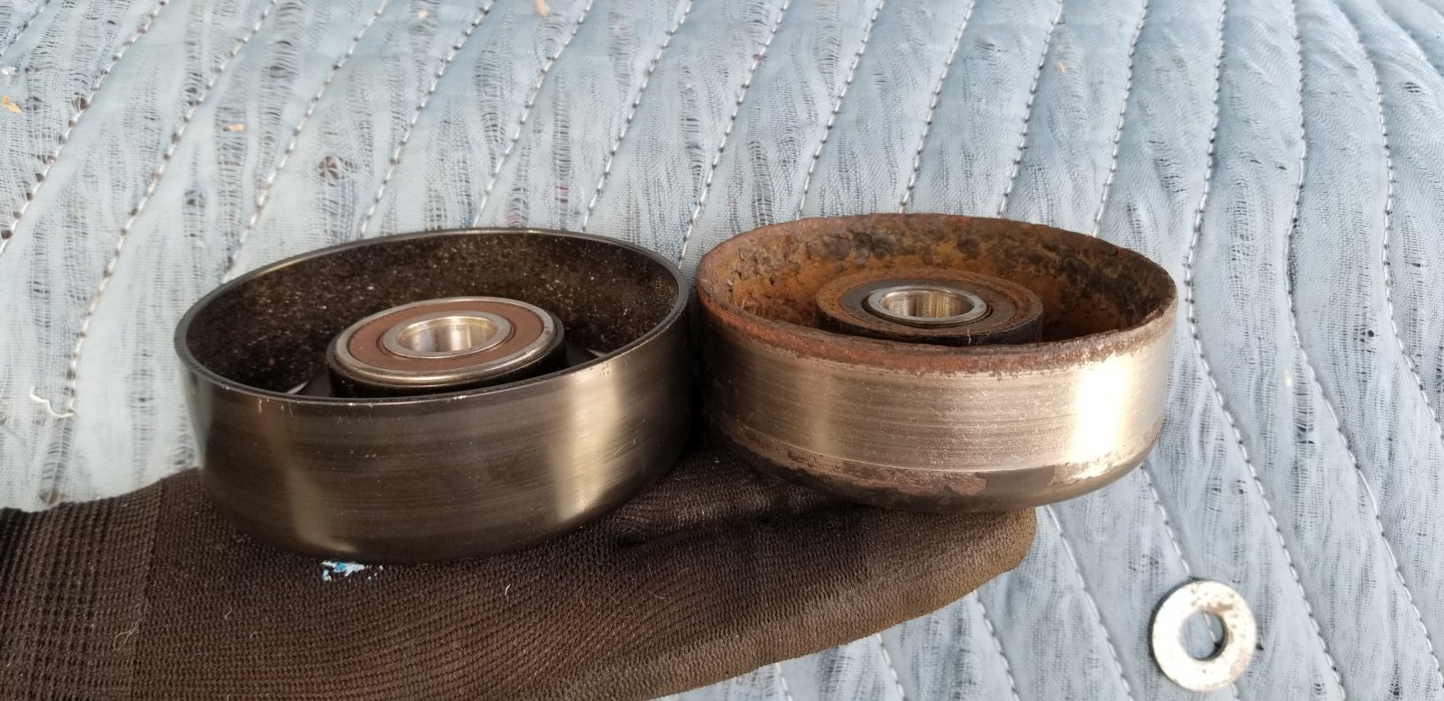

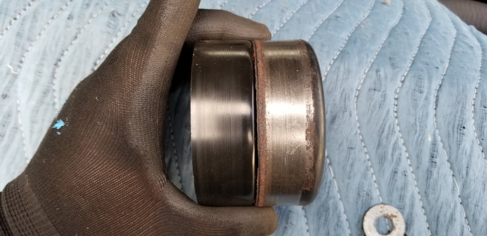

Yup, took it for granted that I'd be gtg--yeah, I know. It did spin, but not as it should've. Pretty positive it was because of the original concave washer I reused--
On the right. This was it after I fixed it the 1st time. You can barely see it, but it's spinning.
I checked the idler today and the outside wasn't burned or marred, so it was spinning, but just not as freely as it should've.
New one on the left.
