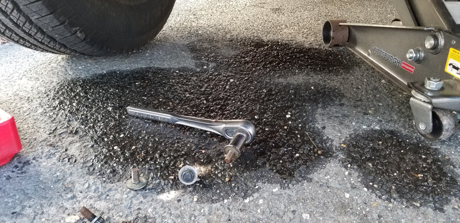

I went to go put on my 22's and saw this--minus the ratchet.

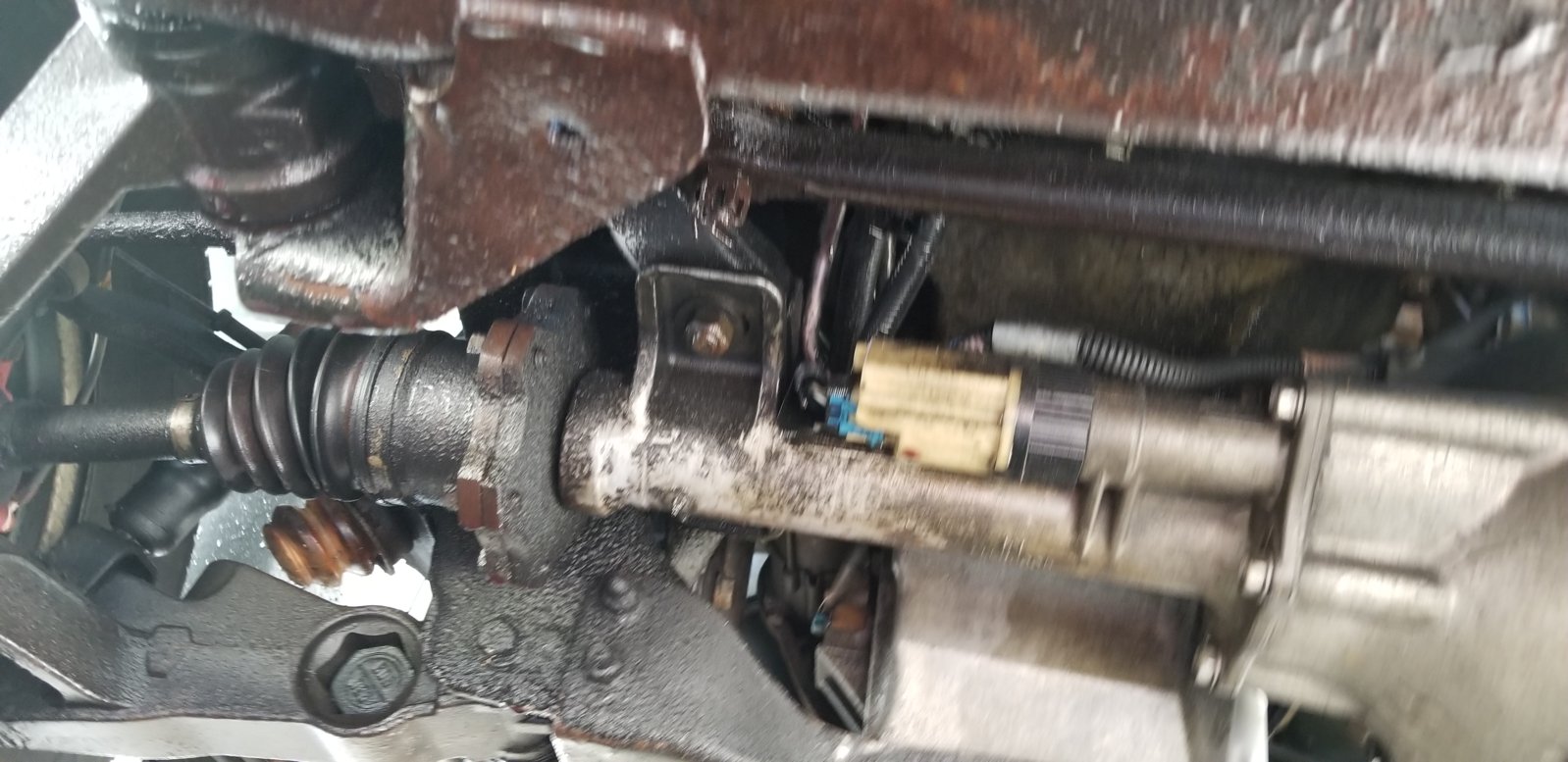

Puddle of trans fluid. I took the front splash shield off.
20180616_171725-jpg.201628

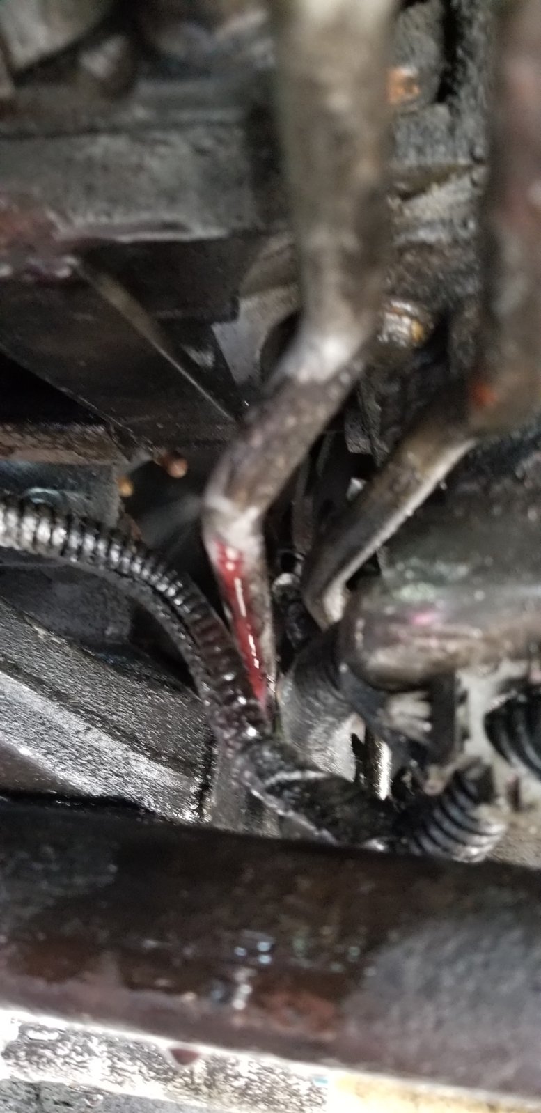

Side view.
20180616_172105-jpg.201629
When the trans guy put the trans cooler line in for me, I guess he didn't route it the correct way using the factory hold down clips, so every time we'd turn the wheel left, the idler arm(I think that's it) would rub on the metal line, eventually rubbing right through it. I'm so happy I noticed it today and not on the road. I bought some fuel pressure line with some fuel line clamps. I then cut the cooler line(hardline)and fed the rubber fuel line in place. I used 1 foot of line, so hopefullythat's plenty. Then I must've used 20 zip ties, because that ***** was stillrubbing everywhere! I think I finally got it to where nothing is rubbing--I HOPE! I don't have pics of the finished job as it was getting dark and mosquitoes love spanish meat. Wish me luck guys.

@Tonyrodz , I had the same thing happen on my '04. When I had the transfer case rebuilt last year they replaced the two hard tranny lines that go up front, but like yours they didn't clip them out of the way. So the top of the idler arm scraped them on a hard left turn. I was under there checking some things a few weeks ago and noticed the scraped lines so I moved them up out of the way and strapped them up. I'm going to keep my eye on them to make sure they don't start leaking.
Be careful with fuel line and transmission fluid -- I've heard that tranny fluid will eat through that stuff pretty quickly. They do make actual tranny fluid hose.

Sounds like you caught that just in time. @Fless , I really hope you're wrong about tranny fluid and fuel line.I def don't want to do that twice. With my luck when it happens I'll be far from home.

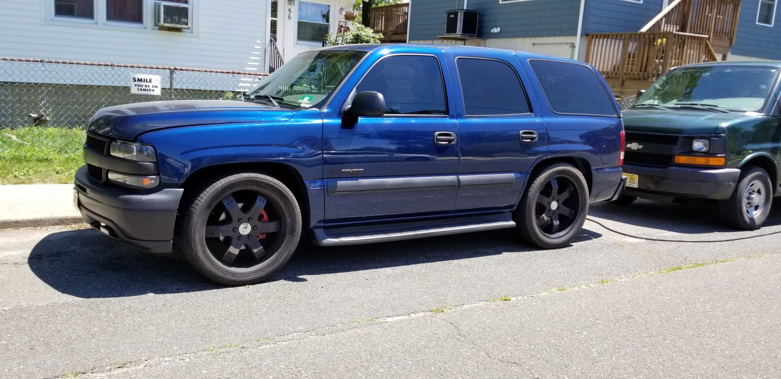

Swapped to the 22's today. Gotta get used to them again.

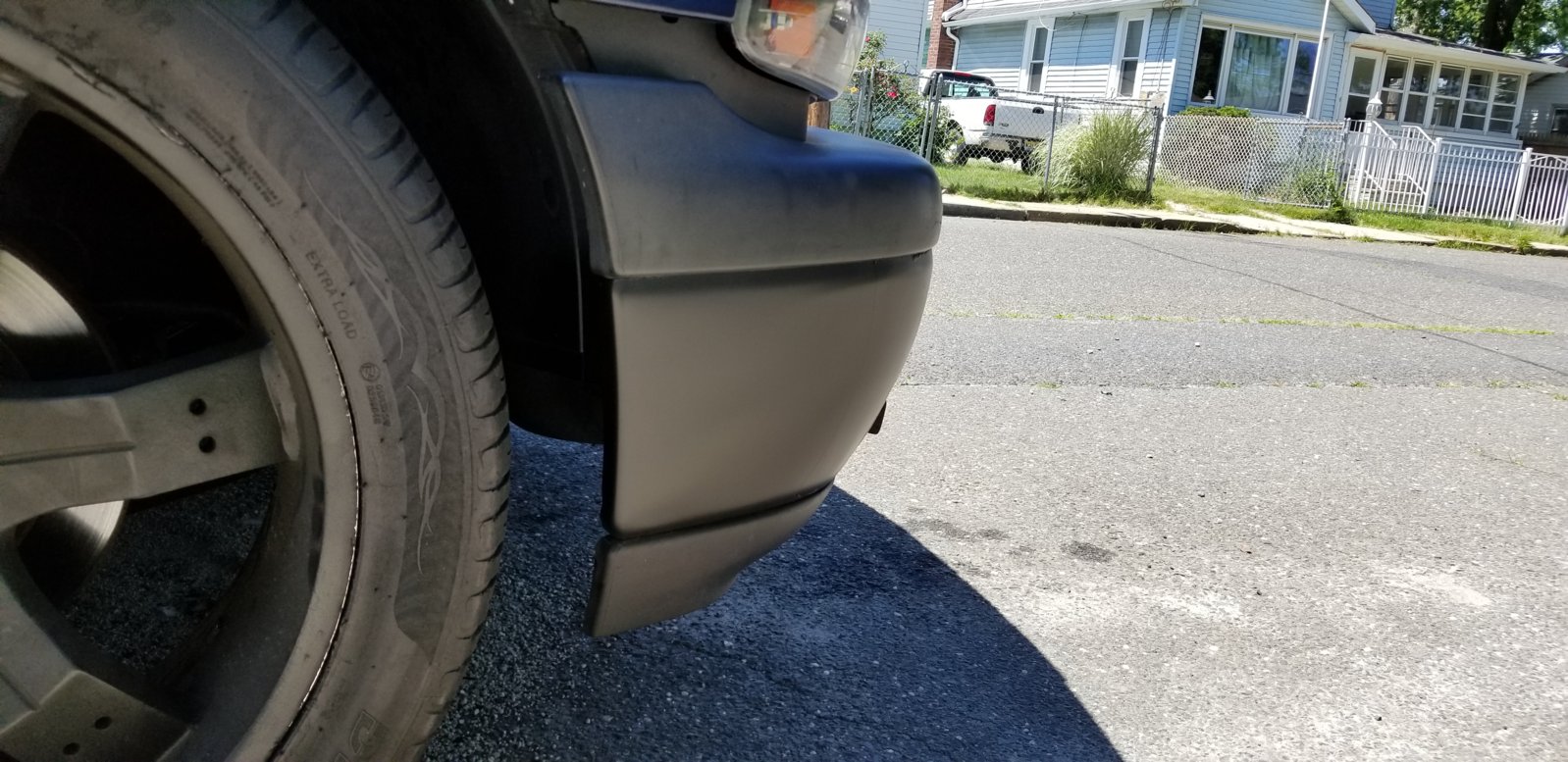

I also fixed the dip on the bumper from the trans fluid mishap.

Nah, when I had the trans guy puy the trans line in, he didn't route it correctly, so it was rubbing on the idler arm every time we made a turn. Slowly rubbed a hole in the hard line. I tried fixing it on Saturday using some fuel line and fuel line clamps. EPIC FAIL! This Hoe is really starting to piss me off. Gf got it flat bedded to the house, and tomorrow it gets towed to my friend the mechanic. Getting another line I guess. I still owe the 1st idiot for doing it! AWESOME!
