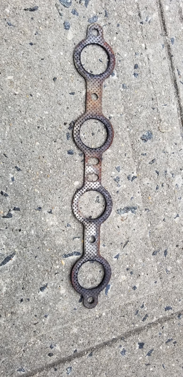

Epic fail today and I'm super pissed. The old gasket didn't seem like it was blown out. Didn't see anything unusual.

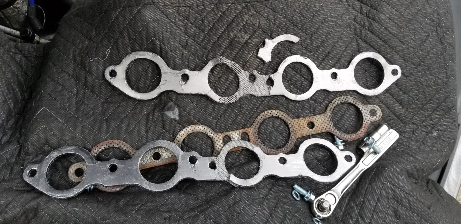

Here's the "new" gaskets after I tried moving them around once they were in place. The 2 center holes wouldn't line up for anything, so I was moving them around.
What a waste of time and money. I had to put the old gasket back in and it leaks even louder.

They only go on one way so you must have had then turned around wrong. Those old gaskets were leaking almost everywhere it looks to me. Why didn't you just go to the auto parts store and get a new set instead of putting the old ones back on? Once they're crushed once that's it. They're not reusable. Sorry for that bad news. Man that sucks. At least you have practice now.

Also I hate to say it but this is a problem with cheap headers, trying to get them to seal. If a new set doesn't fix it I've heard of using 2 sets to make up for the irregularities in the flanges. That's why I was steering you to the Remtex but they're fragile like you found out. Sorry you're having problems but you'll get it eventually.

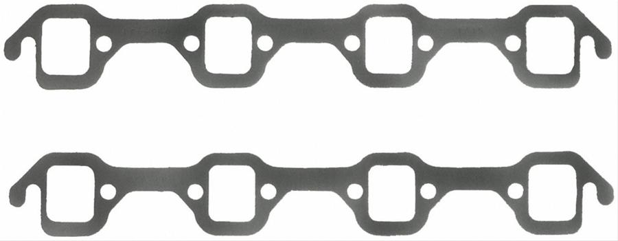

Also, next time you go to install new exhaust gaskets, cut the bottoms of the outermost bolt holes so they're hooks, like in this pic:
You remove all but the outer bolts and have them backed almost all the way out so that they hold the headers in location, then slip the new gasket into place between the flange and head with the "hooks" resting on the two bolts. Put the other bolts in place and tighten them all up evenly in the specified torque sequence.

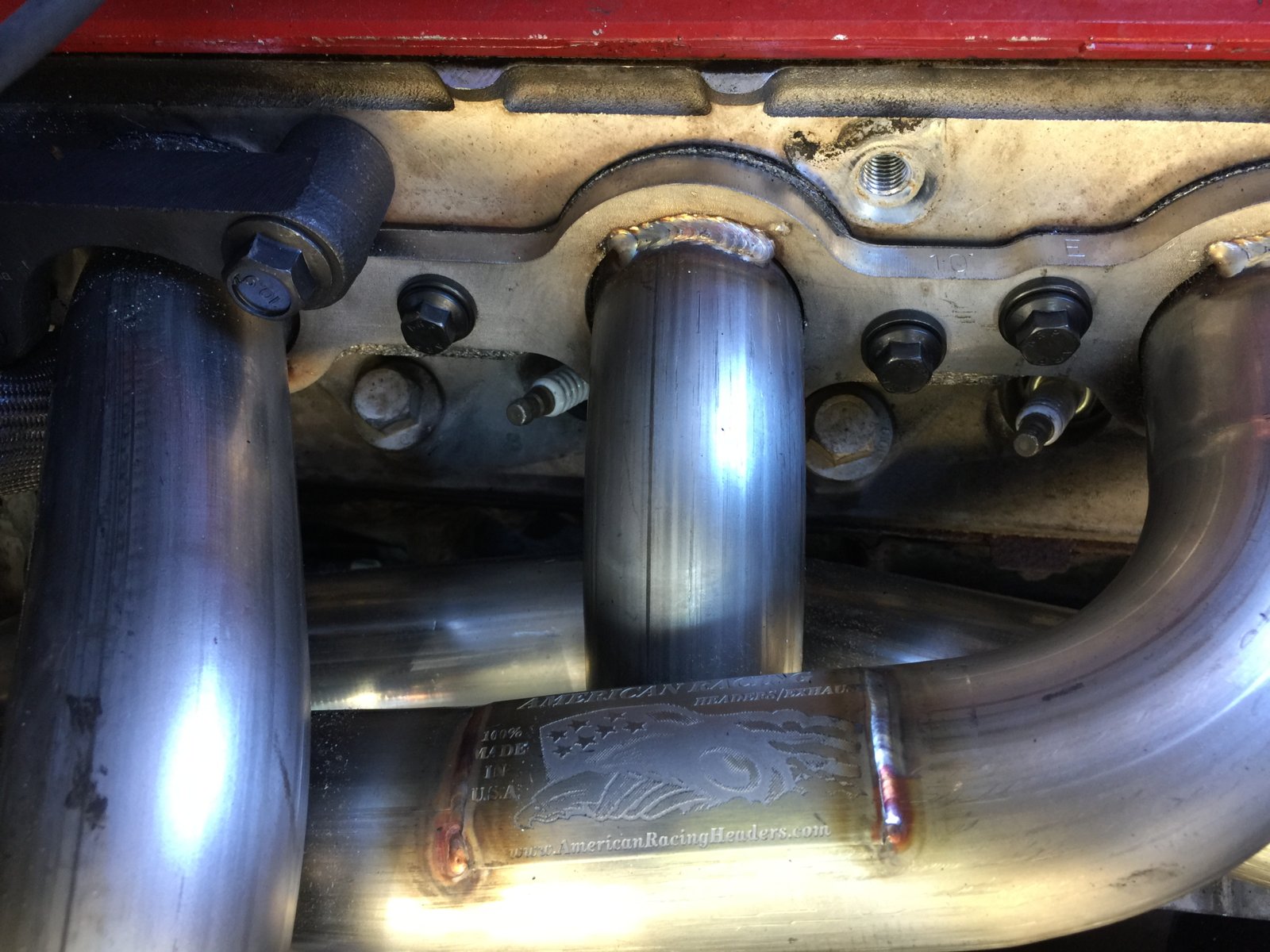

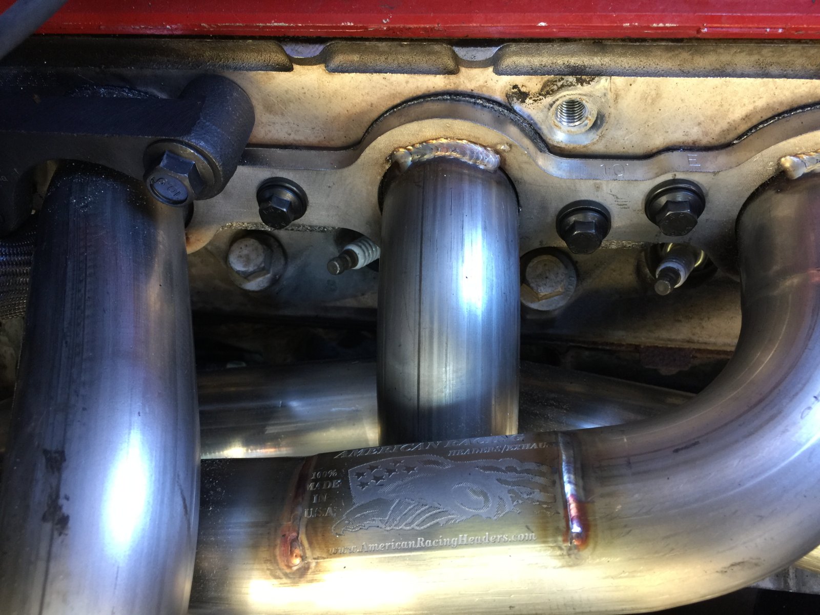

If you notice, the Remtek's center holes aren't elongated like your others so the new ones might not be either. Our motors have offset bolts in the center so you need to pay attention which way the gaskets need to be turned in order to line up the holes in the gaskets. Here's a pic of mine but I'm not sure which side this is, I think it's passenger. The right bolt is higher than the left.
52,956
Duh that is the passenger side.
