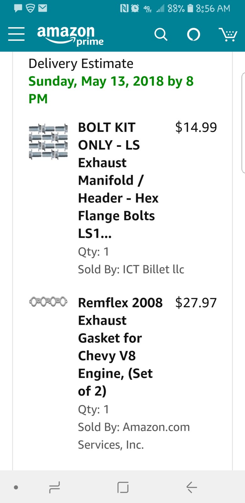

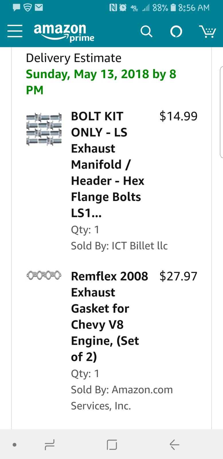

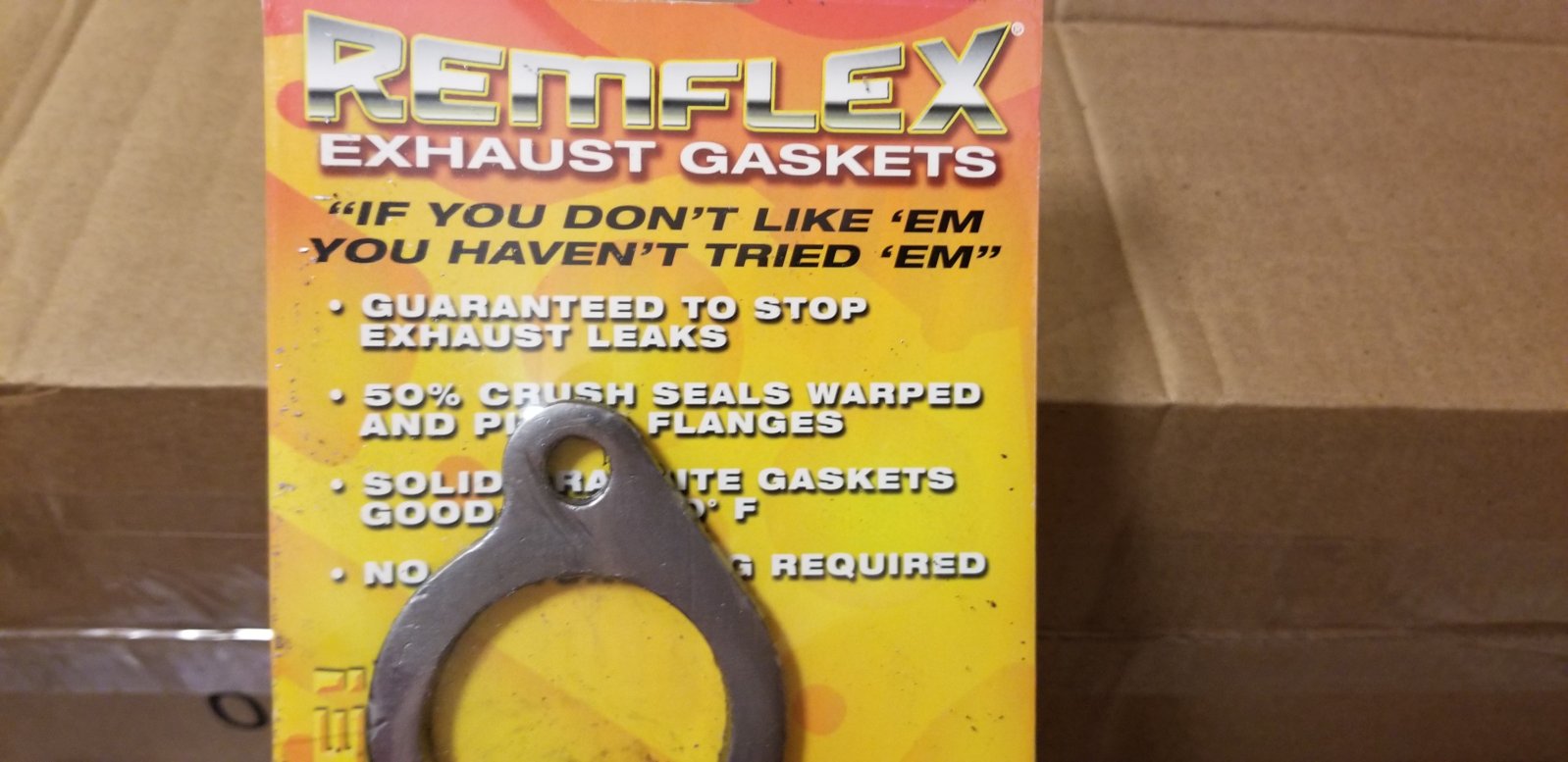

Just ordered this.

That's what I'm thinking. That smoke coming from the lower header area after sitting, convinced me. I hope I'm right.
You'll be able to tell when you look at the old gaskets. I had a leak with mine and thought I had lifter tick.

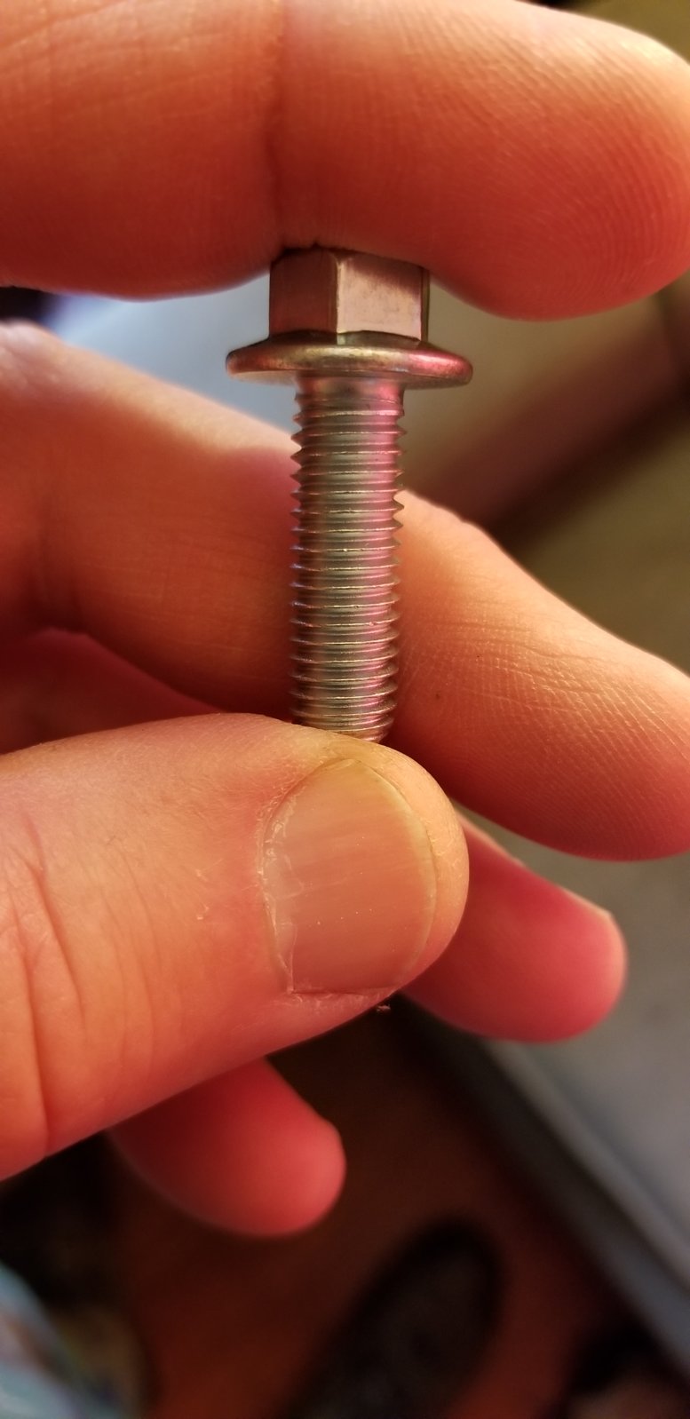

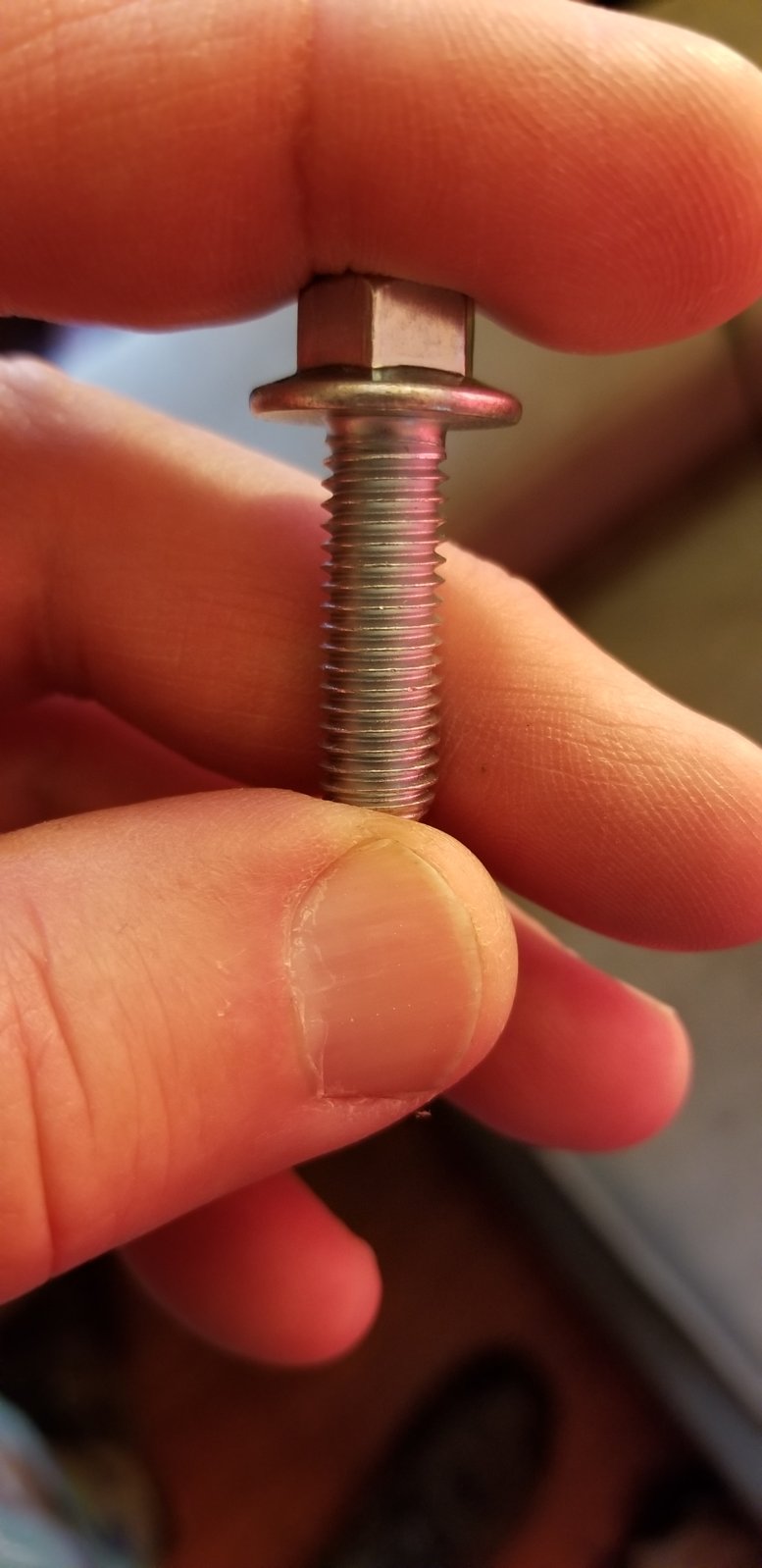

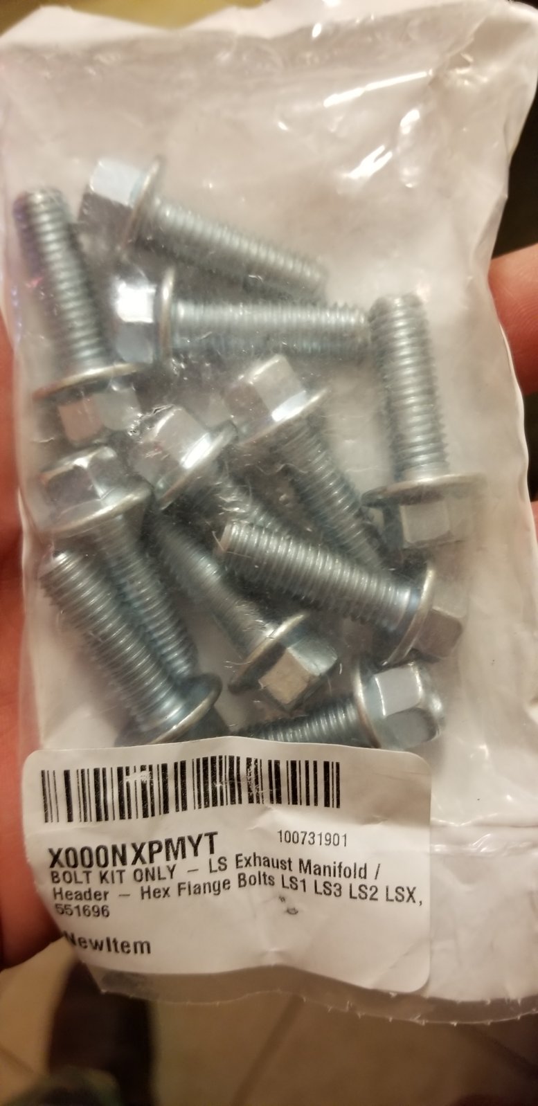

In your opinion, what's a good header bolt to get? I had stainless steel on there, now I bought stainless that are zinc coated. Grade 10.9 M8's. Think I need to put lock washers on there? With the heating and cooling off they back out.

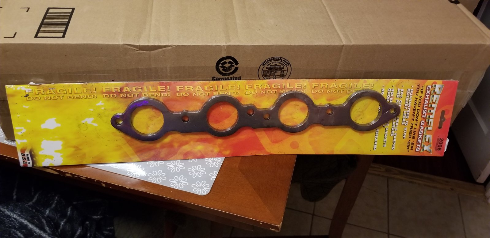

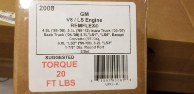

ARP 134-1102. They come with lock washers. I wouldn't use anything else after messing with broken bolts. And the Remflex has specific torque specs that need to be followed in order to compress them right. I just checked my bolts last month when I replaced plugs and they're still torqued right.

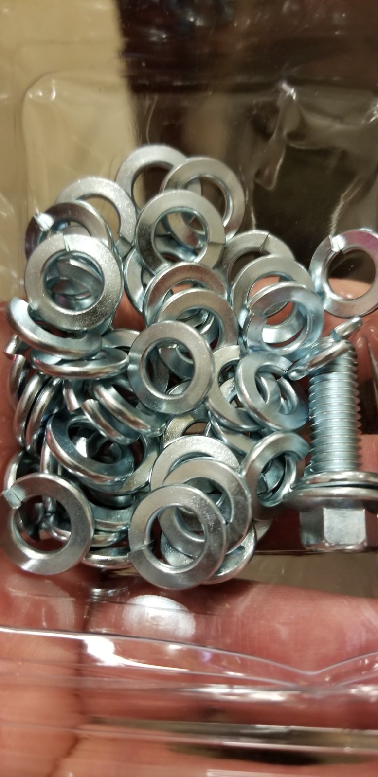

Got my header bolts.
Can't do anything this weekend tho, rain on/off, and no garage. I also picked up some lock washers.

Those will work. If you hadn't already ordered them I would suggest the ARP's but since you have those, its good. They look the same except ARP are black and I'm not sure what they're made of, it's a secret.
The ones that are in there now are fine, got them with my headers, just wanted to go new. Think I should go with some type of Loctite?

Got em.
I gotta get used to Sunday delivery.

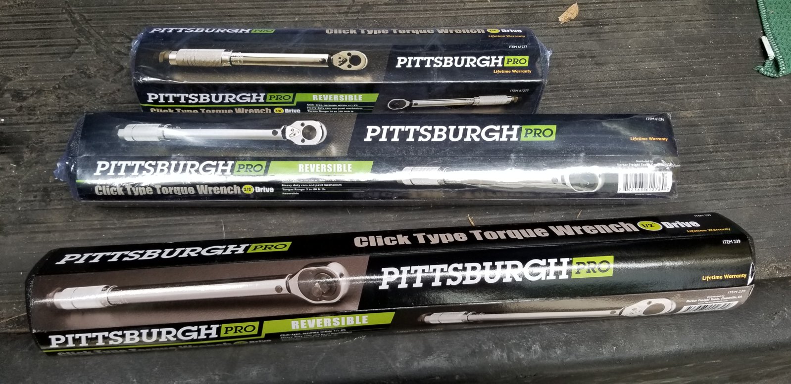

Suggested. I don't have a tq wrench tho.
