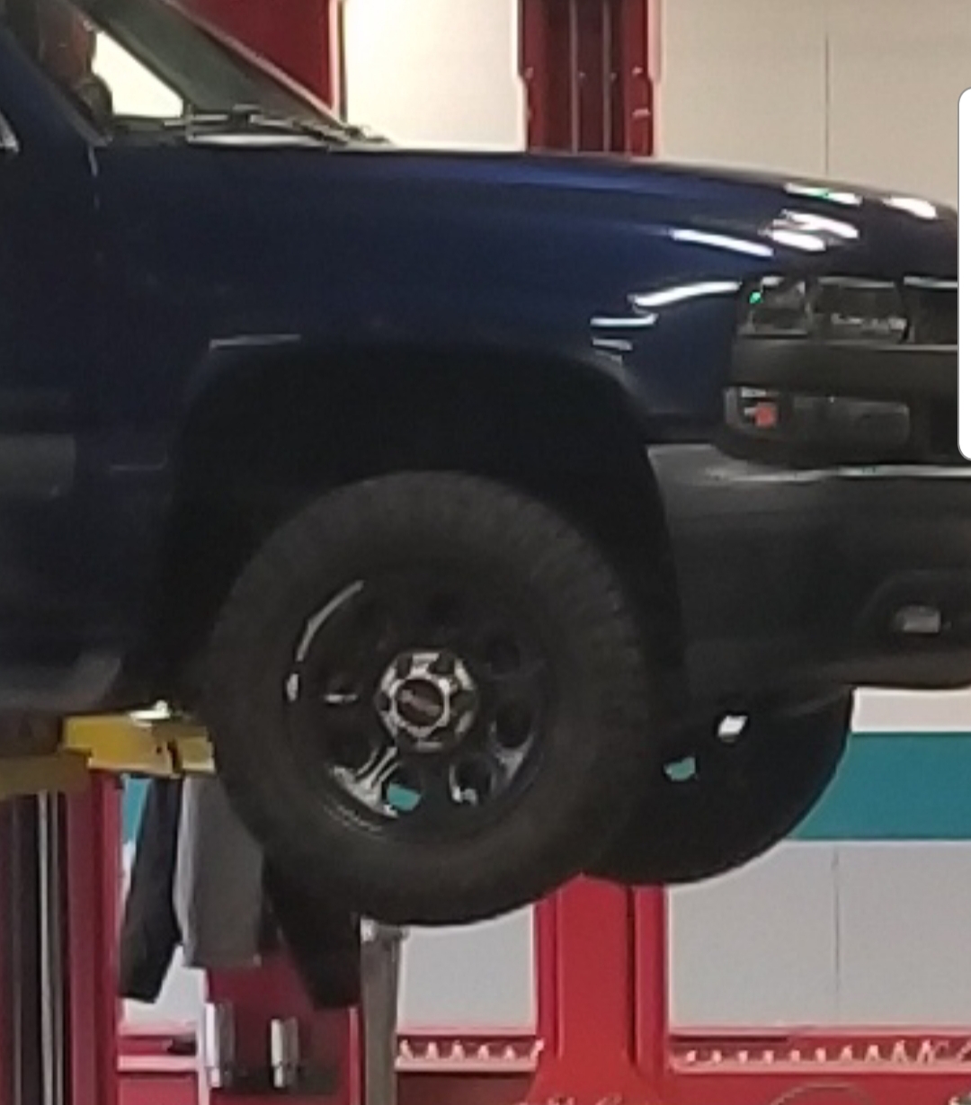

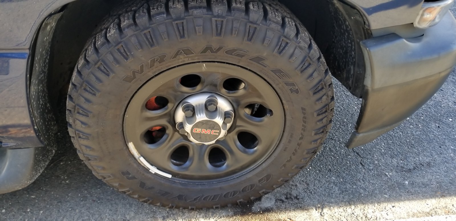

I'm finally done---They didn't give me a print out of the redone alignment, which makes me think they're hiding something. They said the alignment was as best they can get it, he said there's play in my steering box--but it drives and tracks much better. They also removed all that weight from the front tire.View attachment 265056
The brake pedal is 100% better, but the abs pump still kicks in when you're almost fully stopped. I'm not getting any abs codes either. Truck has set for at least a year, and I know the nbs have issues with them--so I'm not totally sure if anyone messed it up, could just be it was time for the pump...? Maybe.....Idk. I'm just glad I'm outta there--4 hrs later.

Guessing that pic was pre-weight / balance correction?

If you look close some of what looks like weight is unpainted wheel. That said I noticed that they used the wrong style weight. They used a weight for an alloy wheel. Steel wheel weights have a different shape clip. I would be concerned about the weights flying off.

So they removed all the weight to add one big weight? :think:

Pic was after it was rebalanced.
Before
I think there was like 2 of those on there before.
