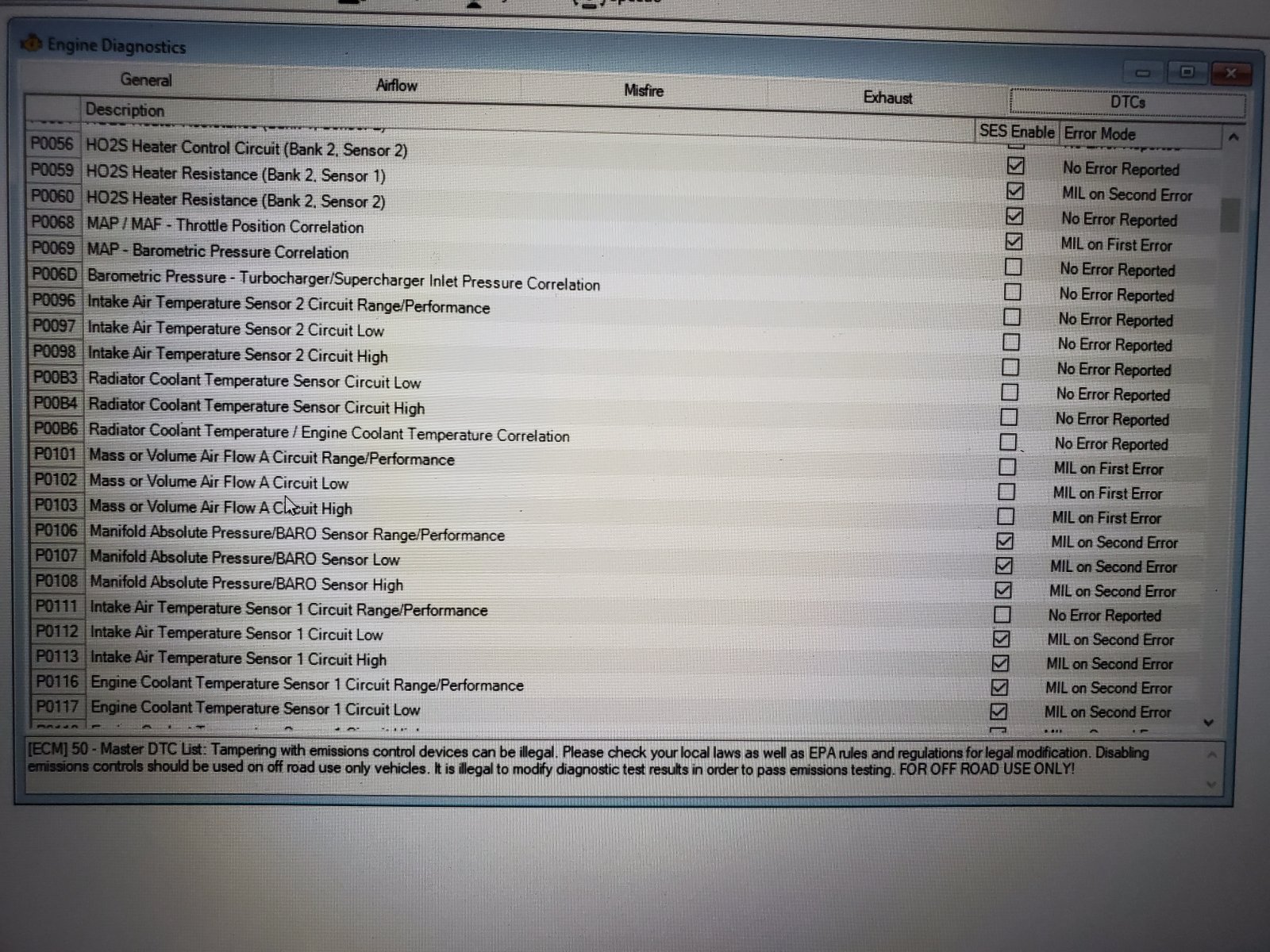

It's a P0103. I've swapped it with a known good oem maf and it didn't get rid of the code. The plug is good also. It doesn't set the cel but it never goes away, even when I swapped to the other maf. I was told by someone it was the tuner's **** up. I was gonna have the maf tuned out, but I haven't done it yet.
it could be disabled and the CEL can be manipulated to not turn on. the error is there but it just wont illuminate the light
not really disabled, but faulted out due to one or more of the checks it does to make sure its working

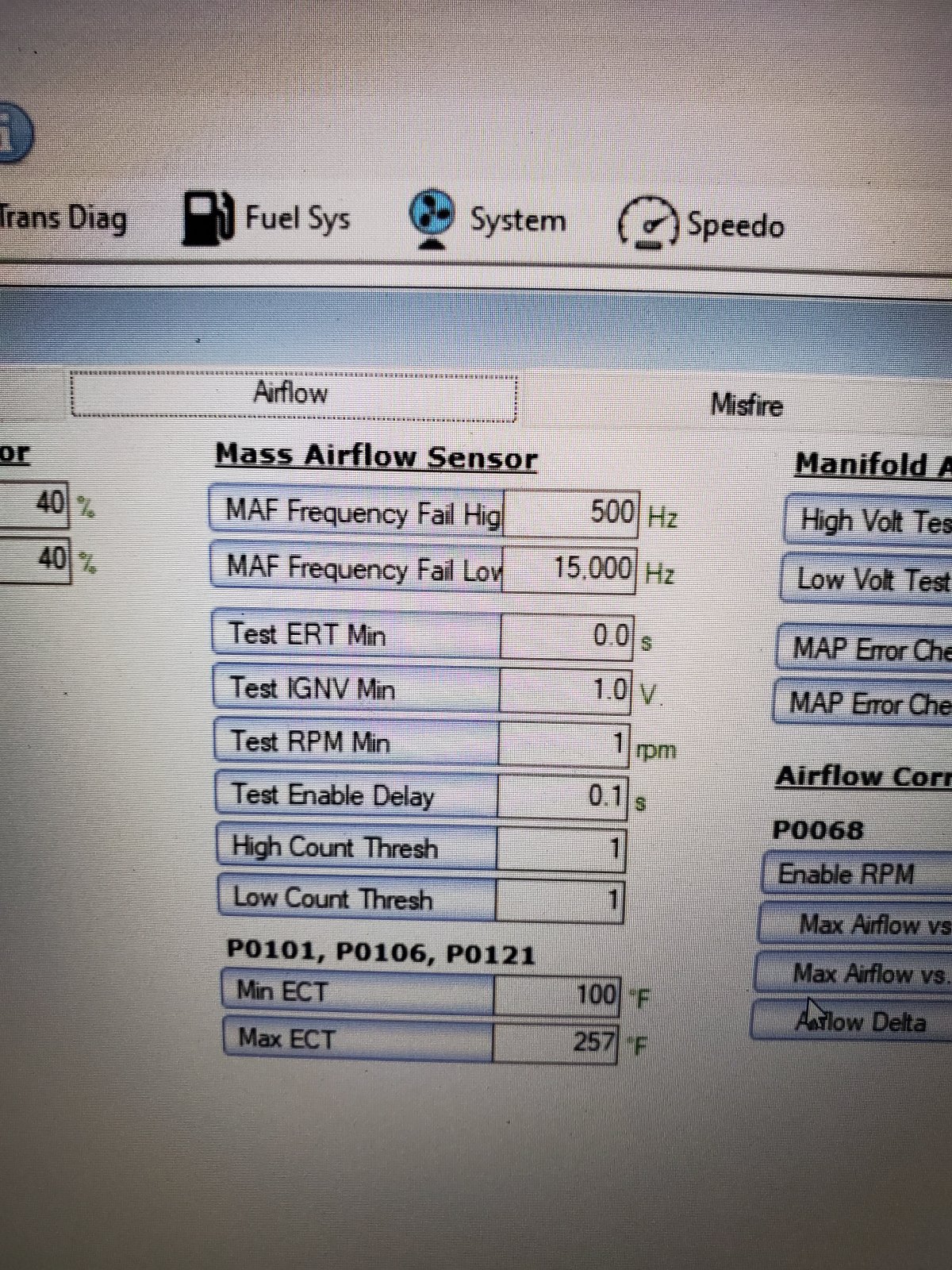

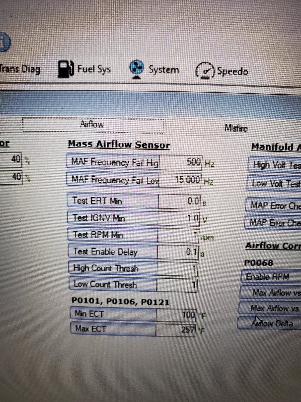

its all speculation until someone can actually look at the tune.
but its as simple as just setting a self check to error outside of normal range
ie stock may say
maf fail above 10000hz
maf fail below 500hz
if you tell it to error above 100hz and below 10000hz its going to immediately fail, and you can uncheck the SES code for it
Mine (gen 4) would still read the maf but I physically removed the wire from the harness to fail it
33,341
51,829
ie stock may say
View attachment 264321 View attachment 264322
How can you do that?
