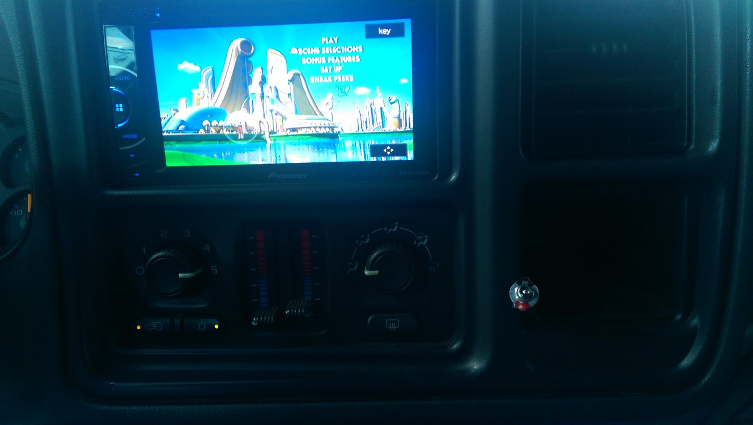

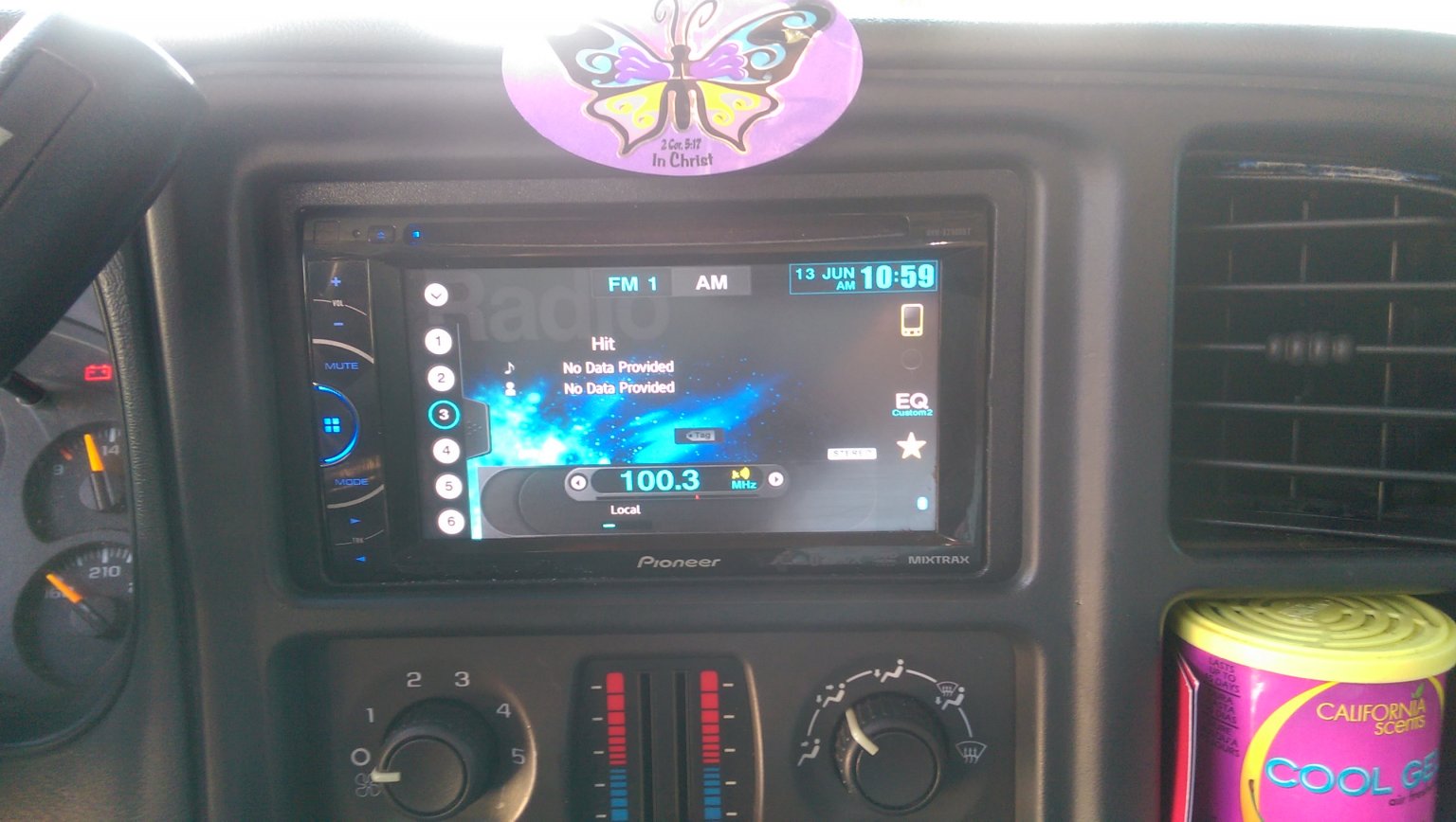

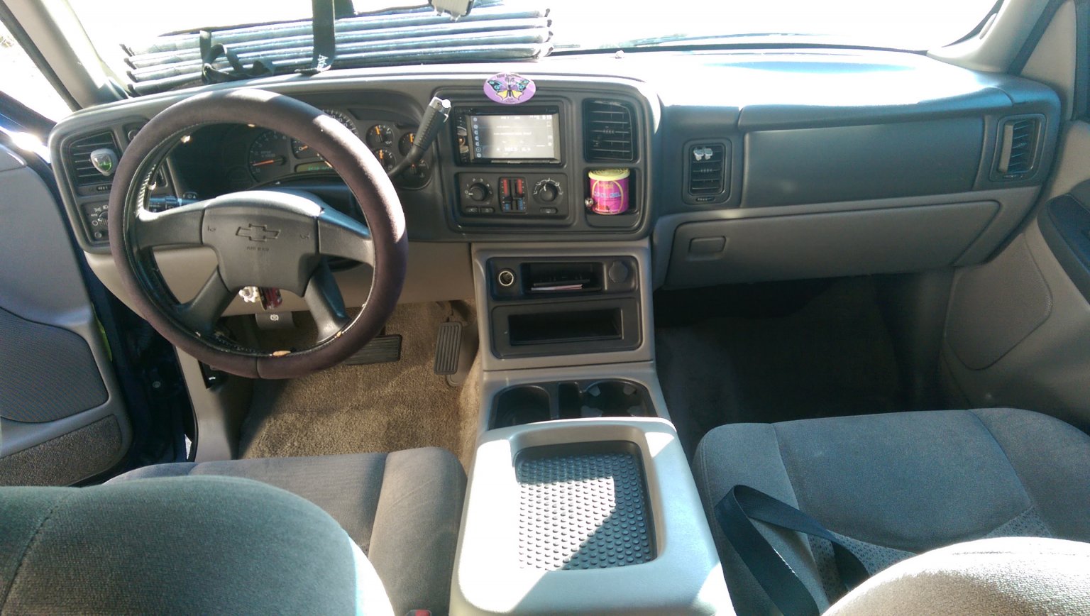

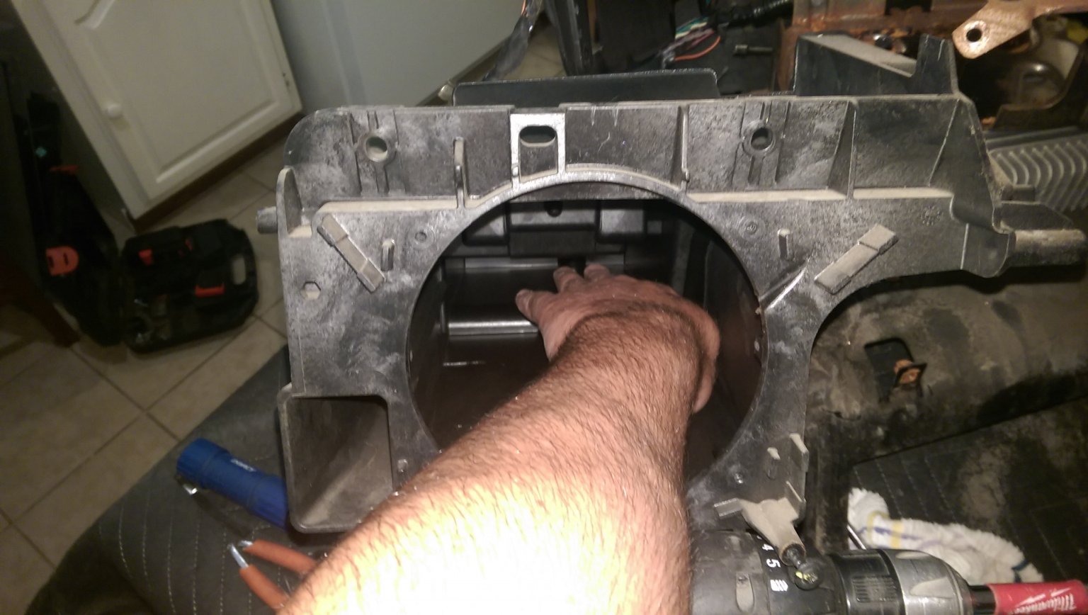

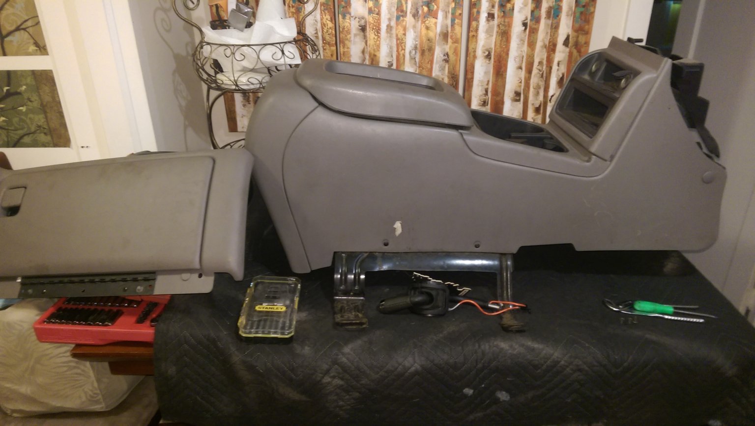

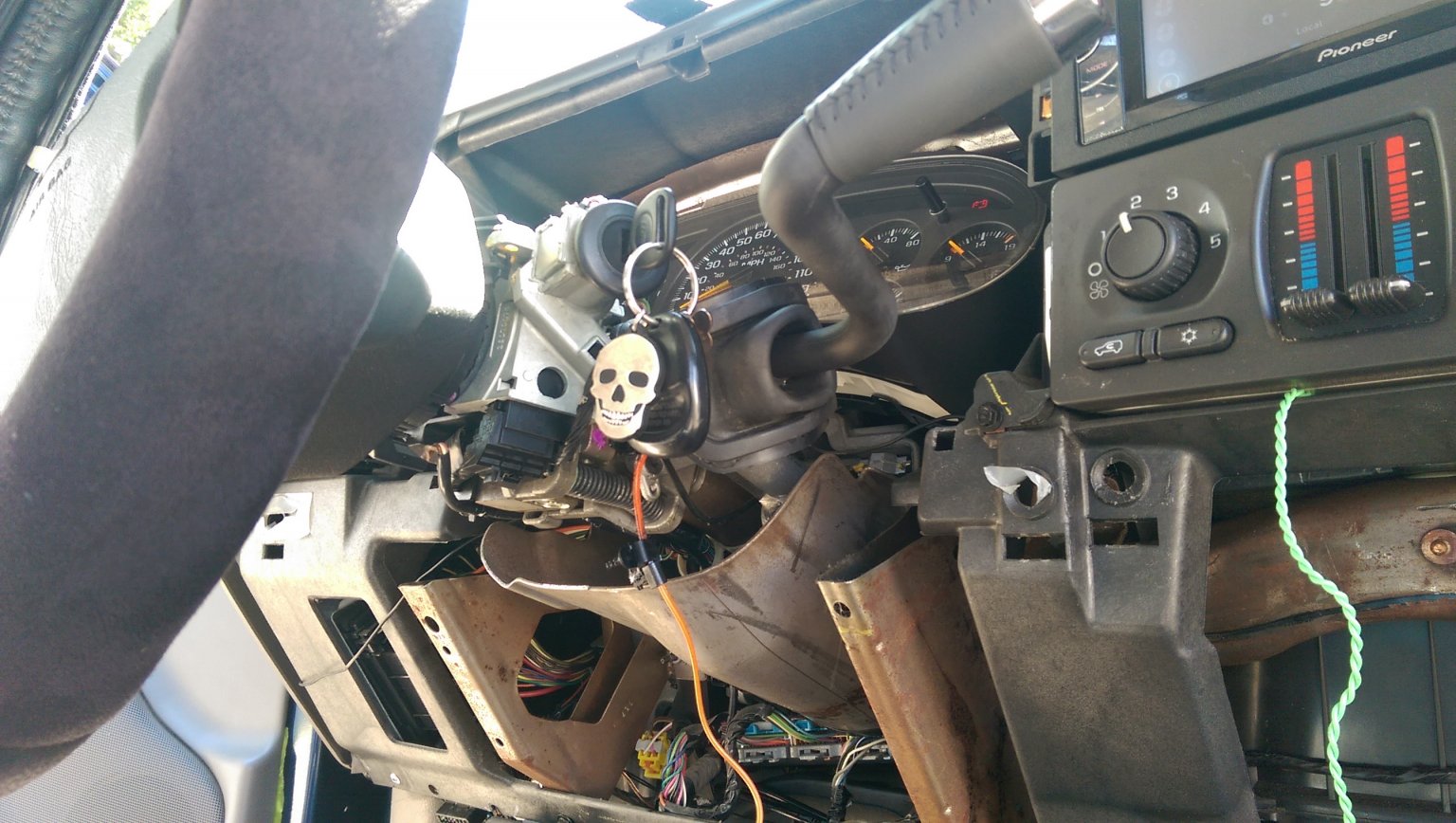

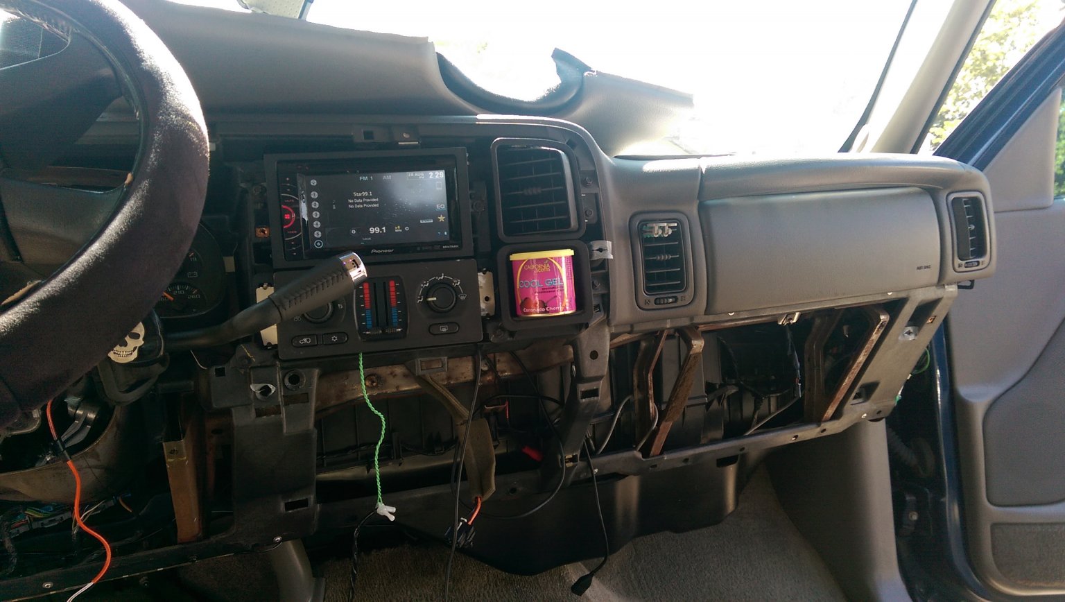

Next was the sound system. Stock radio was ok, but I was looking for something more. This is my Pioneer dd install. Love it. DVD, Bluetooth, all the goodies except for nav, which I don't really need.
It's the 7". I also did the homemade parking brake bypass. Just wired in a toggle switch from the ground to the parking brake wire, which is green in my application.

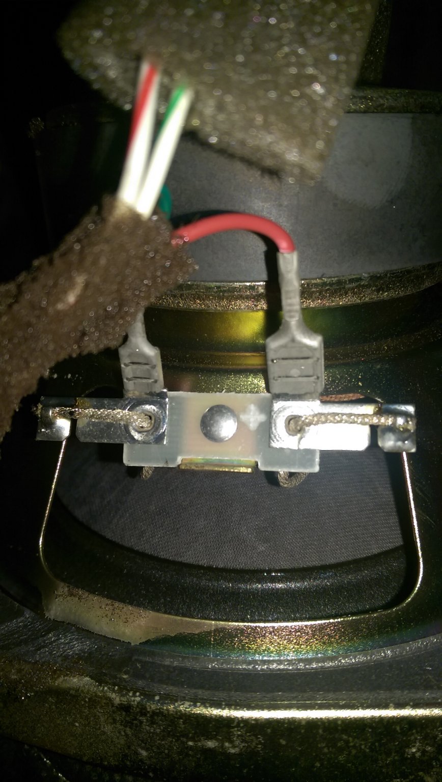

I then swapped some kicker 6.5's in all 4 doors. I don't remember the model number tho. Sound is much cleaner. I'm not an audiophile, but I do like my music. I then wired my JL Audio mono amp to a Pioneer 12" single sub in a ported box. Now it thumps pretty good, and clarity, for me, is spot on.
