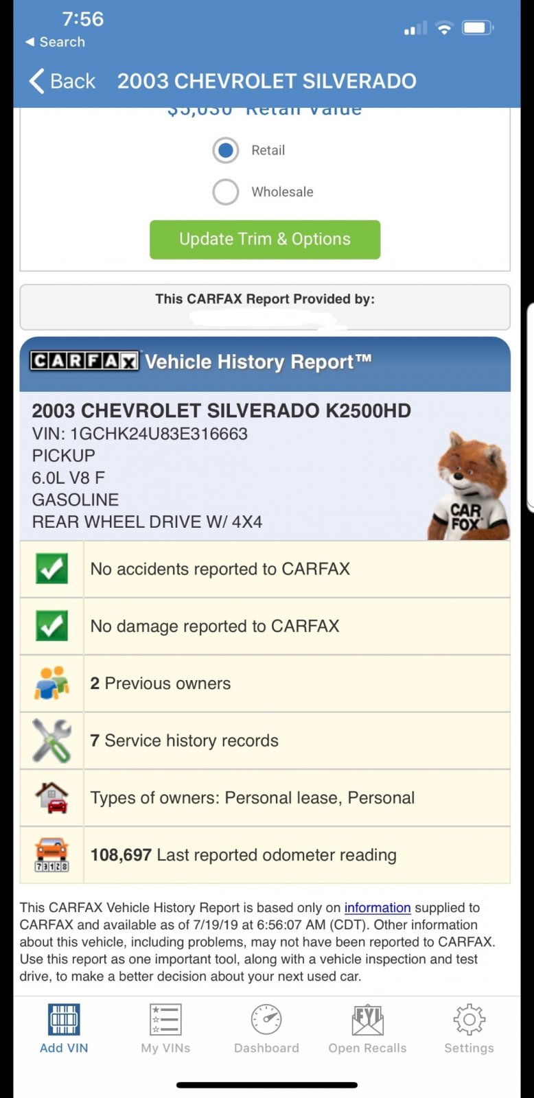

This current motor came out of an 03 Silverado--but all the 03 parts I bought don't fit, only 02 parts fit. I'm thinking it came from a very early 03--which most likely used a left over 02 motor. It's an LQ4.
It did go well with him. We talked about 20 mins. I reminded him that he's had it for 4 months and I don't want to be put on the back burner again.
This BTR cam us the exact same spec'd cam that was in my old motor, and it was AMAZING lol!
EDIT--I just realized there's 666 in the motor's vin! Found the issue lol :confused:

I just thoight someone would've liked the stock cam--no biggie.
This current motor came out of an 03 Silverado--but all the 03 parts I bought don't fit, only 92 parts fit. I'm thinking it came from a very early 03--which most likely used a left over 02 motor. It's an LQ4.View attachment 257782

I just thought someone would've liked the stock cam--no biggie.
This current motor came out of an 03 Silverado--but all the 03 parts I bought don't fit, only 02 parts fit. I'm thinking it came from a very early 03--which most likely used a left over 02 motor. It's an LQ4.View attachment 257782
Unless I'm misunderstanding why can't you use the parts you bought. 02 or 03 shouldn't matter. The only thing that should maybe make a differnce is the pistons reguarding valve clearance.
