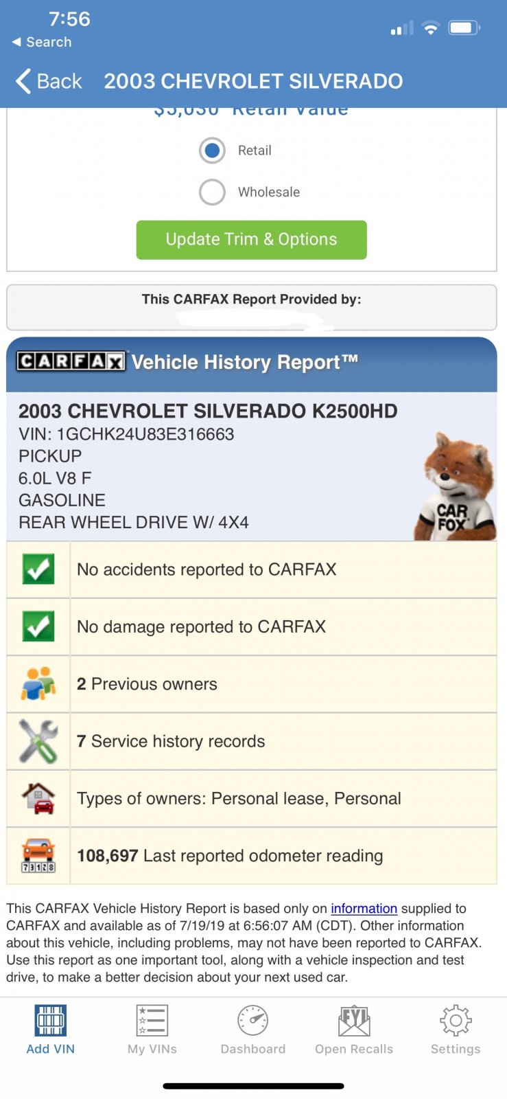

Got another one. Supposed to be delivered tomorrow. My buddy is gonna do this one, but he's not gonna be able to mess with it for another 2-3 months. That's fine with me, as it'll let me get some $$ together--as I blew OUR ***--again--on this one. Thx guys :waytogo:View attachment 240370
Fyp. ;)
Also, this says 2006, but the Carfax you posted says 2003.
