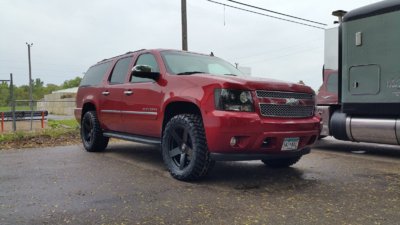

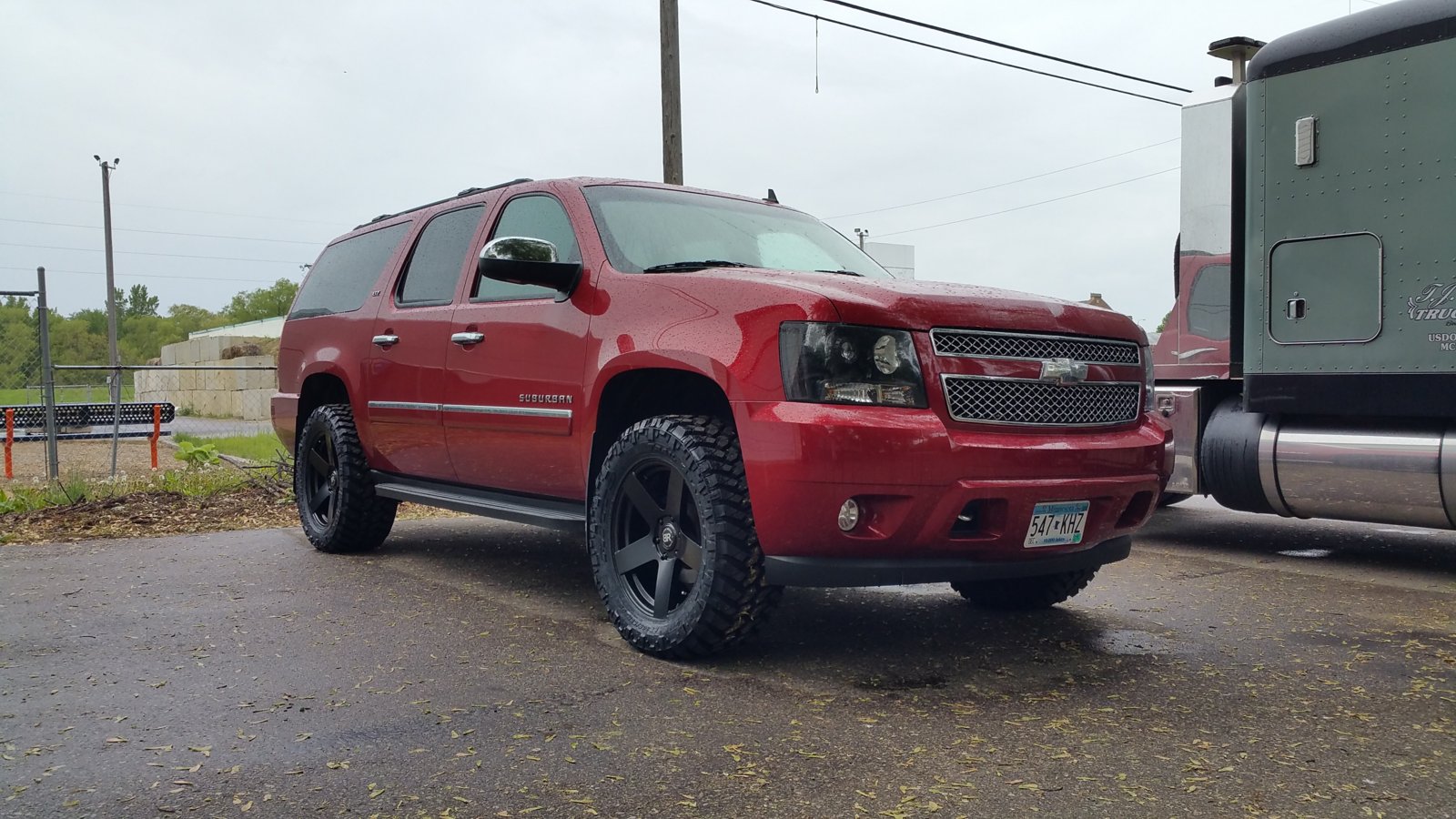

I'm looking at possibly deleting my Z55 air ride or just running a Bilstien B8 5100 (height adj strut) up front with different front springs and replace the compressor with a Doorman unit and some Arnott AS-2700's rear air shocks to keep the rear air ride for towing.
My stock compressor and rear shocks are shot with only 60k... I pull a 32ft camper during the summer months, and I run 295/55/20 Ridge grapplers (used to run 305 Mud grapplers, wife hated them), so I need a leveling kit (to clear the tires) and air bags or something to help with towing.
I currently have a 1.5/2 in strut spacer and rear pucks for a leveling kit. I'd like to keep my same height but do it with new springs and shocks (5100's) instead of a spacer and puck as another cheaper option vs the air setup...

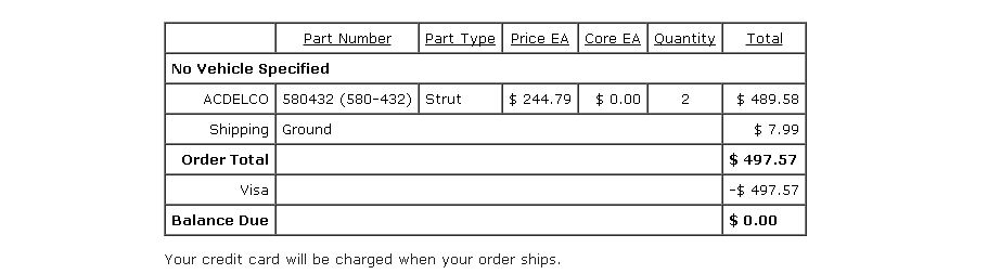

the strut shock is on rock auto, you will have to have a spring compressor or take them to a shop to have them swapped out
the arnott's for the rear are 2708 if your keeping the air ride. they are like $150 each and a $50 core each
here is the part information needed for the front and recent price, plus there is a 5% off code in the vendor forum
