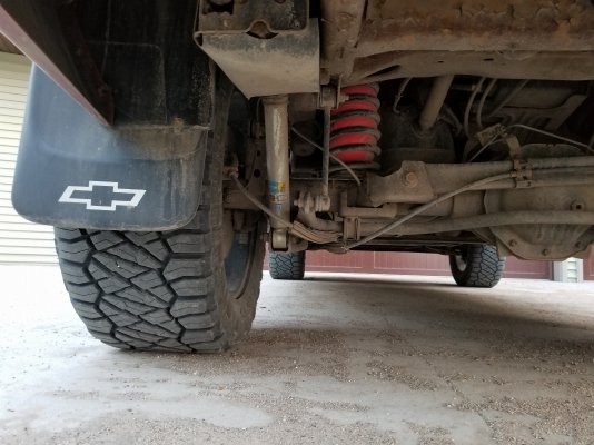

Guys, it literally took me this long to get the rear done. Had too much going on with life, and was pulling a 10k lb. trailer around with no air in the factory shocks.
Anyways, I got the rear done, finally... Didn't take any pictures as I was in a hurry. I had to unbolt the sway bar links and brake line from axle. Replaced the factory springs with the Z71 springs (which were much taller, also put helper air bags inside coils) and ditched the coil spacers that came with the old leveling kit. Along with the bilstein shocks and the new springs it rides great. Already pulled the trailer (empty), with my old setup it almost bottomed out my suspension even empty, it rides much better as well with 30lbs in the bags. With my 2.5in ccm leveling kit on front it's very level.

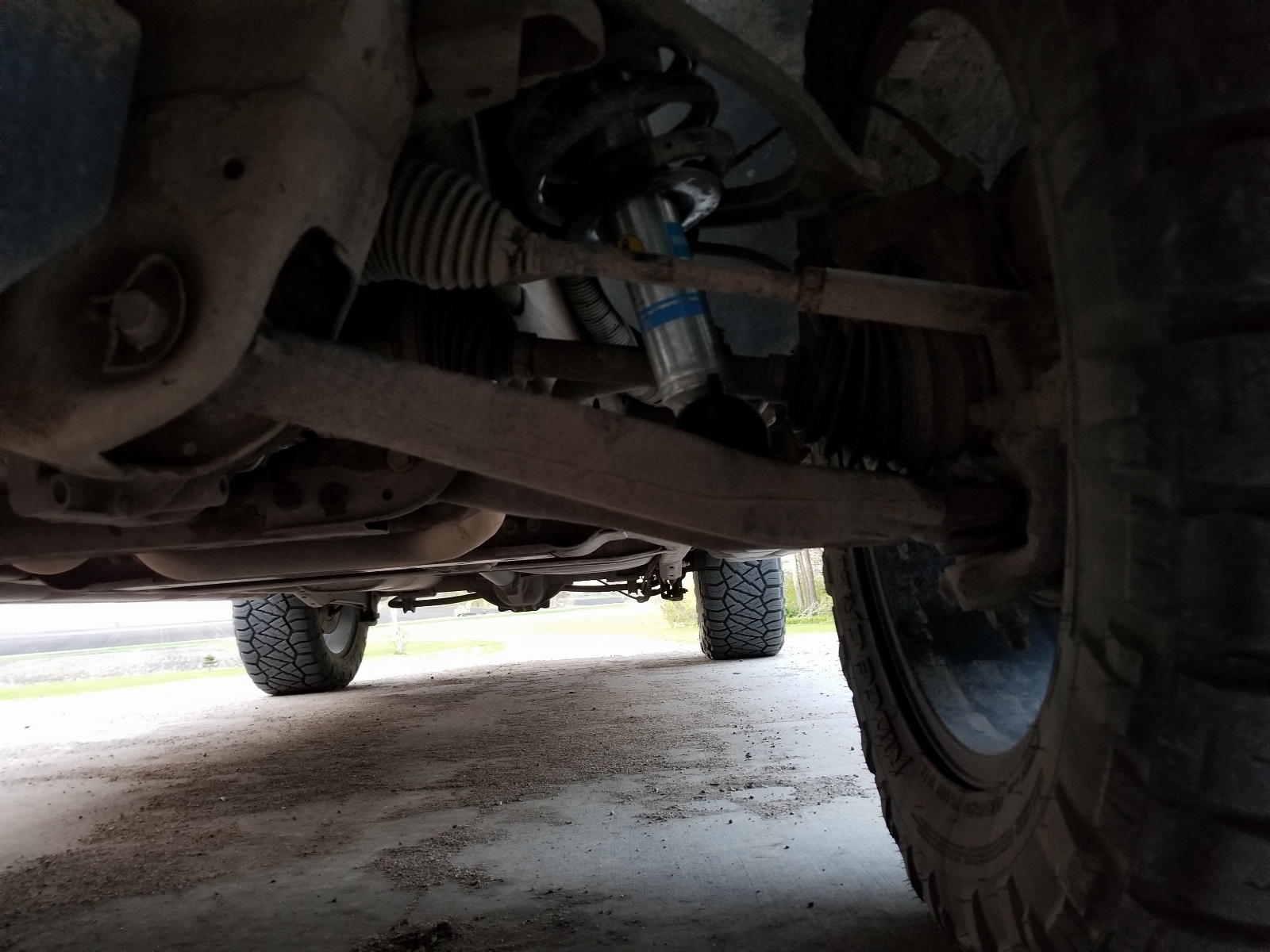

Tomorrow it goes in for the front strut replacement/swap, it will finally be done front to back. I'm going to keep the spacer (leveling kit) and put the 5100 bilstiens on the second from the top notch. I have new strut mounts and boots as well.

I got the front struts installed yesterday. I had them install them with the bilstiens at the second from stock setting along with the 2.5 CCM strut spacer. Preload is a bit much, wishing I would have went to the stock setting, as it rides a little rough in front. It is exactly level with the rear. Pics to come soon!!! Overall I am happy, looks great, rides good!

Well... I have to say this thing rides absolutely awesome. I take back what I said previously, it did seem harsh at first on the 2nd setting. But after I put a few hundred miles on it today, a 100% difference. They must have settled and had a chance to break in because the harshness is gone and it rides smooth as butter. Best 2 things I've done to this burb was the brakes and delete the Z55 Auto ride. Loving the ride with the Z71 springs and these Bilstein's.
