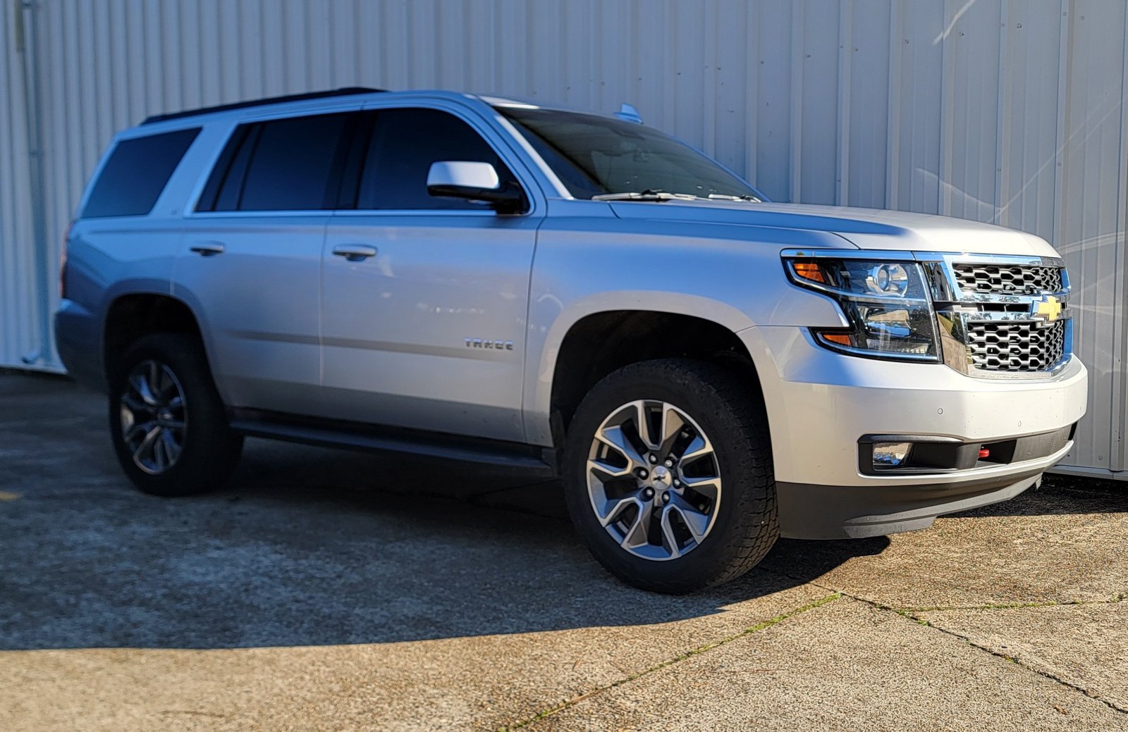

I'm currently running stock (ZW7) springs w/ a 1" spacer, Bilstein 5100s all the way around w/ the front set all the way up (about 1.5" lift). The truck looks perfect unloaded with about 1/2" of rake (as measured at the fender wells). The problem I'm having is sagging when I'm trailering (SxS or bass boat). I originally wanted to add Air Lift bags, BUT I now think I want to run a heavier/taller spring and/or remove the spacer just to have less BS. I'm not concerned about ride quality (my other vehicle is a dually).

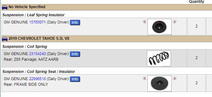

Rockauto. The total w/ shipping and tax was $131.57.
The part numbers are on the attachment.
