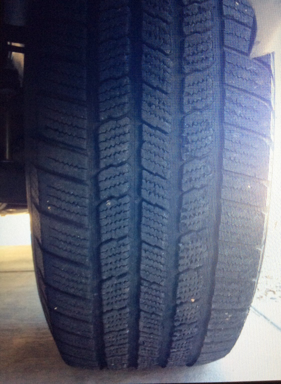

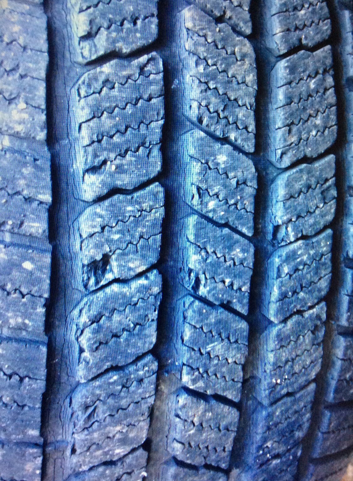

image.jpg image.jpg I have a 2004 tahoe Z71 and I've owned the truck for almost 3 years. Thought the tires which are Michelin were new when I bought it but the code on the tires are from 2010. I do live in AZ and have only put around 18,000 miles on it since I've had it. Trying to figure out what the tire wear is from. Everything from from ball joints, control arms, and tie rods have been replaced up front before the wear started. I have slop in the steering, and it does wonder on the road while driving. Could this be the steering box or just crappy tires? Both front tires have the wear.

The tires may have been in a warehouse for a while before installation. Do you drive on gravel regularly? Regardless of the miles or the age, they're ready for replacement. Get an alignment with the new tires and see if the wandering goes away.

Have you checked your steering intermediate shaft? That won't cause tire wear but does cause slop in the steering wheel. The tire wear you have looks to me like they are old and dried out.

Those tires are dry rotted. Time to replace

Michelin are a softer rubber then most tires for a better smoother ride, those tires are 6 years old and most tires need replacing after 7years, those little chips of rubber missing are from either peeling out or from turning or uneven surface and took little chunks of soft rubber out..... Now for those cracks Inbetween the tread, that's from the age, there almost 7 years old.. if it was me I'd run them for 10,000 more miles or so and then replacement time!!!

it looks like you have positive camber \ / wich would account for the sloppy steering
by the looks of the left picture
holy crap youve had those tires since 2010 here in arizona you go through a set of tires about once every year or 2
