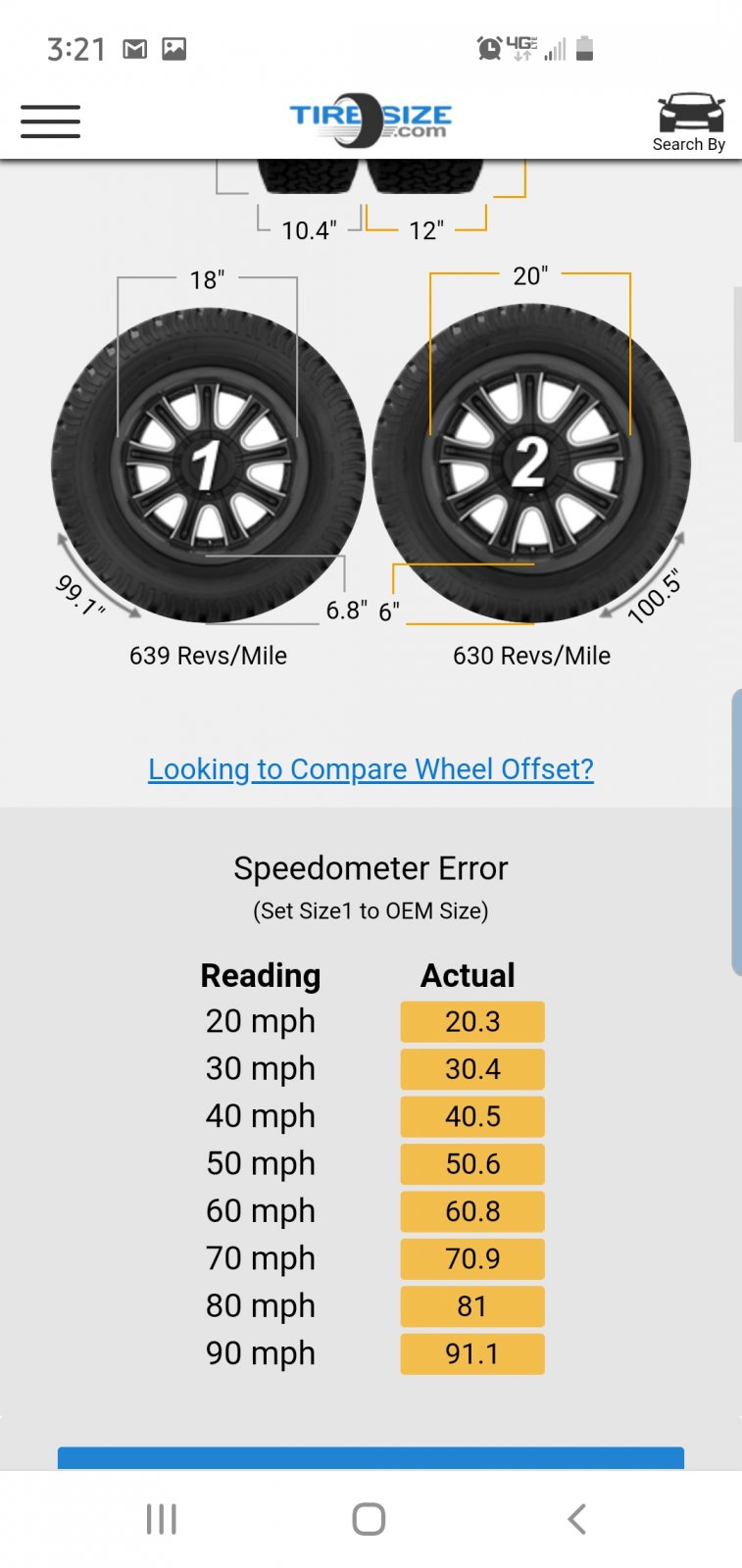

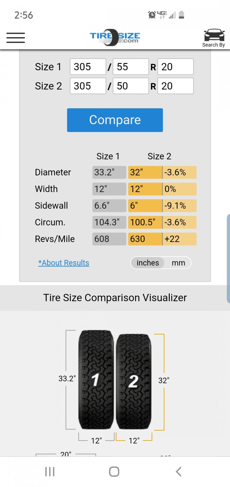

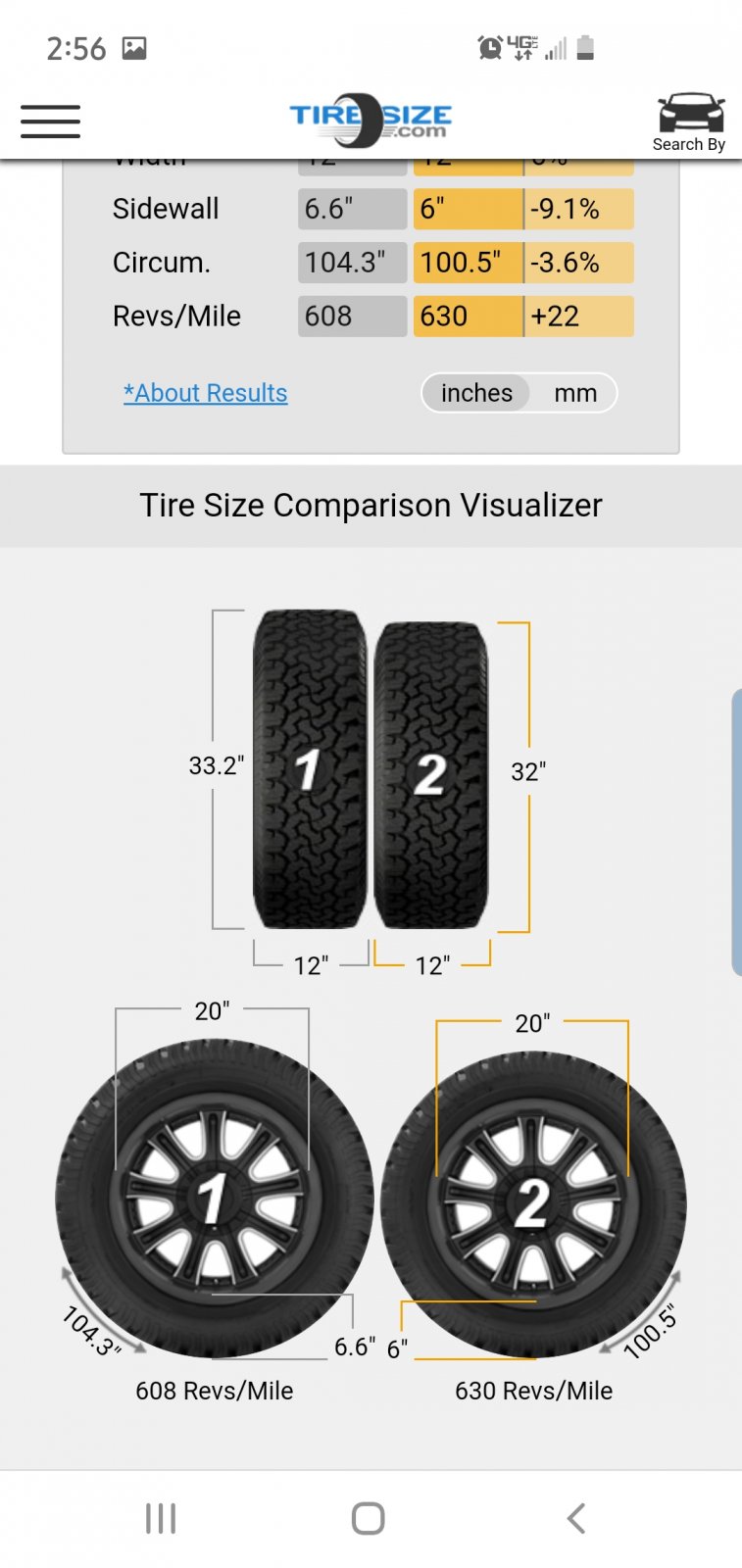

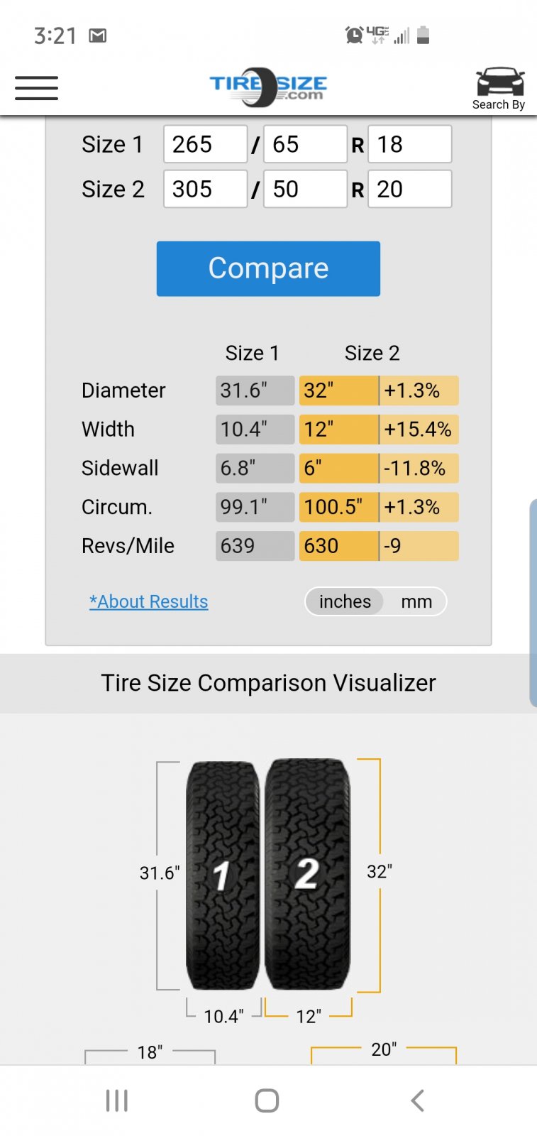

Here it is compared to stock size. 1.5" wider, only 0.4" taller. You sure you don't wanna go for the 33"??? Wink wink nudge nudge.
