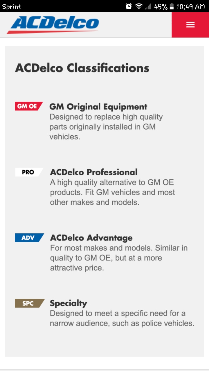

This is a commonly held misconception due to them naming it "PRO". A basic delco part would be the "advantage" line. You will notice that OE is always more expensive than PRO. I believe there is a reason for that and tend to stick with it. The delco lines are as follows:

Interesting I was told the pro was a step up... I better cancel that o2 order asap. I did send the 8.2 Taylors back to get the 10mm wires.

Yup, like that water pump you said. The pro is about $80, the OE is $125. The pro stuff is good. Most guys use it for most things without hesitation. There have been a couple times I've opted for it, as well. I would think the O2s are just such an item. Pro should be just fine.

The pro pump was specifically recommended over the oe unit. The research I did said it was an improvement as the oe’s were failing. This was two years ago I would guess. As for the o2, the oe has 2 part numbers and the pro only one, but if you read the reviews they state that the oe wires are sometimes to short when compared to the pro version. The pro version is pricer as well. Strange
21,322
30,319
I'm sure there are times when Pro is the way to go over OE as you guys are discovering. I don't remember the particulars but there are some things where only PRO is available anymore.
