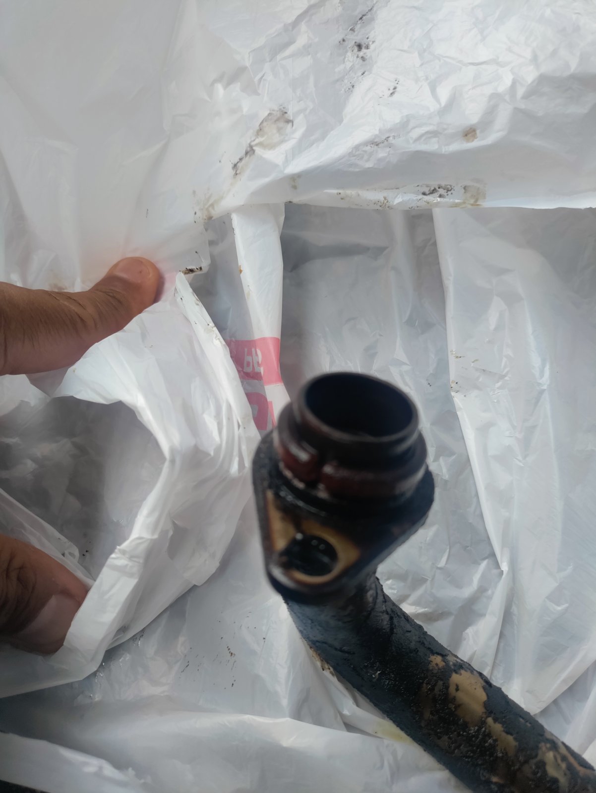

Found my oil pressure issue. Everything is all good now with the oil pressure and no more ticking.
