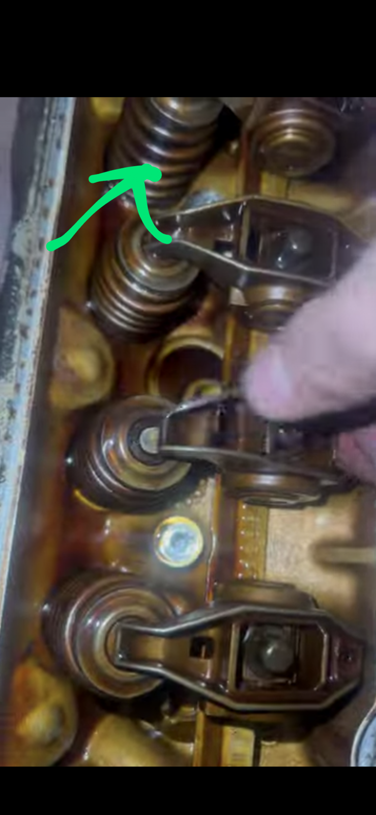

huh.. so it's hard to see in that video really. but is the spring compressed? cause it looks like it. if that's so, then it would be the valve that wouldn't come up.
which will require the heads to be pulled, but dropped. valve seat is a thing that happens to these too.

Green arrow is not compressed should look like.
huh. Interesting.
I agree, it does look like spring is compressed. I won’t be able to go check again until tomorrow. I don’t know much about this specifically but I'm assuming each spring should be opposite of each other for intake vs exhaust?
If it is a valve, then would my noise be the pushrod bouncing around as the lifter comes up? I have been tracking a very slight tick recently but it obviously got much louder
What does the repair for this look like? I’m not sure if the valve and the piston may have kissed but I don’t know what’s needed to reseat a valve.

yeah the exhaust and intake are next to each other per cylinder. which is opened or closed changes as the engine rotates and can kind over lap where intake and exhaust are kinda half open in transition.
as for fix, that looks really far down, so it might have been hit by the piston. if so, it will bend the valve over. how much damage you can really only tell when you get the head off.
really hard to say. it might be just a light kiss and you be OK with head work, new valve and guide, it could have folded the valve over and jammed it enough to go as far as bend the rod under the piston. it's kinda impossible to guess at this point. worth pulling the head to inspect. big thing would be rotate the engine by hand and make sure the piston comes up to the deck even with the other 3. if the rod bent, it would blow a bit lower at top dead center.
the ticking could have been the seat moved a bit holding the valve open just a bit and you heard the extra slack in the valve train. or any of 10 different things. Definitely some slack. in the valve train from something. the cam lobe would be worth inspection before it goes back together too.
Gotcha. Thank you for the info.
Sounds like if it was a valve issue that the lifter may have been fine and the slight rocker tick sounded like lifter tick when it may have not been. Just gotta tear it apart to check it out.
Is it worth trying to run it for a couple seconds with the valve cover off to watch and see if it could just be in an intake/exhaust stroke where they are both open?

can't hurt, I'd unplug the coil packs so it doesn't start. the big plug in the middle of the coils on each side. could even unbolt the rocker arm and tap the valve a bit with a hammer see if it pops up. but I'm 99.9% sure it won't.
if you pull the plug and can turn the engine over by hand. usually use the bolt on the front of the crank pulley. you might be able to look down in there and see some of the top of the piston and see any shiny damage from the valve. I have a bore scope with a articulating head that would be perfect to take a look up at the valve.
either way at this point I think it's gotta come apart to fix.
