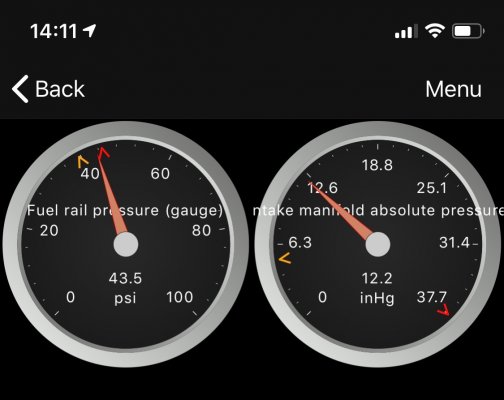

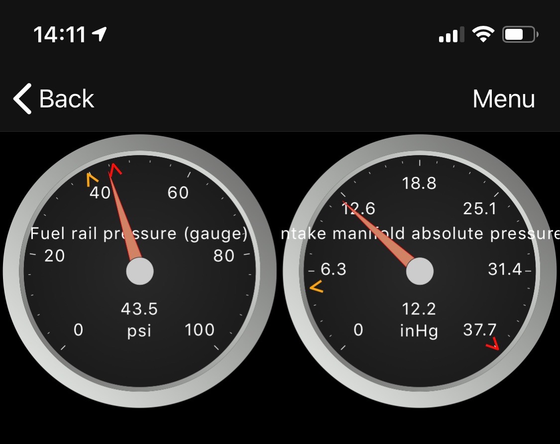

OK so Im looking at this again. Had another random shut off yesterday. Again, slowing for a stoplight. Its been hot so I haven't looked into doing the power wires yet but I figured this I could do now. I put my OBD app on and took fuel pressure readings for a couple miles. The high and low aren't very good according to your numbers. Hopefully I can have it running when it happens over the next few days.
it doesn't tell you what the low was? is that what the yellow marker is? 43.5 is probably fine, under 40 is probably not, not sure at what point it would cause it to stall out though
@swathdiver do you have minimum specs for fuel pressure?
Yeah yellow was the low. But this was only from like two miles after I got that gauge configured on the virtual dash. I will run it more this weekend and in stop and go traffic. Hopefully to catch a shutdown. At that point, if the low is under 40 then I guess I'll be dropping the tank lol.

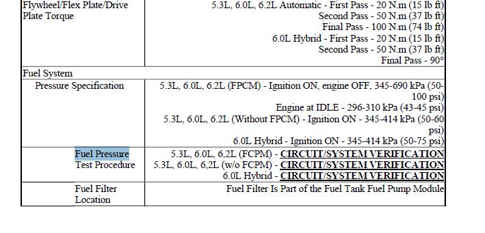

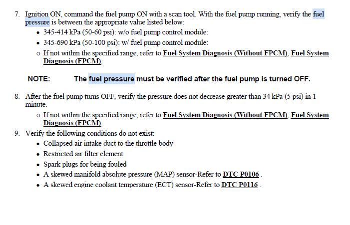

Been looking for an hour and can't find a minimum pressure in the manuals. The only reference I found was to follow the instructions in a GM fuel pressure adapter computer that gets hooked up to the fuel rail.
I know that for 2008-2014 Gen IV engines, they run at 43.5 psi.
I wonder if @olliec420 can see the duty cycle or % that the pump is delivering. That may tell us something and we can compare it to ours with our Tech-2s.

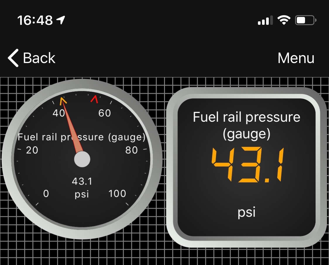

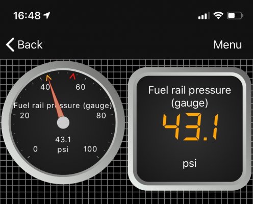

So without starting the engine, turned on key and it went to over 50 and then trickled down over about a minute or so. You see the red is the high mark where it came on and and then slowly fell to 43.1. I took the picture then and started the car because I had to go. Hopefully that is the right procedure. I saw a youtube video that said dont worry if it trickles down.
