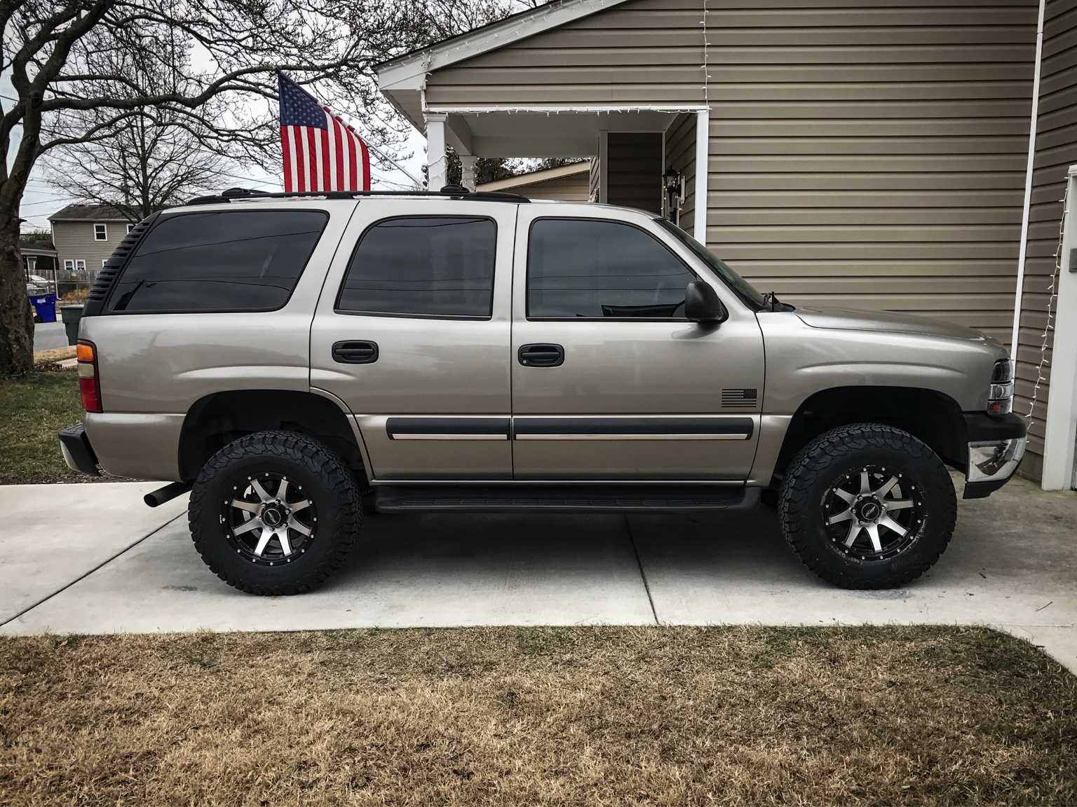

So as I posted before i lifted my hoe yesterday. Z71 springs and 2" spacers and amazon keys. Now the front I'm good I think. A little harsher ride, but that's expected. The rear though I'm getting a banging when I go over bumps when going 5-20mph. My guess is I need longer shocks. What do you all think? The spacers haven't moved and everything is put back the way it should be it's like it's over extending and then slamming down.

Back looks to high. Should take that spacer out to make it sit level anyways :2cents:
Those wheels looks great!!!

It's only an inch higher and the springs are new and will settle. The springs themselves aren't enough by themselves to lift it for the tires.
Yes I love these wheels.

What size tires? I fit 33x12 under my 2002 tahoe and I'm lowered about 2" lol. 26x10 rims with 305/30/26 which is 33x12
Rim size to tire size changes where the wheels will rub with your 26's I know because mine rub. Mine only rub for a split second when I first start turning. After my alignment we will see if it changes at all
