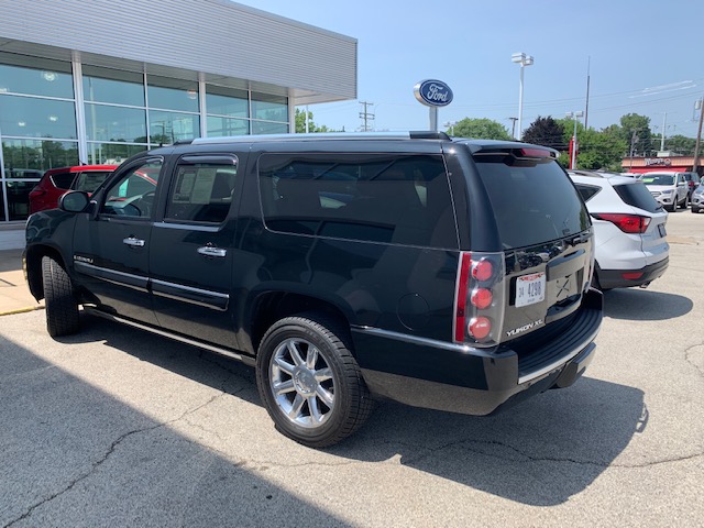

Lookd at an '08. Drove very well, AWD. Priced 13's
