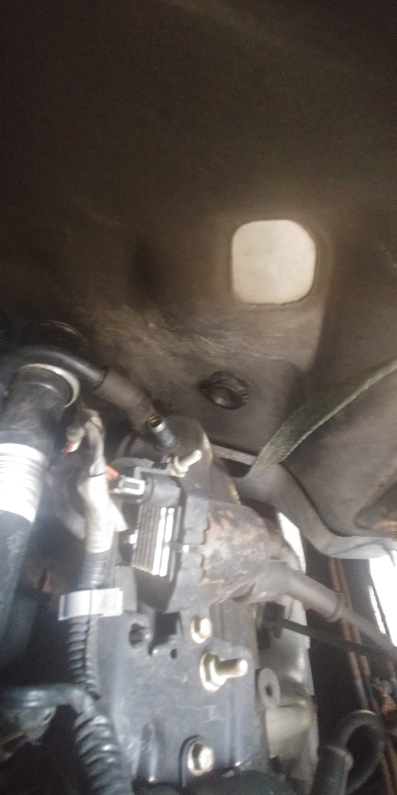

Do we have the same pcv system as he does? I think ours is part of the valve cover, no moving parts now?
Correct the 6.2 is on the valve cover with a tube. Cheap way to get a little better mileage. Under $10 for the valve and under 20 including the tube. Also recommended changing the valve cover gaskets and the purge valve. I’m guilty and need to change both. Why wait for a problem for $20
So the valve is replaceable or are you saying to use the old style? What purge valve? Sorry, I'm a little slow today.

this isnt replaceable is it? looks like its built in there:
