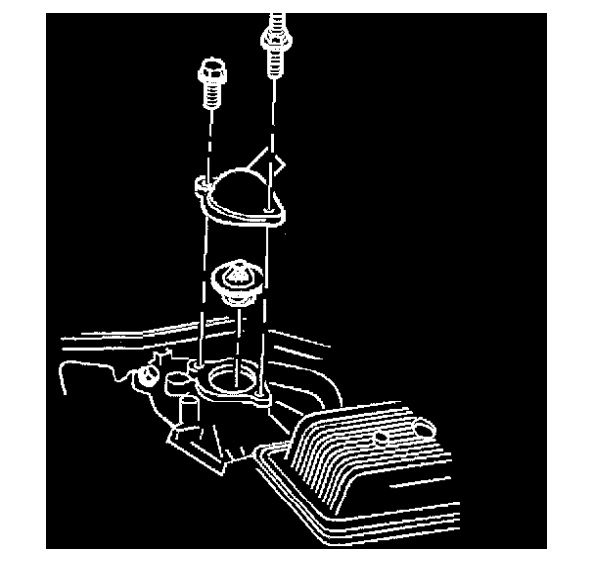

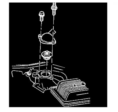

Oh ok I thought so. Will get you a diagram for it in a second...........
Should be small side down. As in this pic.

well i mean the direction. i kno the pointy part goes up. but i was driving w/o a thermo and it would stay cool till i got on the freeway. so i decicde to put on in. i put it in(no specific way) and when i drive it anywear it starts at the lowest and climbs fast past 260 then comes down and repeats. ive tried all thermos and same result.
