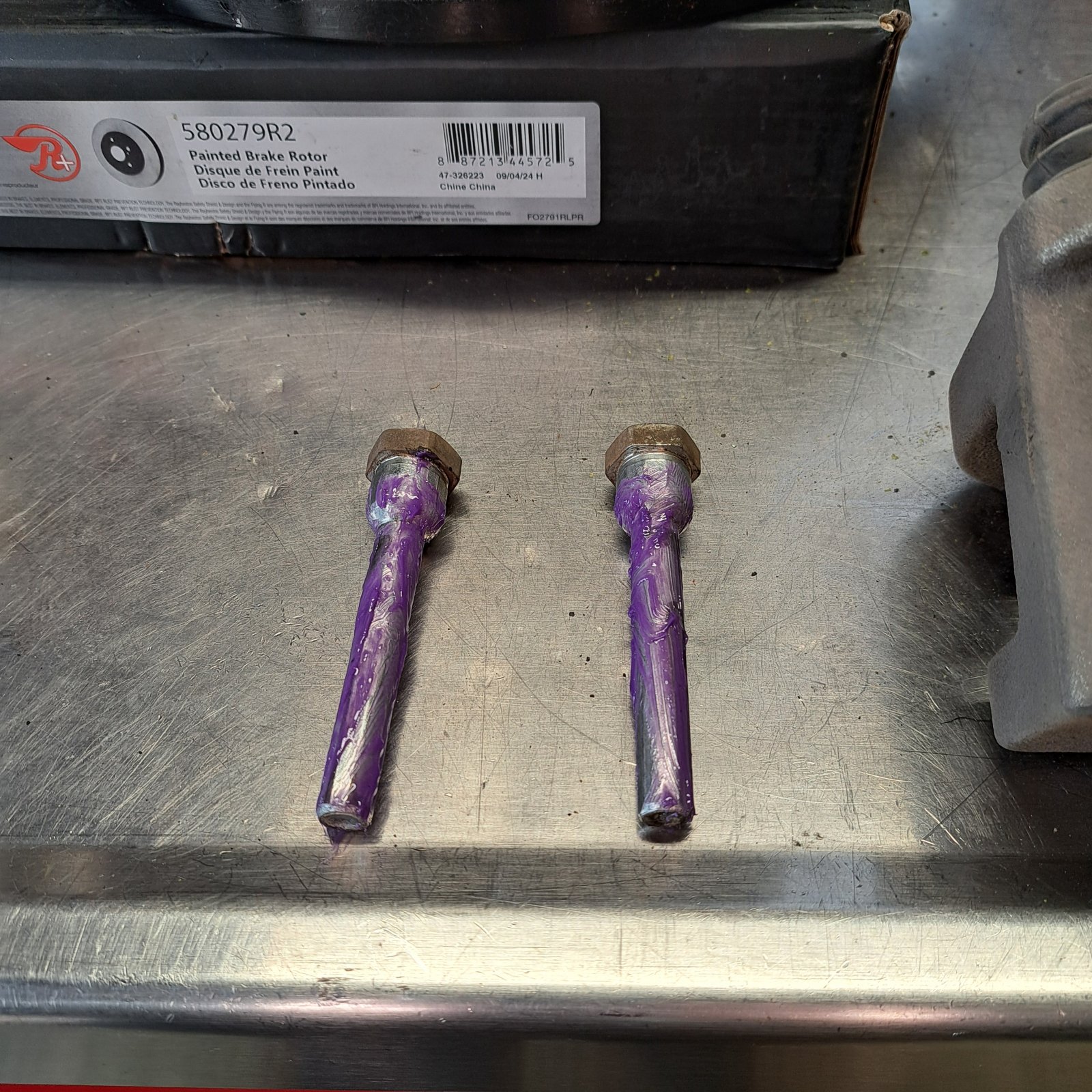

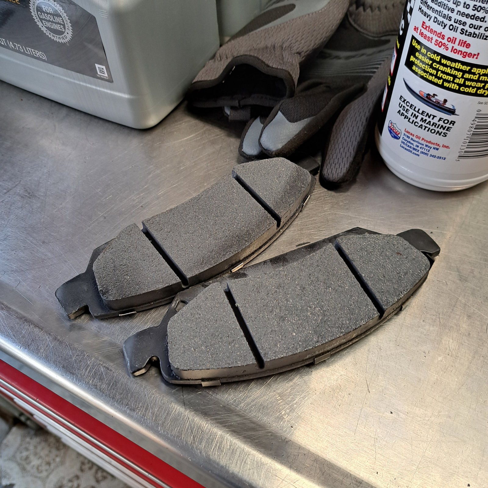

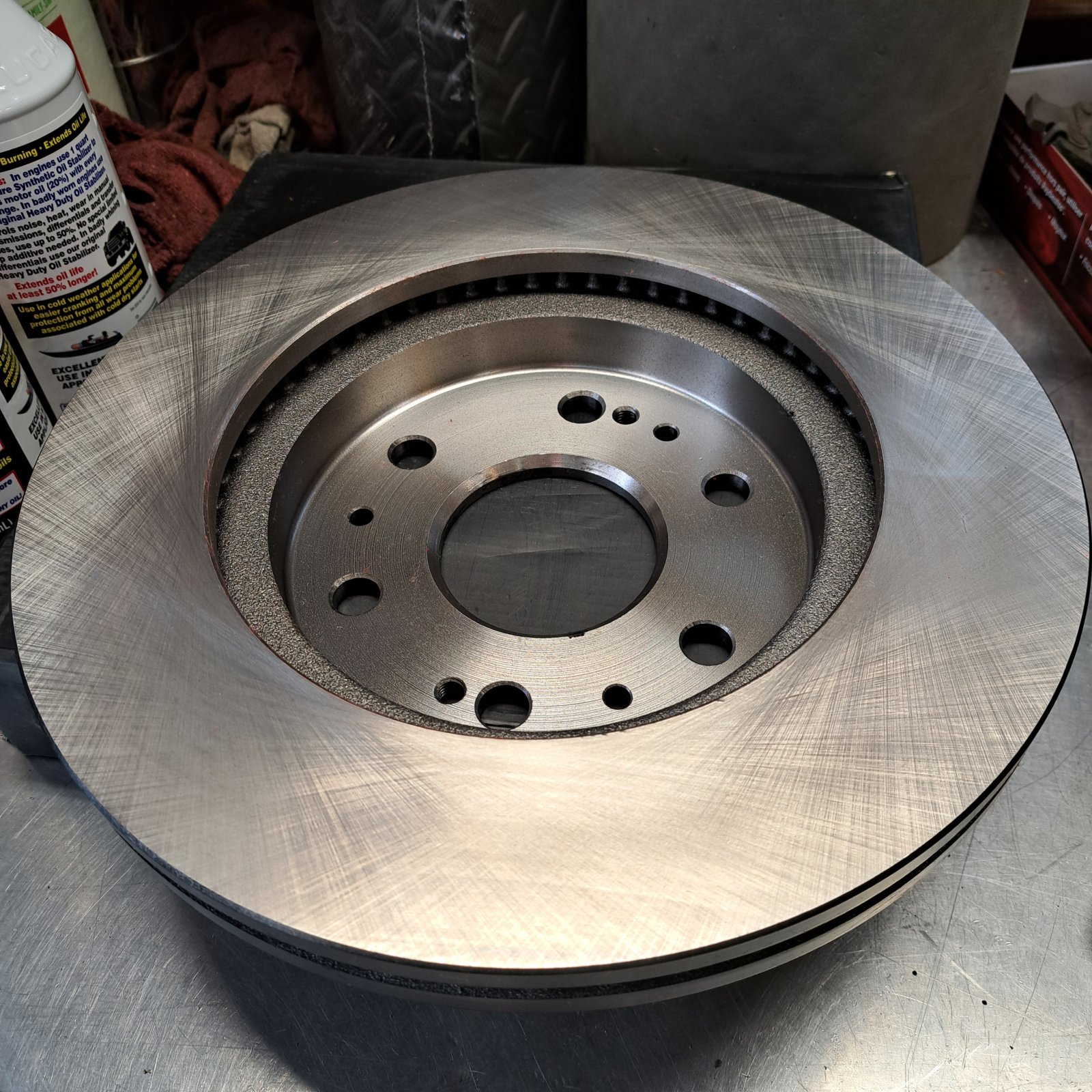

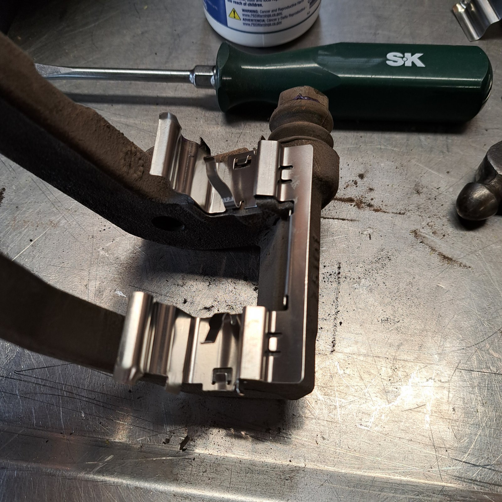

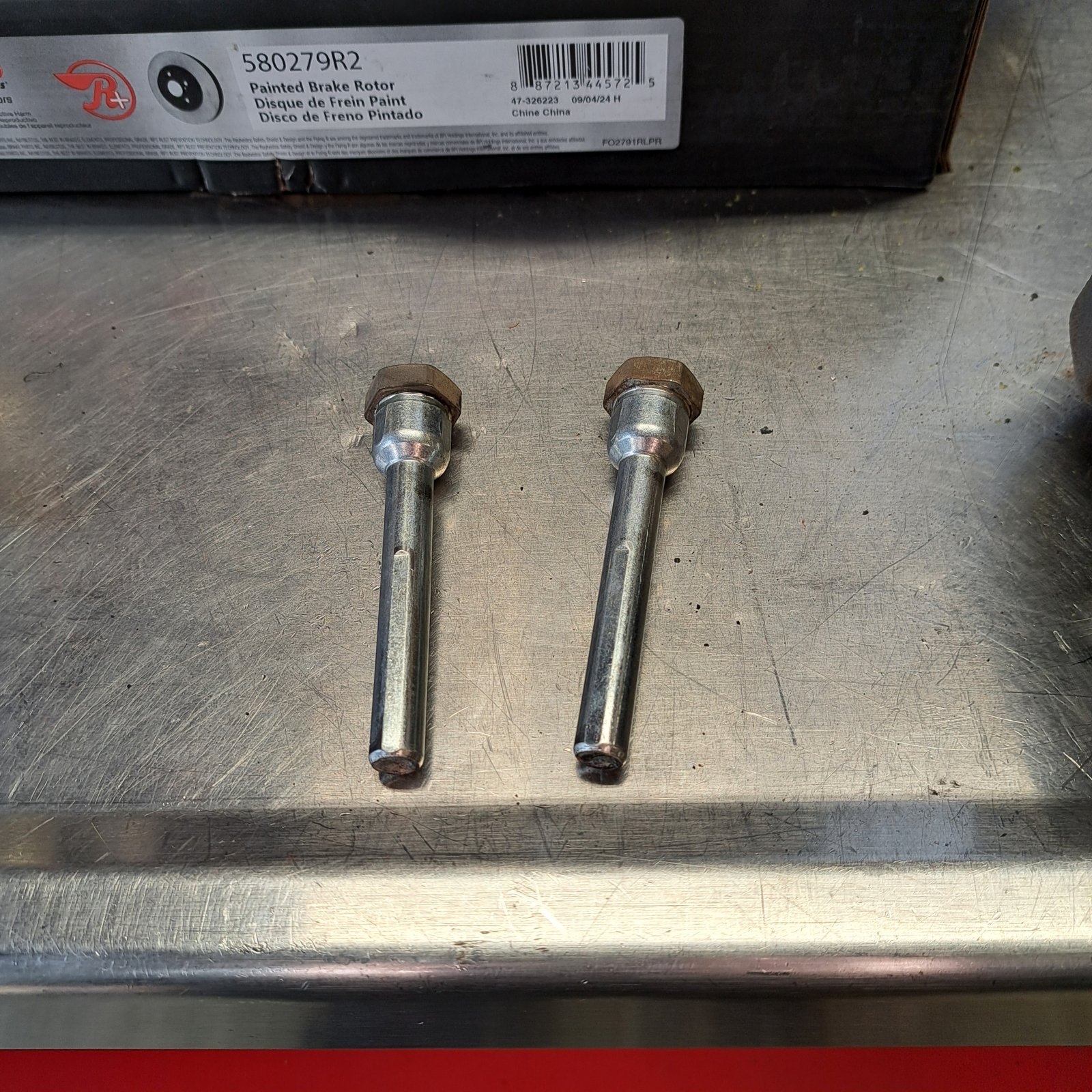

Landlord's 2018 Suburban LT needed front pads and rotors. Pretty bad pulsation. Took apart and found both inner pads were wearing at an angle. Took a long breaker bar to break loose the bolts that bolt the caliper brackets to the hub. All fixed and is now smooth. Pics are of the new rotors after I cleaned the coating off with brake clean, caliper slide pins cleaned and lubed, new pad hardware...
View attachment 457722View attachment 457723View attachment 457724View attachment 457725View attachment 457726
Just in case some one else does brakes on those series trucks, be aware that, in the hardware pics you can see the long spring fingers on the inner area of the hardware. When you load the pads in, from the outside, those fingers are designed to lay/push against the pad ear from the inside and those fingers, at top and bottom, are designed to push the pad away from the rotor after brake pedal is released. They are not designed to ride under the pad ear. Also, be aware that there is an inner pad and an outer pad. They are different.
It will be important to lube the hardware where the pad ear rides to allow those spring fingers to do their job of the many miles of use.
Them spring tabs got me the first time I did my brakes on the 2015 Yukon. Don’t know how I missed it , but on both sides, the springs were wedged between the pad and the rotor.
