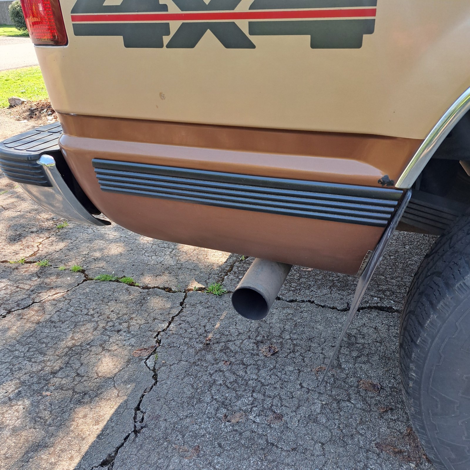

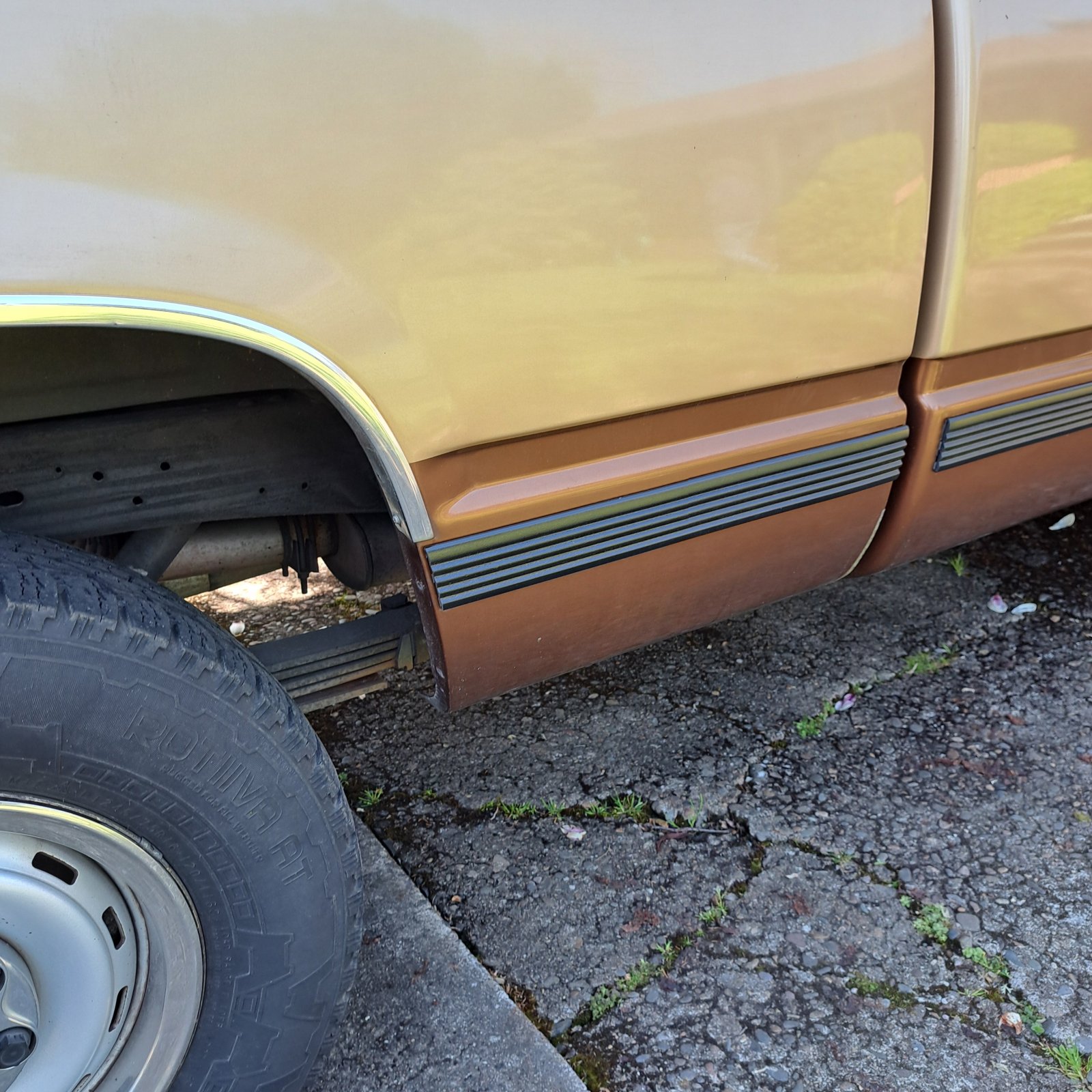

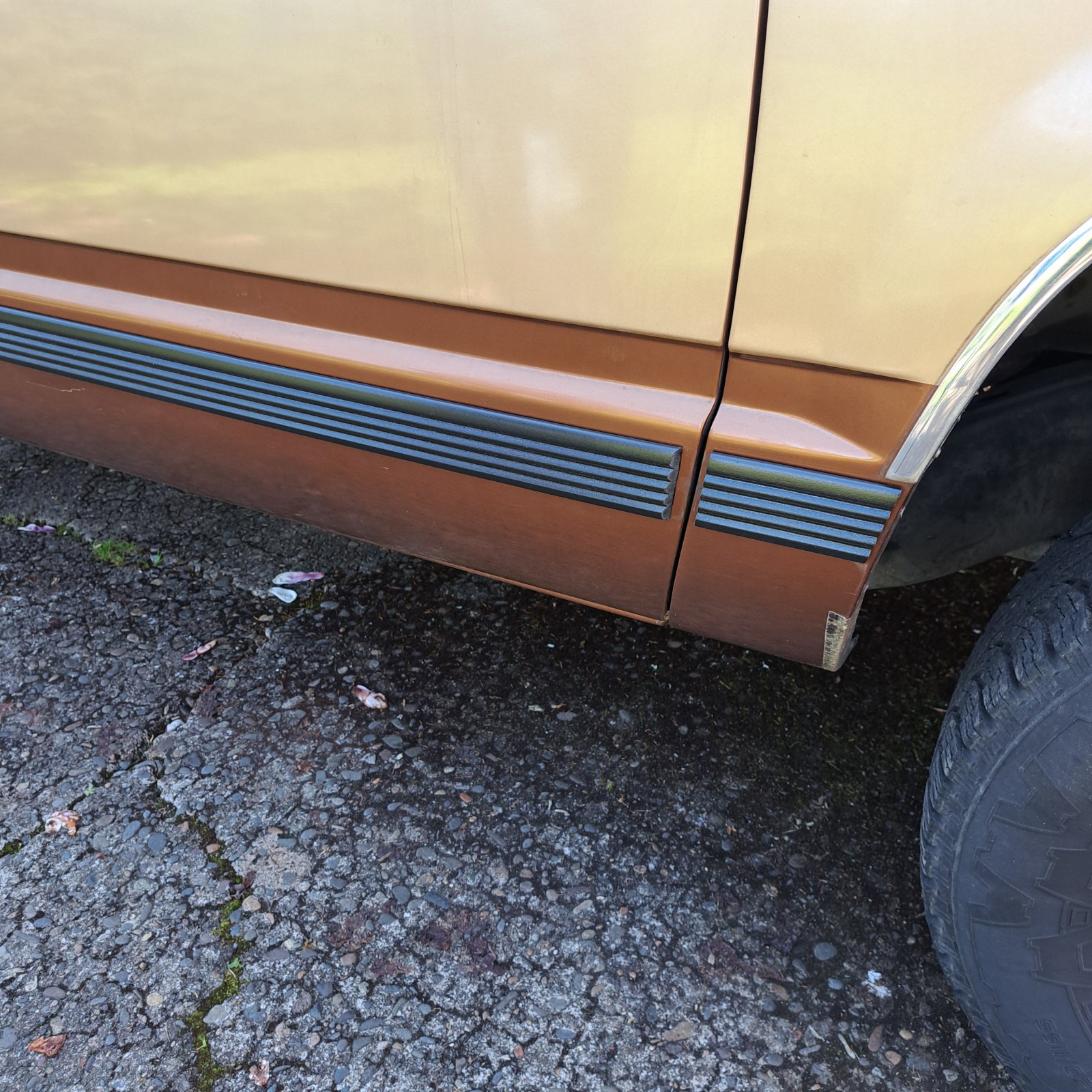

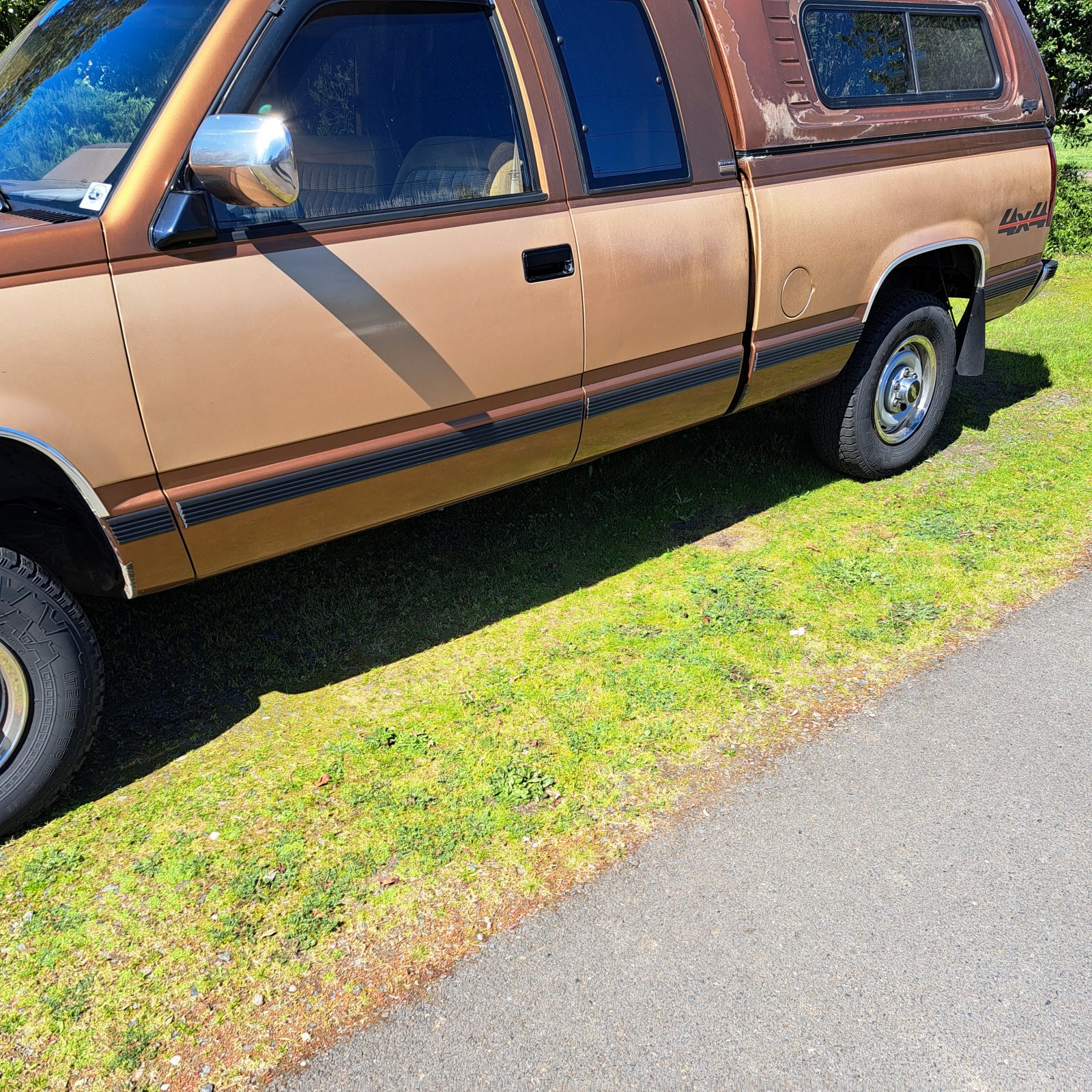

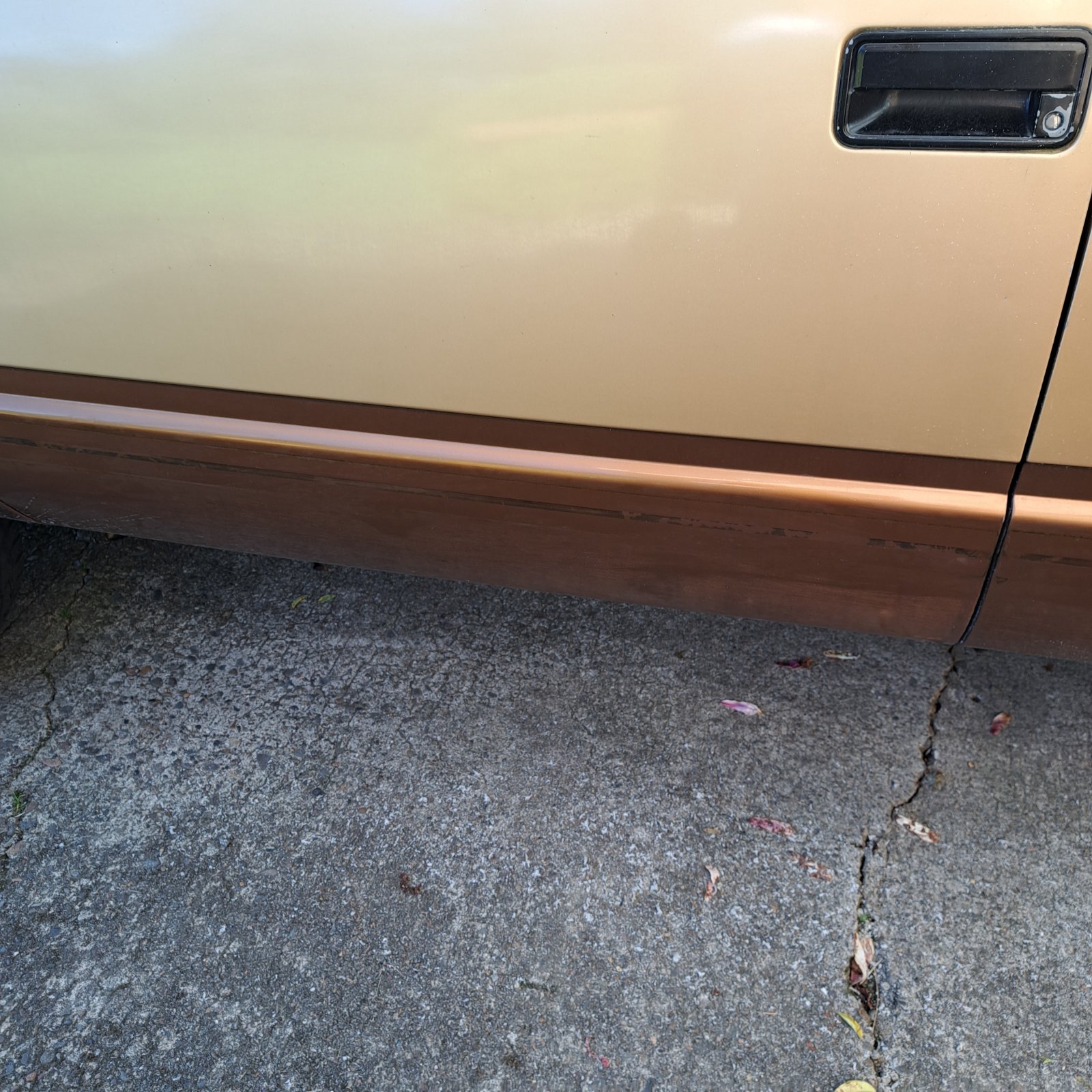

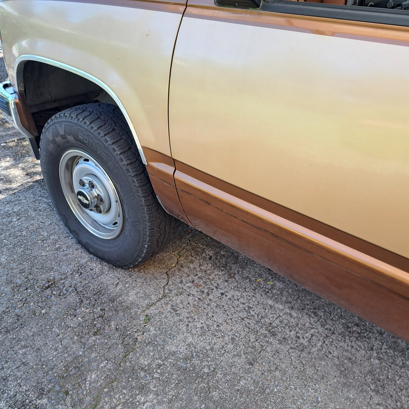

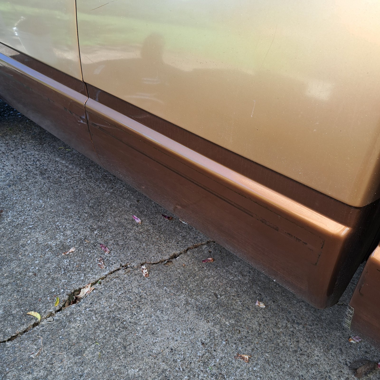

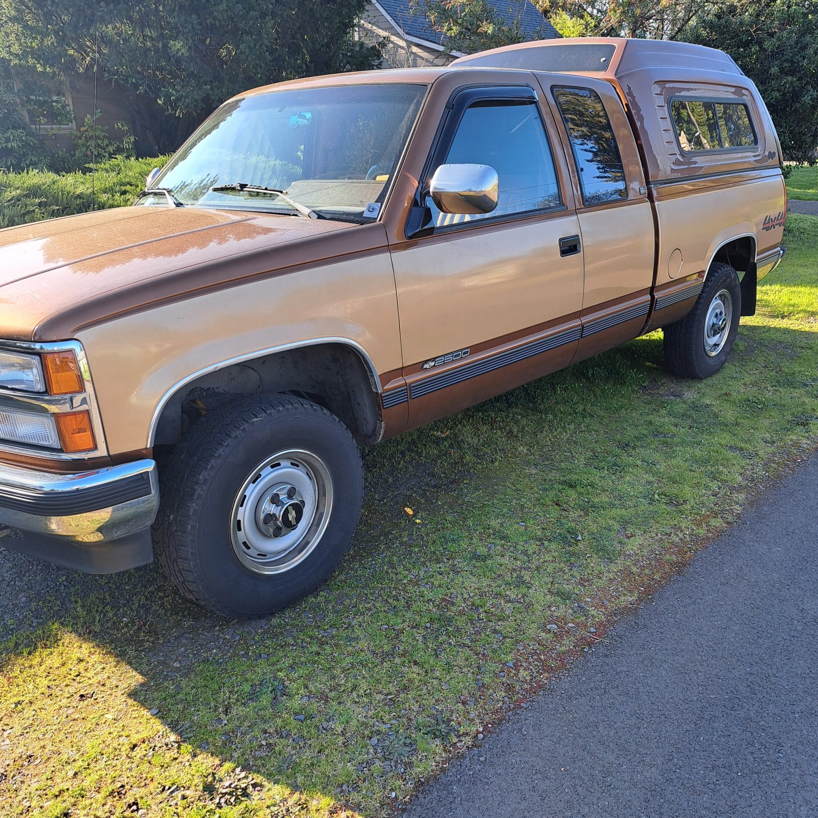

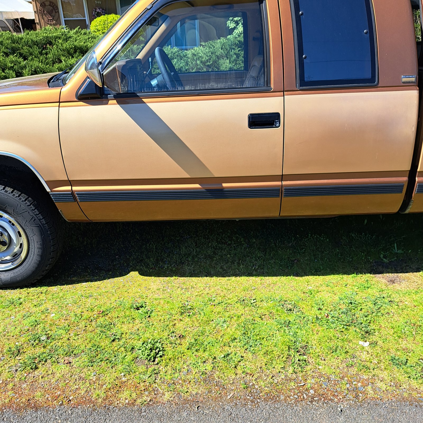

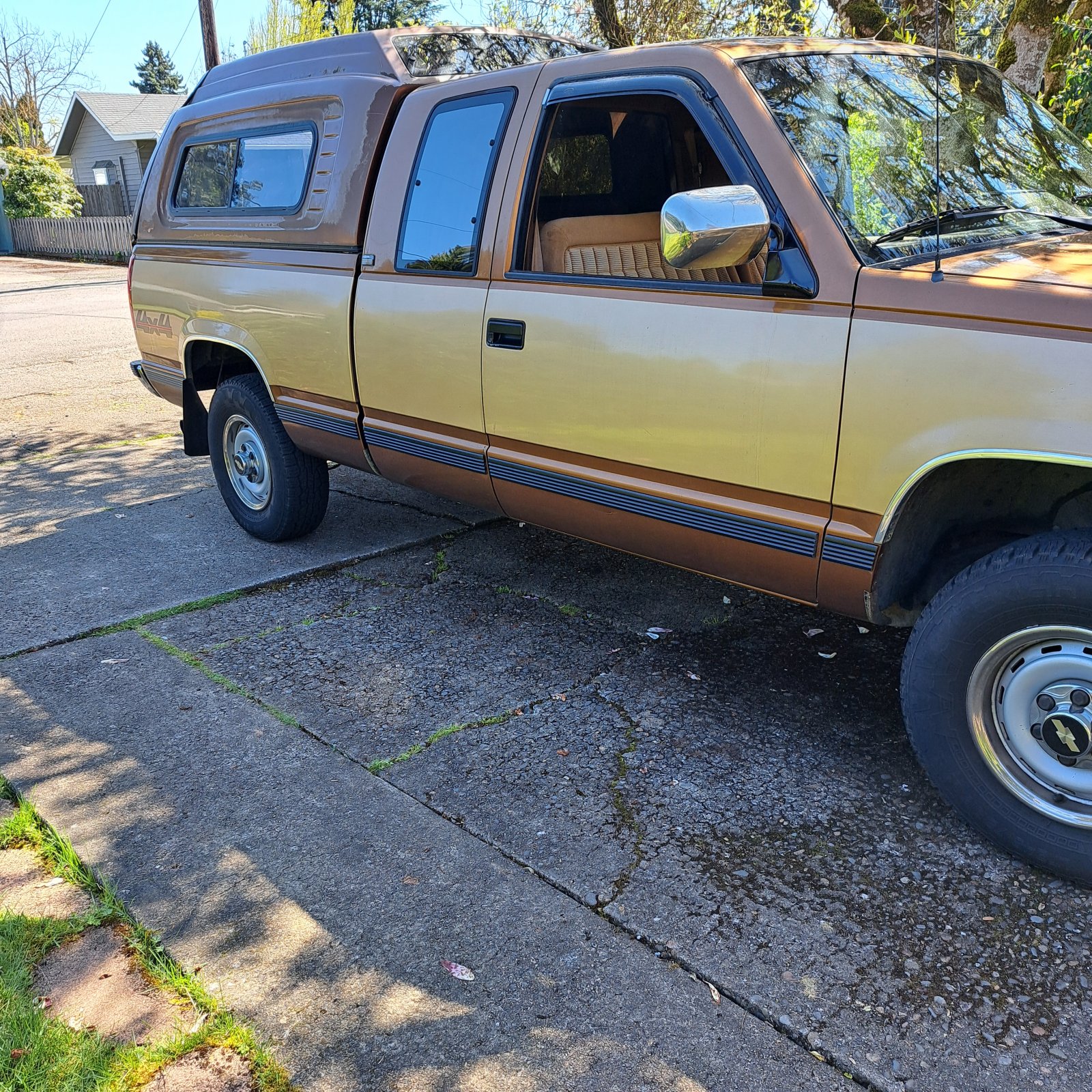

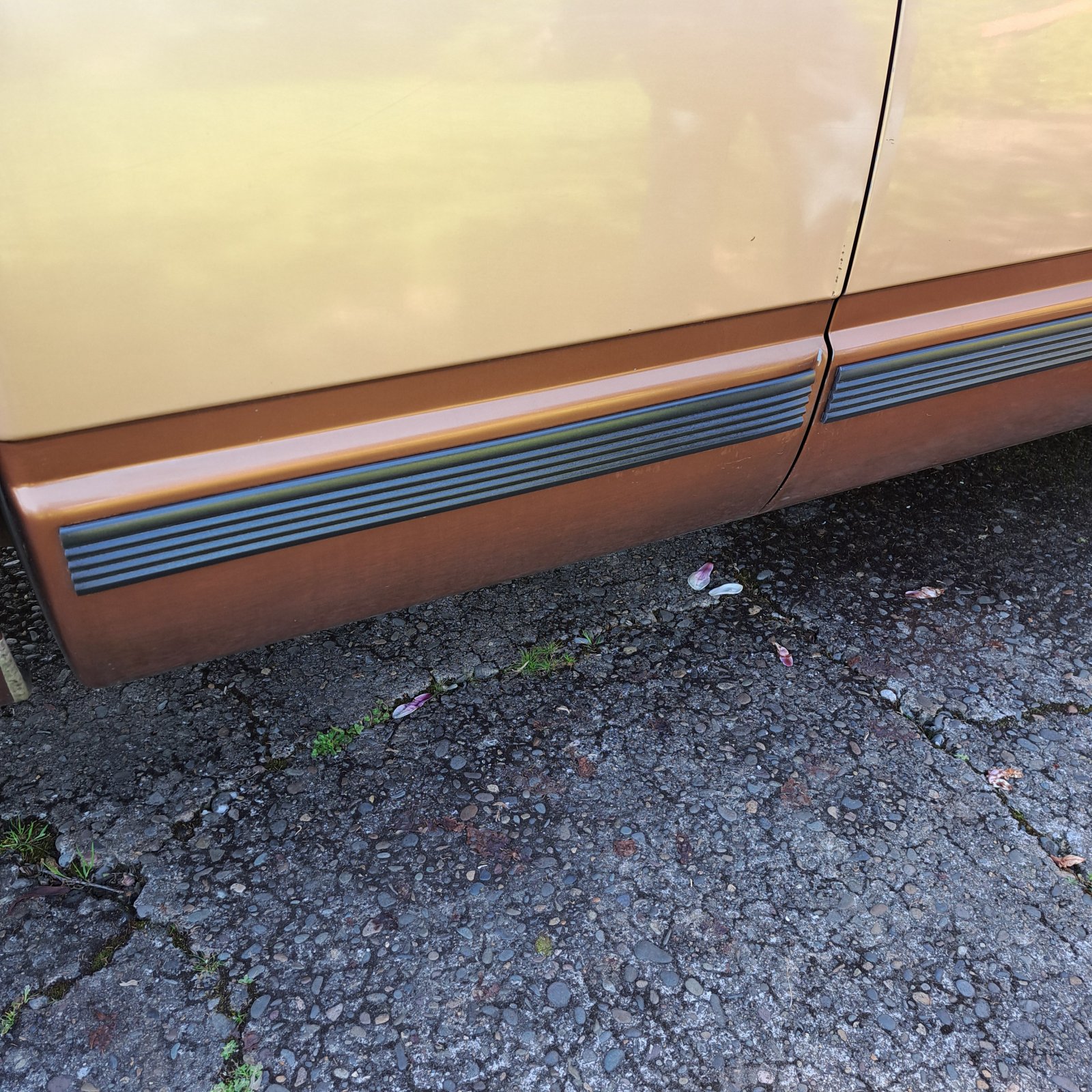

As I have warned here, I am trying to spiffy up my girl's 1990 K2500 and today I took off the old side moldings. The ones that had the silver stripe at the top of the molding strip. It also had the 2500 on it just below the mirrors. The new all black moldings don't have the hole cut in them to allow for the clips to install new 2500 emblems with the 2 tabs on the back that would push in to the clips and hold in place. Gonna get two of the flat back stick on 2500 emblems and attach in the small indented area above the side molding. here are the pics of the driver's side with the old moldings gone and the old adhesive ground off with a 3M wheel in the drill. Still have to wash and rub down and clean thoroughly and install the new black moldings.

Where’d you get the molding? I actually painted my chrome, on the top of molding, black to look like that but now that’s it’s chipping I might as well just replace it.
LMC Truck, out of Lenexa KS. $130 plus shipping. Get a 3M adhesive removal wheel and mount in a drill and it works real good. There is also a can of 3M spray adhesive remover for cleaning up after and then use some 91% alcohol to do a final cleaning and use the old lines to center up the new molding and the surface needs to be 70 degrees or more. Great directions come with the molding. You can get all black or with the top chrome strip. See my next post here to see what I did with the old Bowtie 2500 emblems and then remounted them. The new molding does not have the pre cut holes for the emblem mounting tabs so I double sided taped to the door. Pics are supplied. I can tell you how it was prepped.

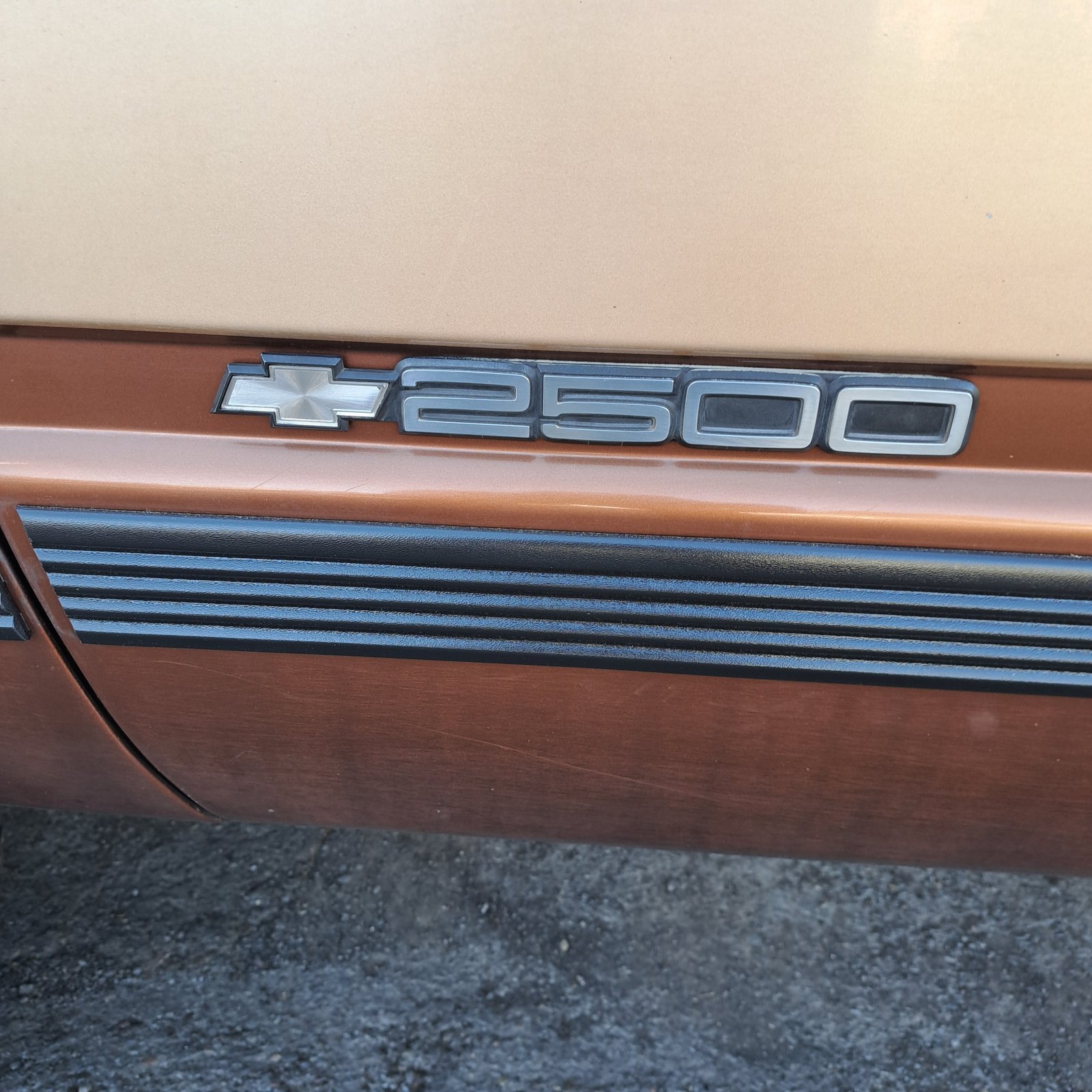

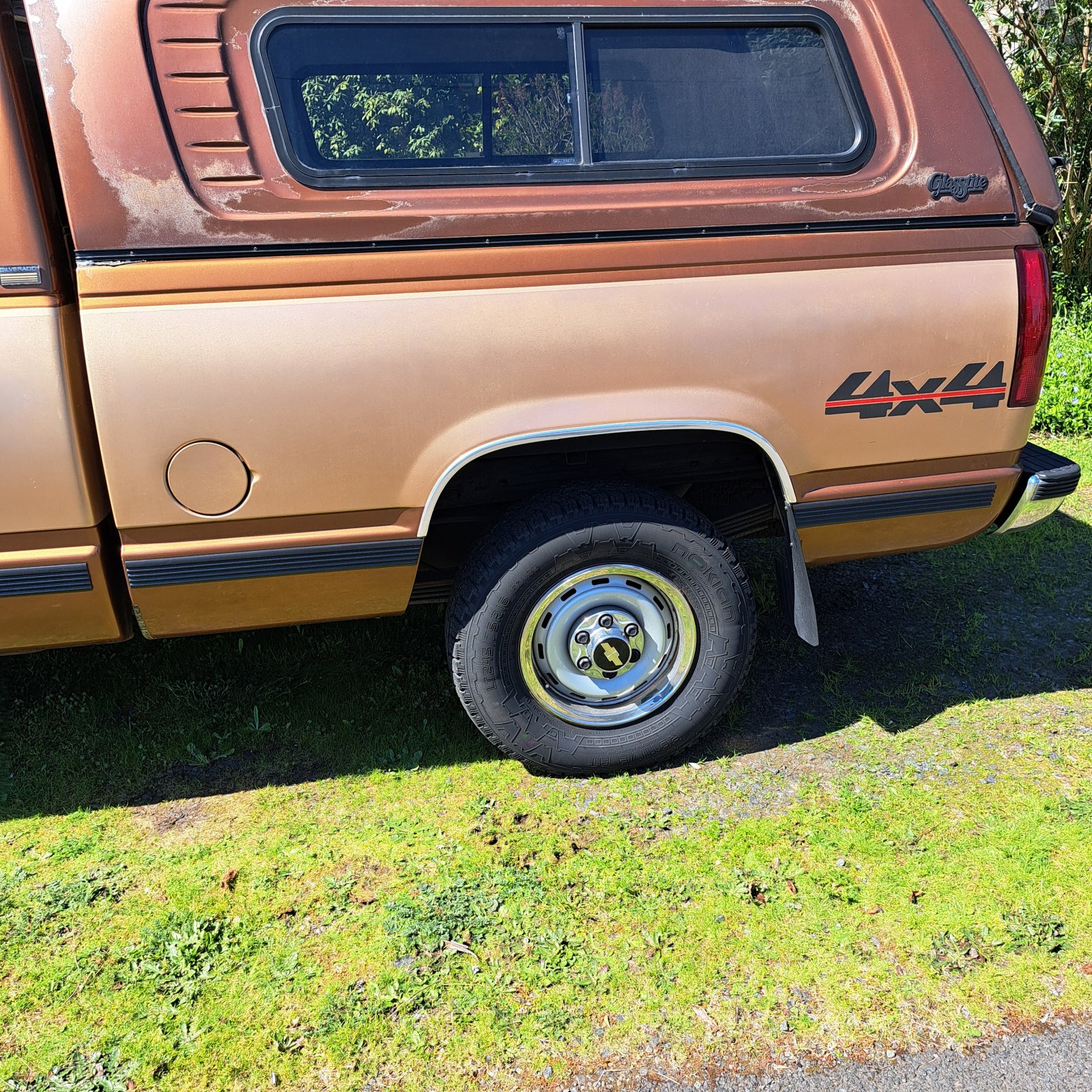

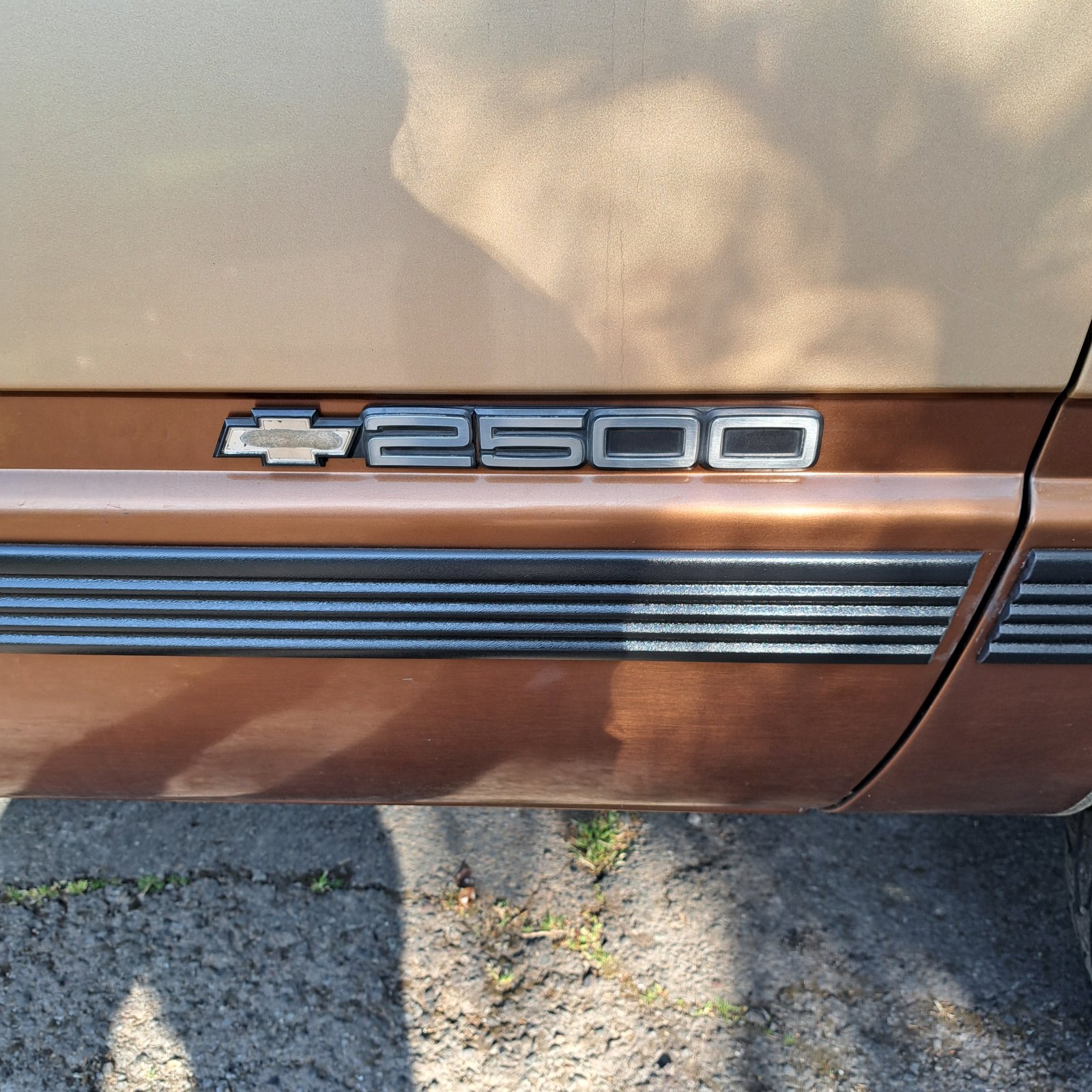

Ok, my friend cut the mounting tabs off the back of the original 2500 emblems and cut the small locating tabs off the ends. The bow tie had already fallen out of the impression it sat in and boogered up the tin foil chrome look behind it. I remounted that one on the passenger side. Used the same 3M molding double sided tape and attached in the indent on each door. Hope they meet with everyone's approval.

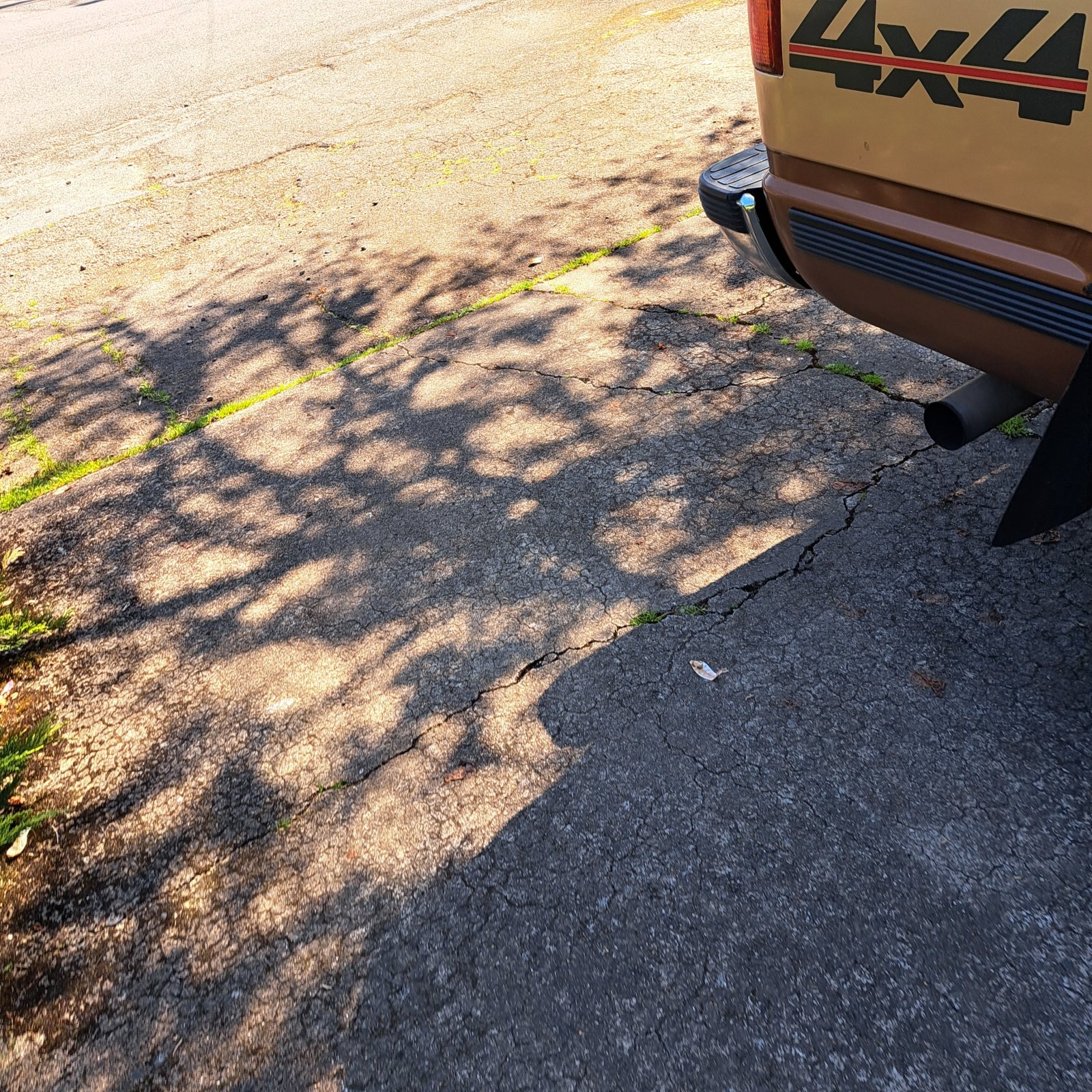

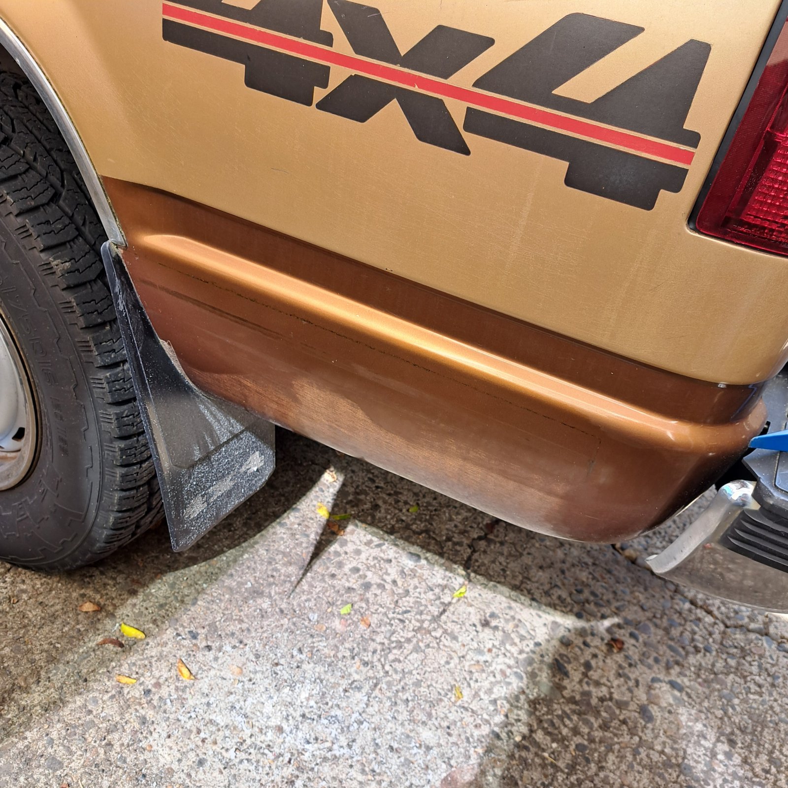

Gonna try CERAKOTE for the front and rear bumper impact strips and the front license plate bracket.

Just to let you know why I am using the OE emblems for now. To buy pairs of the stick on, they have to be shipped from China and I refuse to send my money over there and they are just under $50. To get the stateside ones, I cannot find pairs, can only find singles and they are anywhere between $55 to $70 each plus shipping. Discontinued thru GM sources and no NOS anywhere. I am gonna search high and low for some replacements. Time will tell.

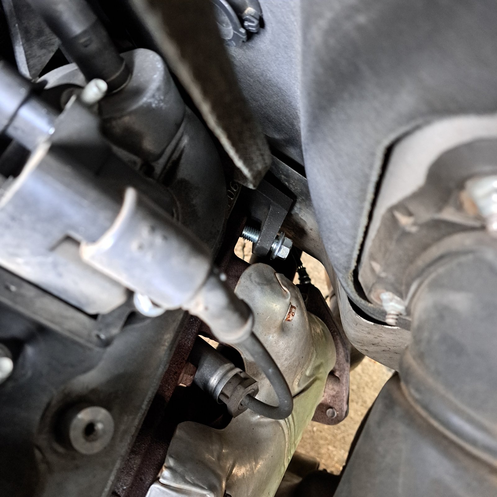

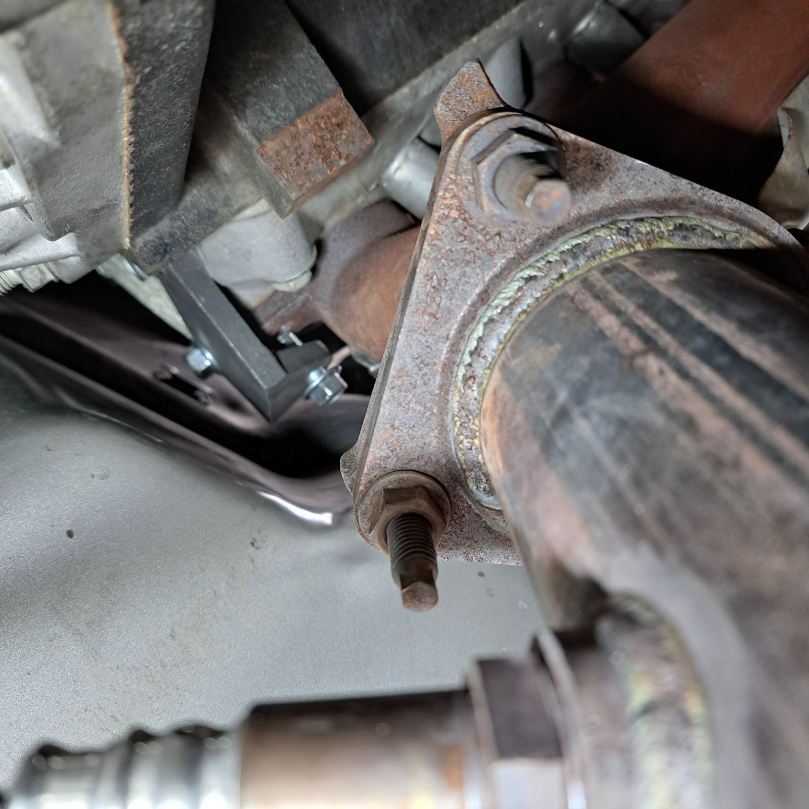

Once I got home from the interview and talked to my girl about why I was not taking the job and she was happy and then told me to quit moping around and do something on her truck or my Tahoe. Yesterday I did the door drip rail seals on her truck and I had the Dorman exhaust manifold clamp for the driver's side rear, of Tahoe, and decided to do it. It was a bit of a PITA. Took me 1.5 hours on my back while it was on jack stands. Removed the firewall heat shield and disconnected the front driveshaft and moved out of the way. Still very tight quarters. The lower bolt at back of head is easiest to get to while having the bolt in the bracket hole and finding the threaded hole while holding bolt and bracket with one hand. The top hole has less room but is easier to swing the bracket in to position and find the hole and get a couple threads started. Then you just hold your tongue right and thread bolts in with tips of fingers because there is not enough room to hold your palm back and reach with fingers to thread easier. I tightened down till the bracket was snug and then threaded in the bolt that goes in to threaded hole and ends up pushing the manifold tight. Then I used ratcheting wrenches and again held the tongue right and tightened all down but you really have no room for leverage to tighten very much. I then got an offset long wrench and was able to tighten down quite tight. The bracket bolts are 14mm, the firewall heat shield is 10mm and the 4 bolts at the driveshaft are 11mm. Only damaged the right hand in two places and most of this was done blind because you cannot see past your arm and hand.

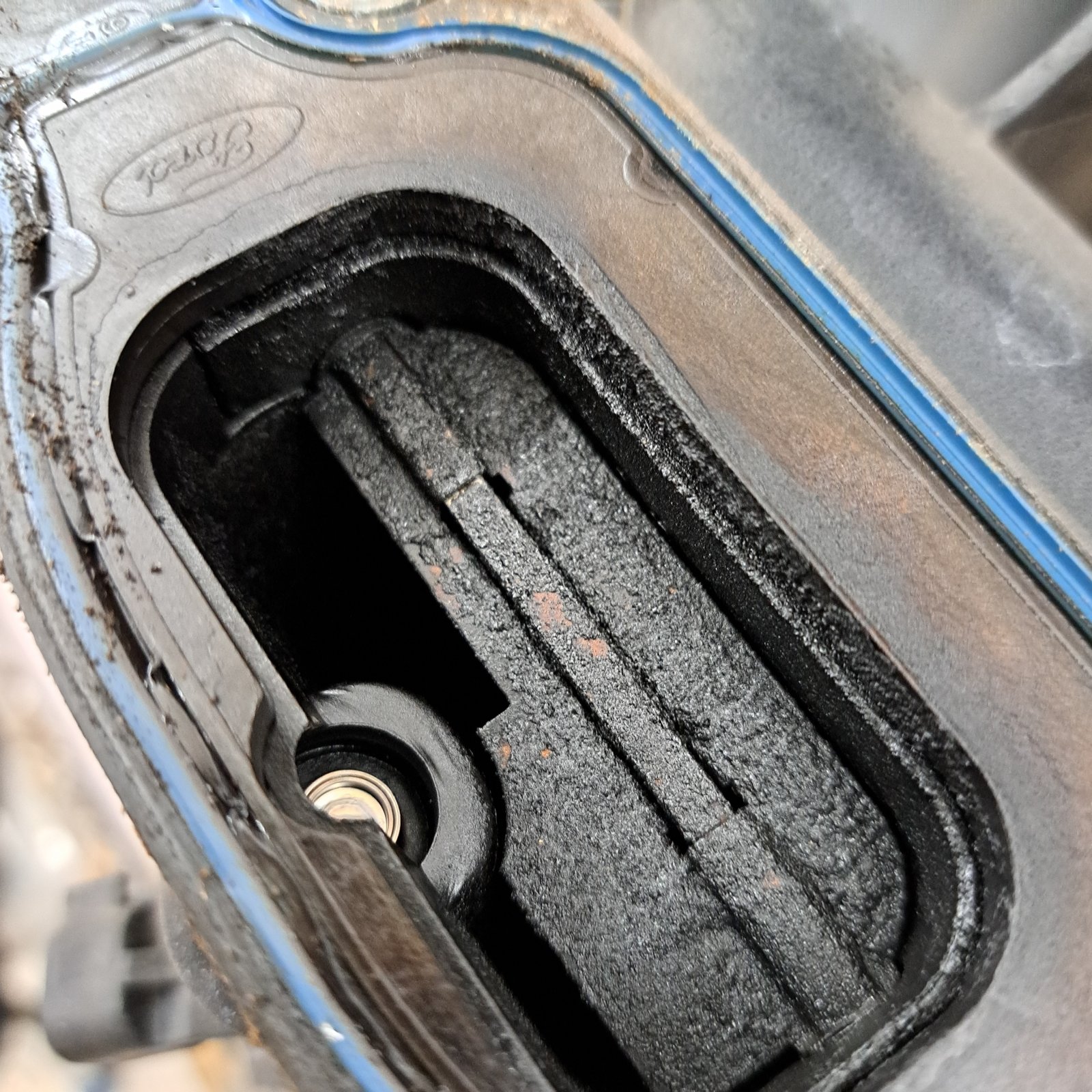

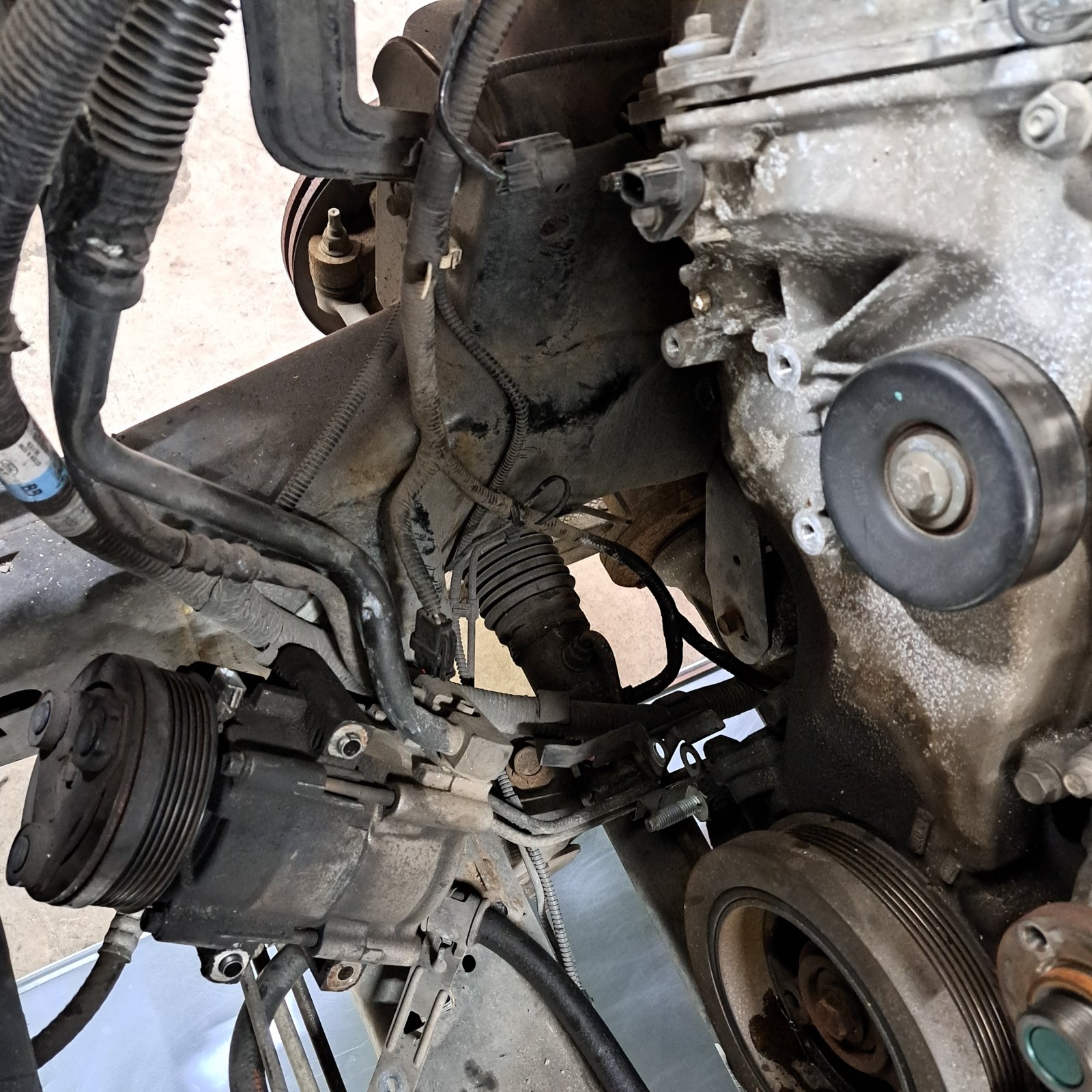

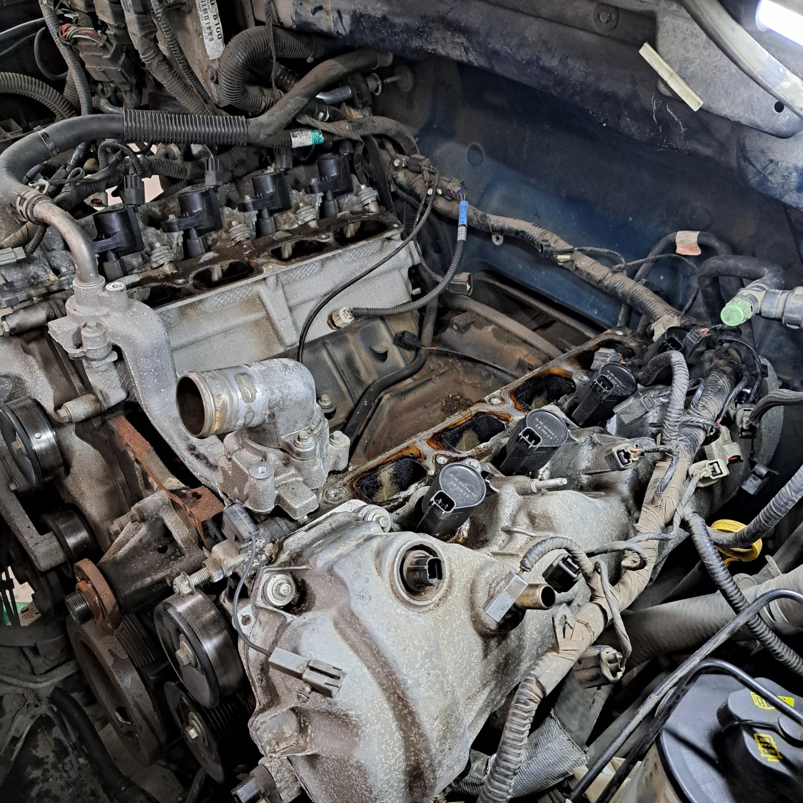

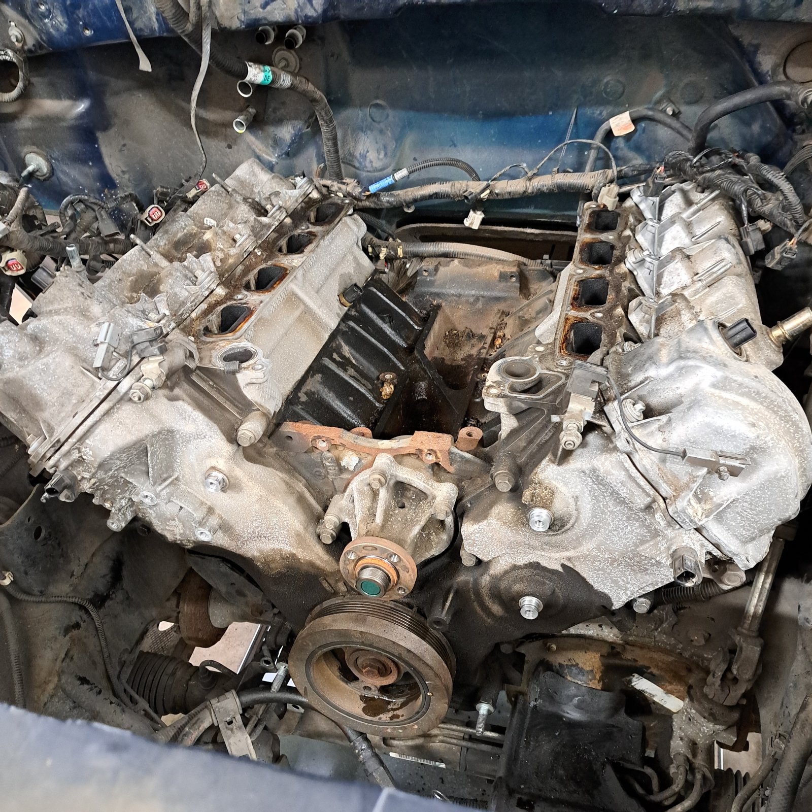

First day turning wrenches in the shop in Junction City, Or. The 2006 F150 4x4 5.4 engine is being replaced and the transmission rebuilt with a new torque converter. I started at 10 am and stopped at 1 pm. Bagged and tagged the fasteners as I tore down and will be doing a cleanup on components that will be reused. Look at the flapper plates for the intake. I shot pics of all 4 on d/s and the other 4 looked the same. We are getting a new intake and actuator for the plates. This is getting many new parts as we go: Throttle body, radiator, fan blade and clutch, injectors, plugs, ignition coils are less than 6 months old-I installed them a while back for a misfire code, all mounts, belt, tensioner, idler, water pump, new reman FORD engine, oxygen sensors, a/c condenser, trans cooler, knock sensors, cam and crank sensors, receiver drier, hoses, accumulator, flushed a/c system, new transmission cooler lines, temp sender and sensor, MAF, purge valve, fuel filter, fuel pressure sensor and I am sure I have forgotten some things....Plus, he did some training with me on the shop management program and writing tickets the way they want and working on entering info in computer and finalizing tickets and billing out. Seems like will work great but I am just playing it by ear for now.

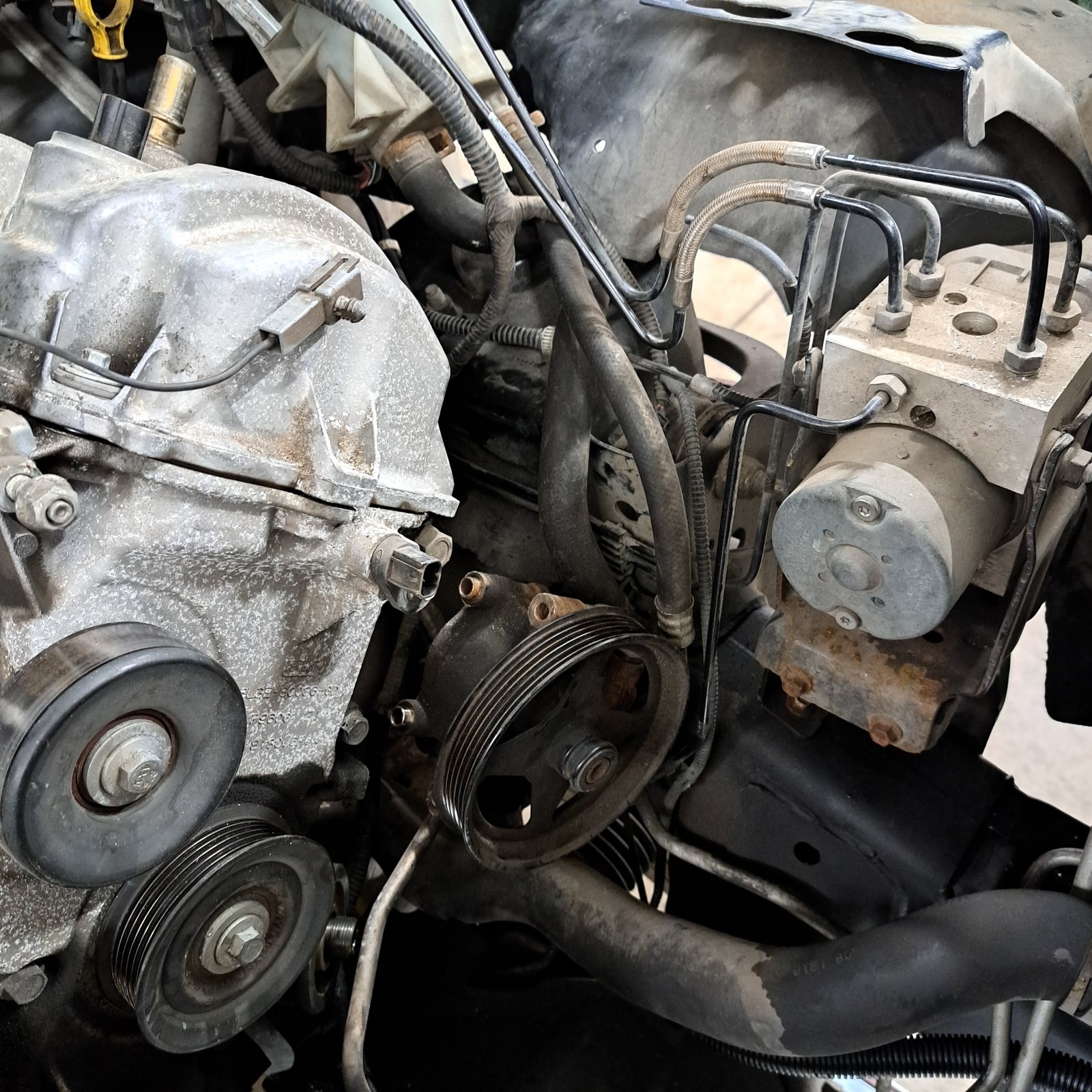

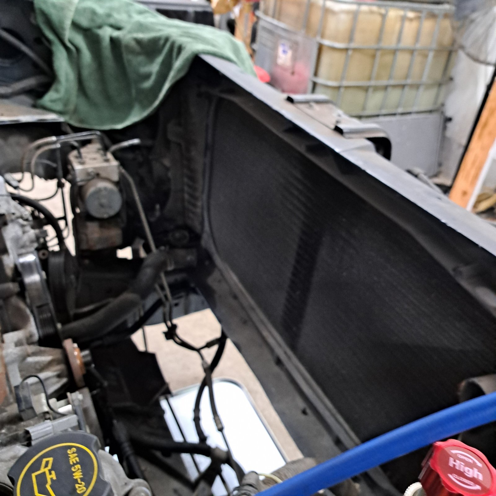

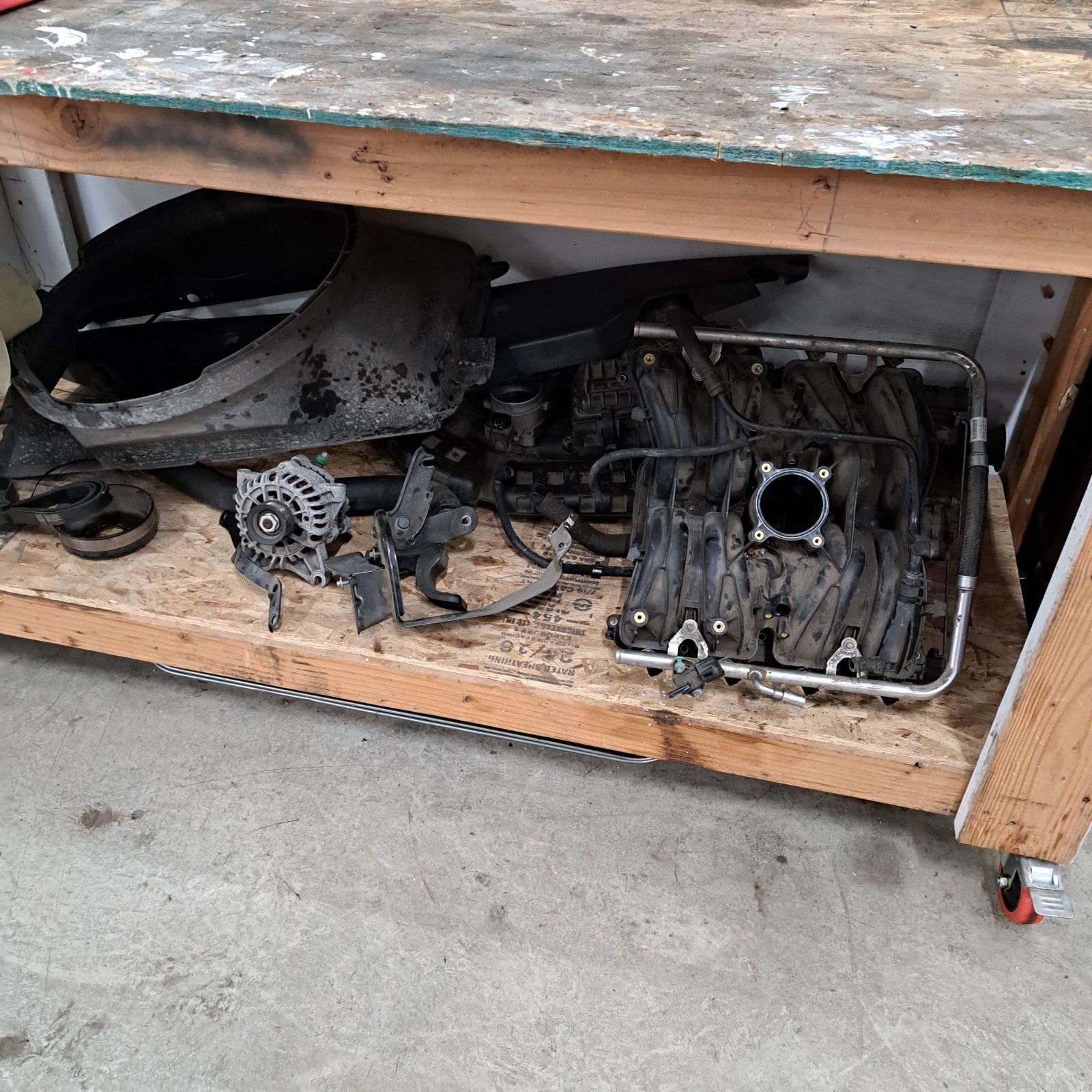

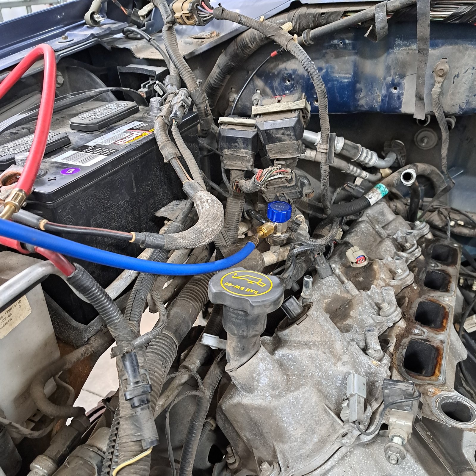

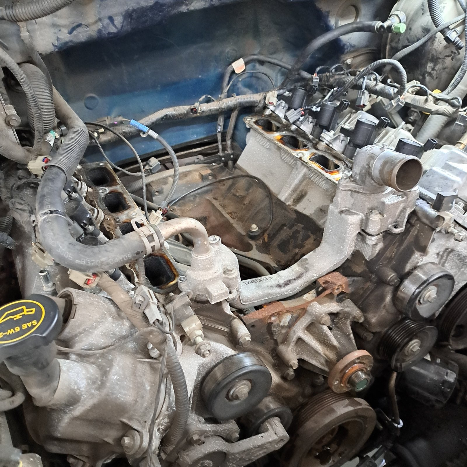

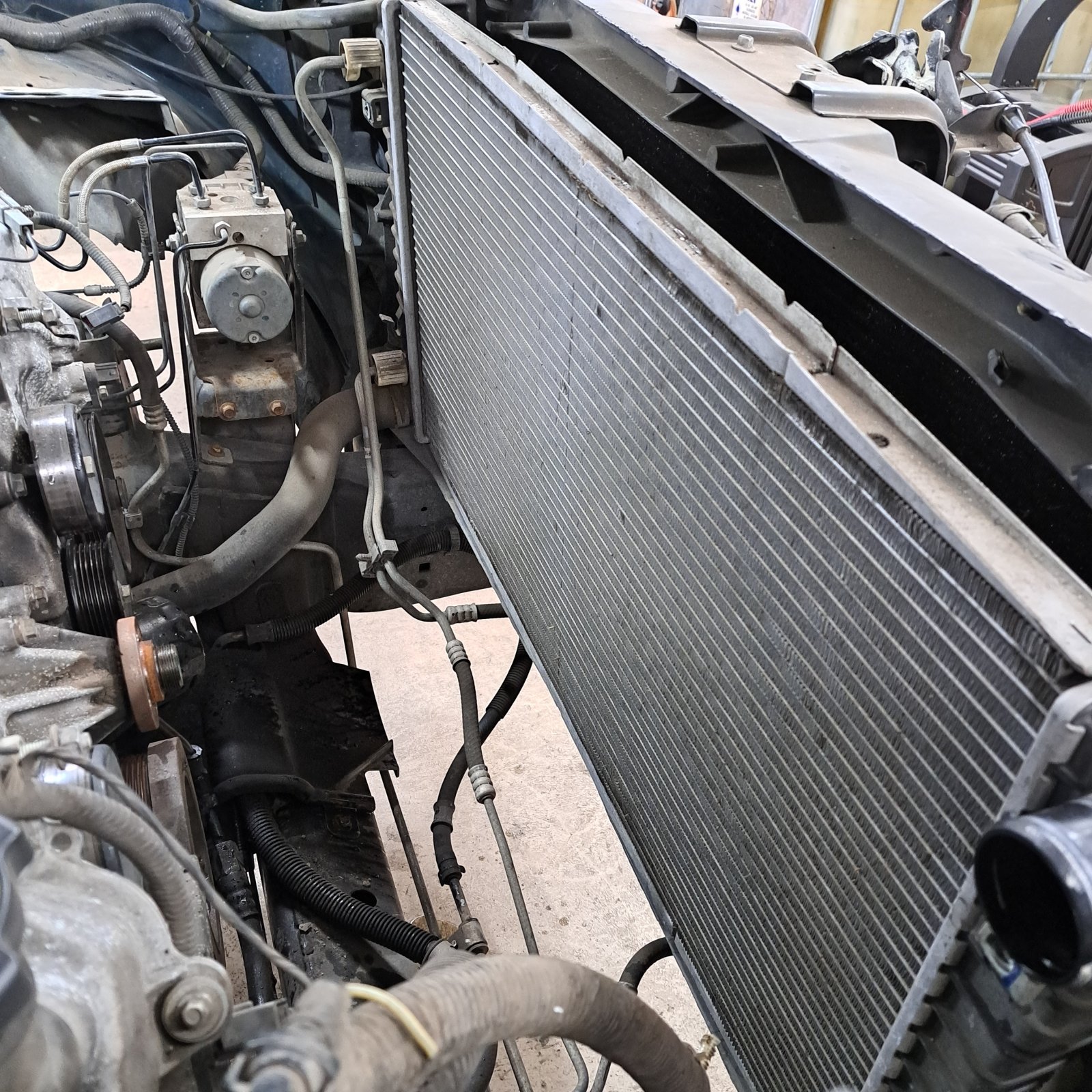

Back to work on the 2006 F150 engine and transmission swap today. Worked from 9:30 to 2:30. Removed: ignition coils, tensioner, thermostat housing/crossover housing, wiper arms and upper cowling, engine bay engine power control module and bracket, radiator, both heater hoses from the heater core tubes, finished removing harness connections for engine and a/c compressor, drained a/c system, had to hand wrench 6 mounting bolts for the a/c compressor and p/s pump-no room, rear ground strap and coolant tube mount stud at back of engine, hood coming off tomorrow and unhooking the motor mounts, pulling new engine out of Ford engine crate pod and mounting on engine stand and setting the old engine in the pod after exhaust manifold removal. Then parts swap and new parts installed that can be done ahead of time. Will clean out engine bay and prep for new engine install. Sorry, no pics today of all this but will get them in the morning when I get there.

Ok, the 2006 F150 is completely ready to have the engine jerked out. motor mounts undone, harnesses bungy corded back out of the way, flexplate off, oil dipstick pulled out, a/c accumulator removed and compressor is completely out, the condenser is out but I have no pic of that, battery and tray removed and then we discovered that the engine picker does not have a long enough arm to get the new engine out of the shipping pod so we can mount to the engine stand. Gy in a business next door has a fork lift but was not there. Some day next week, will get new engine out and mounted to engine stand and pull old engine and drop in the engine pod for core return. I will swap the exhaust manifolds over and whatever other parts I can install on the stand and then the fork lift will be back to drop the new engine in. I cut my middle knuckle on my left hand first thing this morning.
