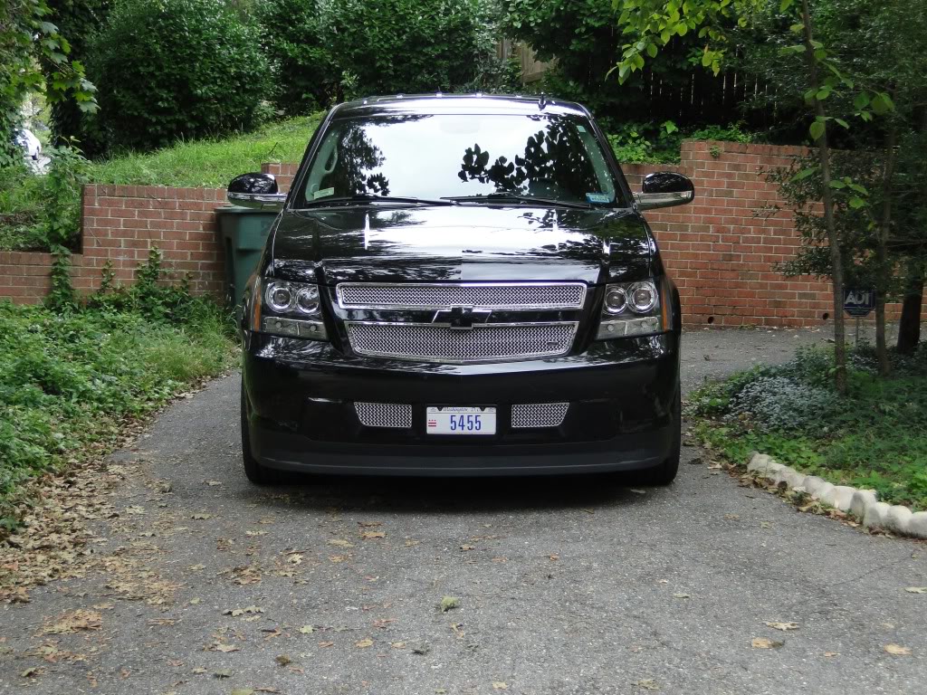

You will need:
1. Hybrid bumper cover
2. Hybrid Hood
3. Hybrid hood liner
4. Hybrid black plastic grilles and associated hardware ... you can later add the Grillcraft overlay grilles like I did if you want the LTZ look:
Usually the ones I've seen for sale on ebay have the entire bumper assy together, including all the lower and upper grilles, plastic fog caps and valance. That would be the preferable way to go so you don't have to track down every single minute part.
The attachment points (so far as I can tell) are exactly the same on all the trucks, for example my Denali bumper attaches at the same points (and same brackets) as on my tahoe hybrid. There might be one or two small screw differences, but not enough to affect the integrity of the bumper.
Cooling won't be affected ... the Hybrid has a 6.0 which presumably requires more cooling that the 5.3.
The hybrid bumper does have two removable plastic caps at the bottom of it (where you see little square grilles on the above pic) ... the fogs definitely don't line up with them and have to be removed. There might be a way to rig them to relocate them on that spot to retain the fogs, I just never went far enough with this process to know. Those lower gaps in the hybrid bumper seem to line up pretty close to the regular tahoe tow hooks, but again you'll have to learn as you go cause I just don't know. One thing is for sure, as there are only two gaps you can't retain both hooks and fogs, and the likelihood is that you won't be able to retain either.
Hope all that helps a little. :)
