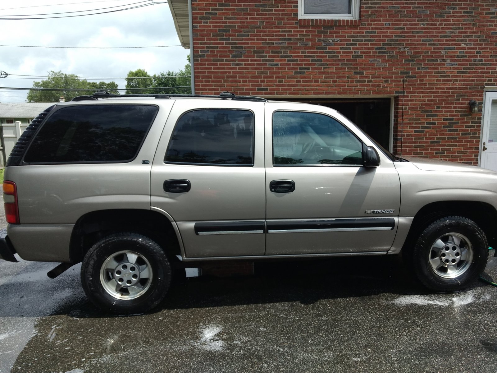

Going to register the Tahoe today after motor swap and go for a shakedown run. during swap I noticed the trans pan was a bit wet. looks to definitely be pan gasket. I ordered new gasket and filter kit and new fluid. I'll take care of that next weekend.

What was the swap to? Any mods? Sure it was trans fluid not oil? Looks great

Just a straight swap from my Suburban to Tahoe which I bought with a motor that had quite a few collapsed lifters at 158K, my Suburban ran great just body too rusty. no mods really. I did however installed a new Melling stock replacement oil pump and a new Cloyes Timing chain set. also all new gaskets and seals. definitely transmission fluid. my seals on the suburban motor were all dry. the only weep was oil cooler clock off plate gasket.
