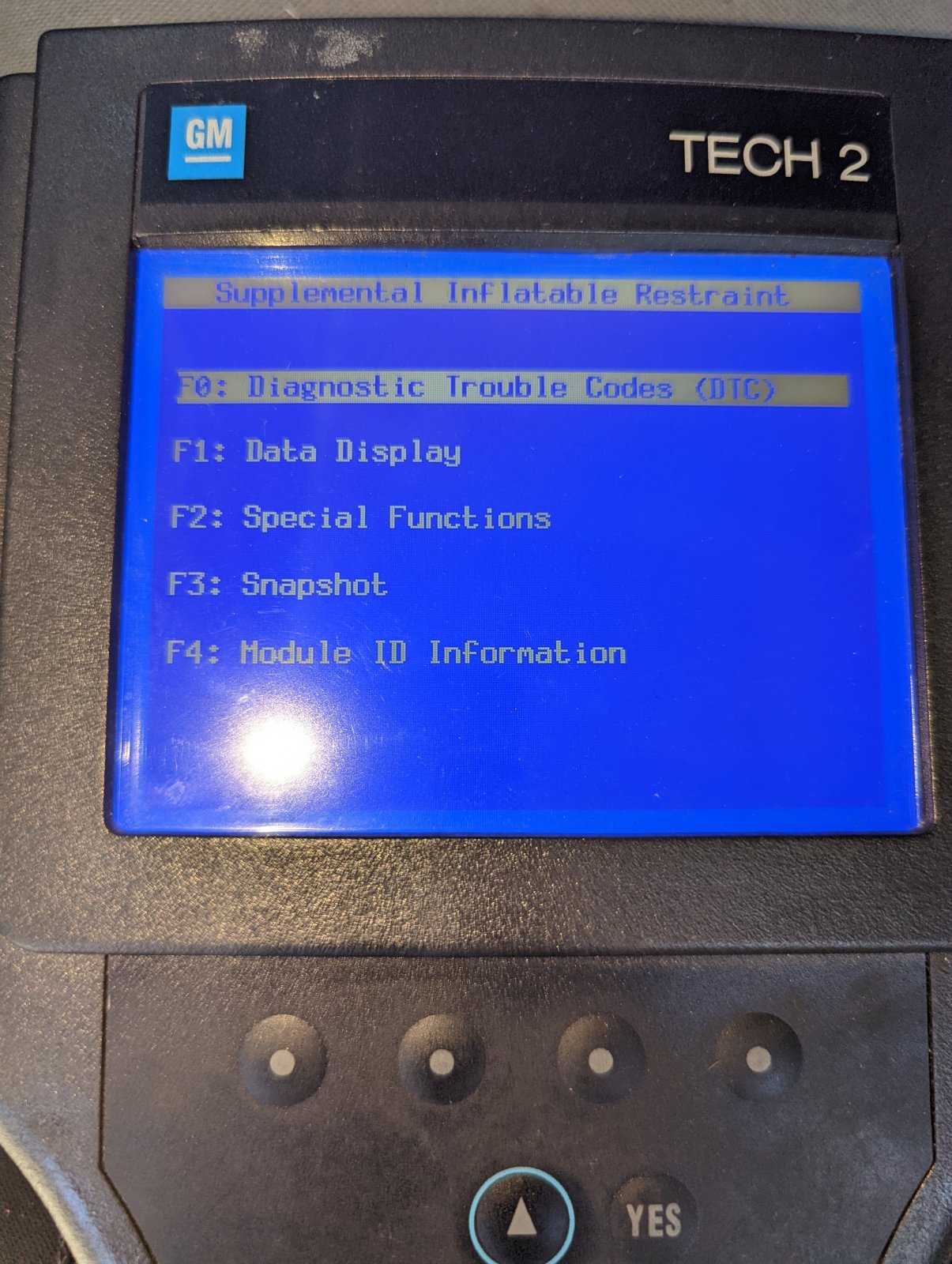

Finally got a VCXNano up and running and have the unit connecting to the truck to retrieve data. I want to change out the airbag module under the drivers seat due to SRS codes - the unit was badly corroded after the interior floor got wet this winter (hole in the floor has been patched). I have another used unit that I want to change out but I was under the impression that I would have to do a VIN relearn with the new unit after plugging it in. I have navigated the Supplemental Restraint menu on the Tech2 software and I can't find anything of the sort - would it be under the BCM menu or somewhere else?

I looked in both of those menus with the ignition in position 2 (run) and didn’t see it anywhere

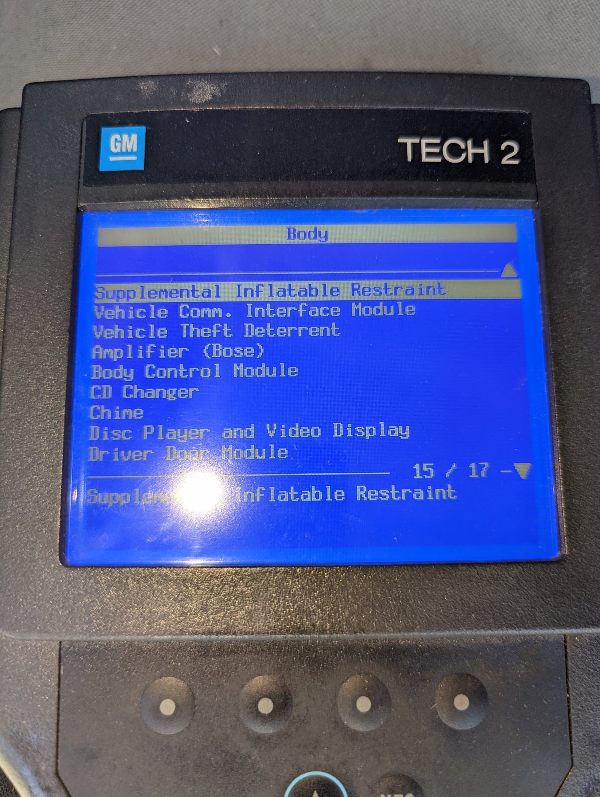

Should be under body and supplemental inflatable restraint

Ya it only does it once and it has to be installed already duh..lol
My bad. Didn’t want to get too far ahead of myself and install the new module before I knew how to reprogram it. Thanks for the heads up.
30,752
48,443
you won't hurt anything putting it in there, and it won't do the re-learn if there is nothing there to re-learn, the airbag light would just stay on until the re-learn is performed.
