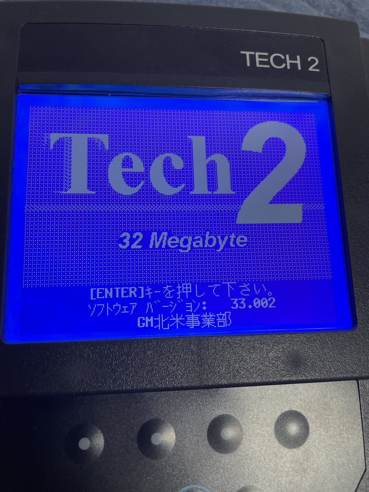

Diagnose when connecting to a car, erase DIC, freeze when starting live from diagnosis.
Same symptoms all the time.

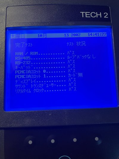

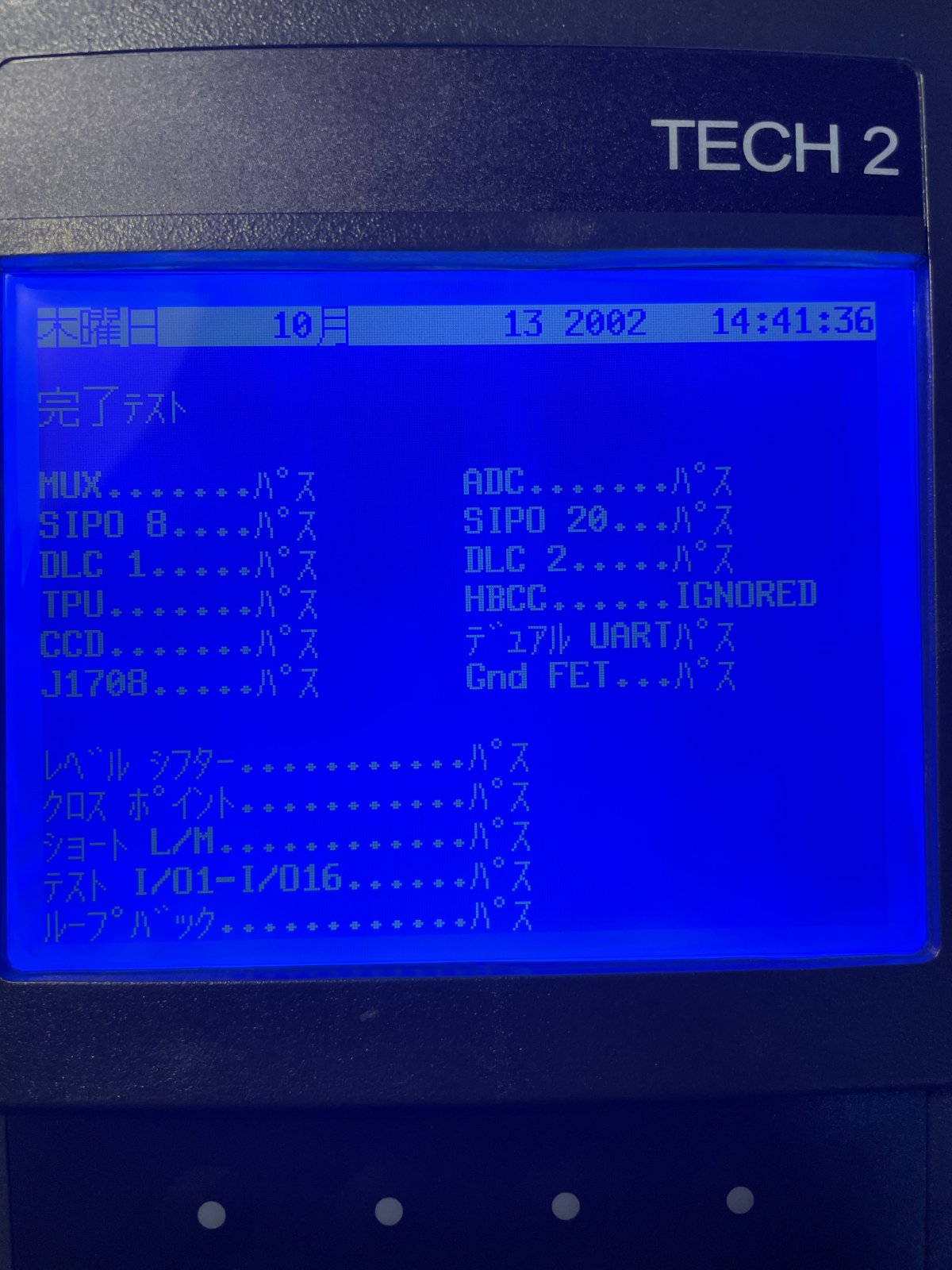

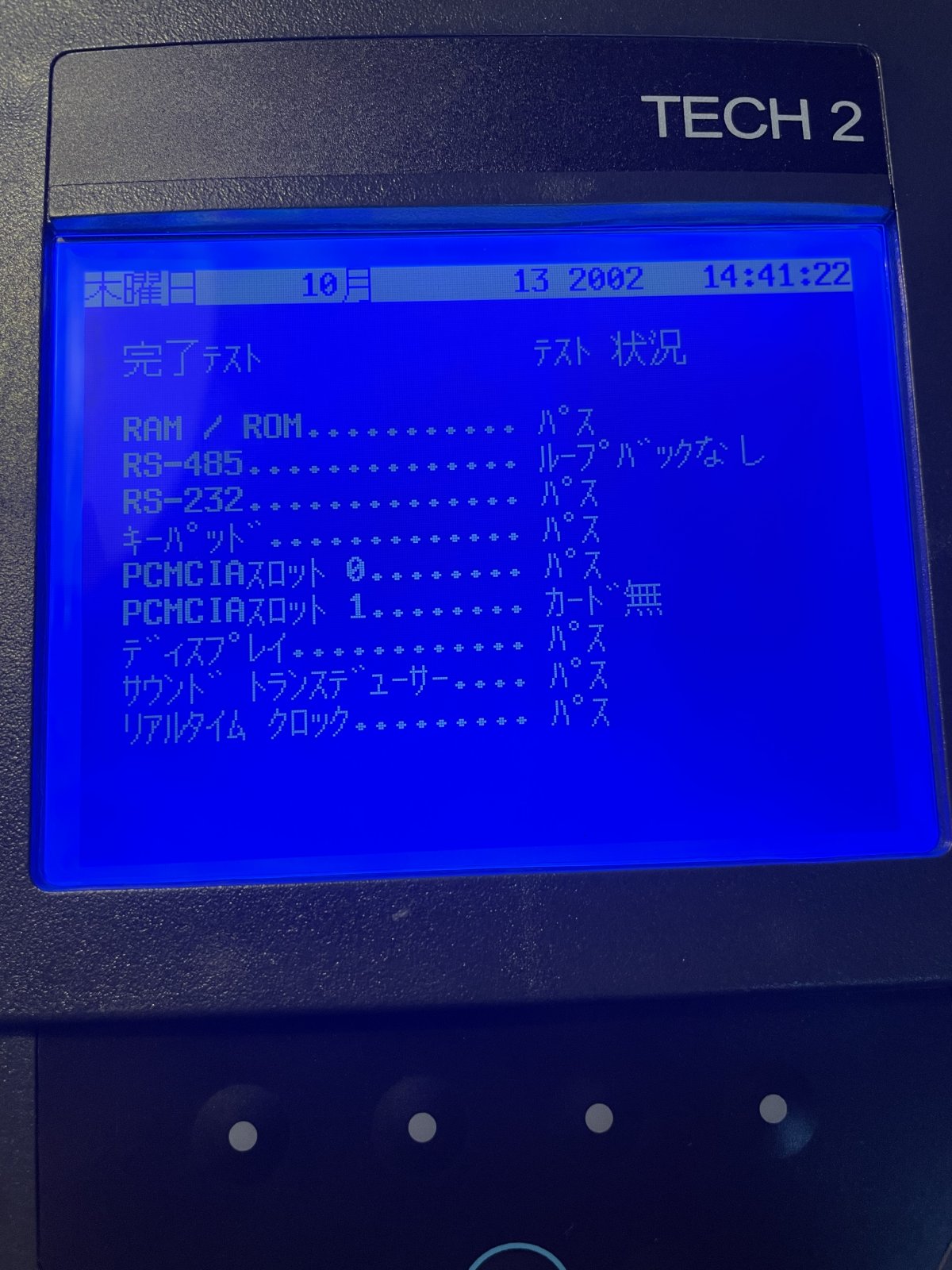

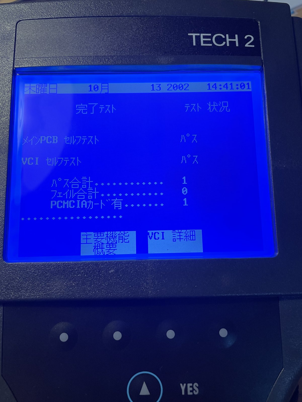

Self test performed Tech2 and Candi module, but no problem was displayed.

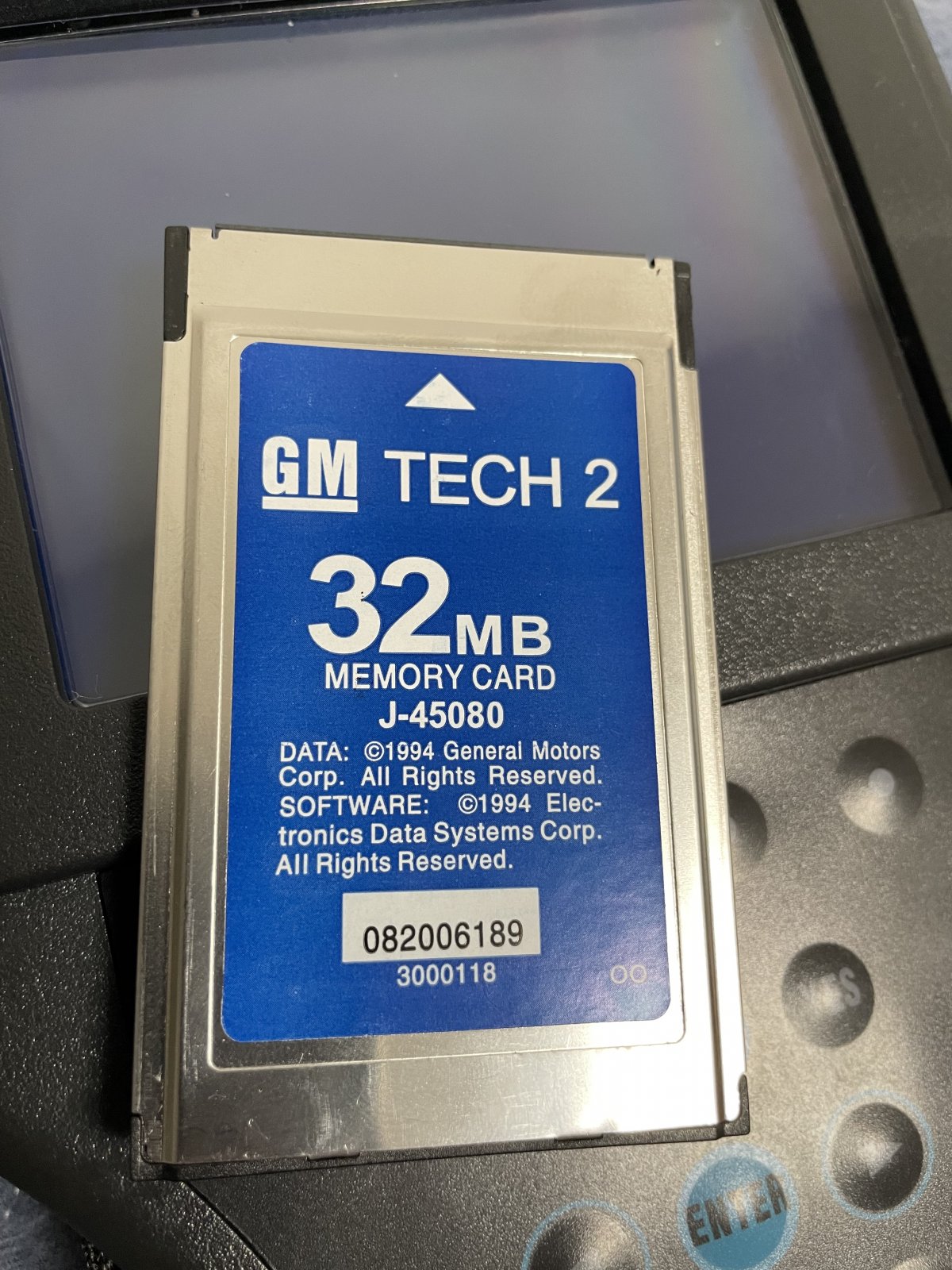

VCI and 32mb card are also recognized in self test.
VCI and 32mb cards have been removed and reinserted many times.

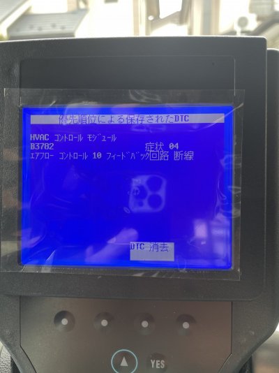

The key position is in the ignition position with the Tech2 connected to the vehicle.
Sometimes I turn on the engine, but it freezes no matter how many times I try.
It often freezes on screens with softkeys.

Two problems. First, you have the wrong card as George and Joe said. Second, the Tech-2 does indeed freeze up when you go and start the engine with it on. This may be a feature of all Tech-2 or just the clones, I don't know.

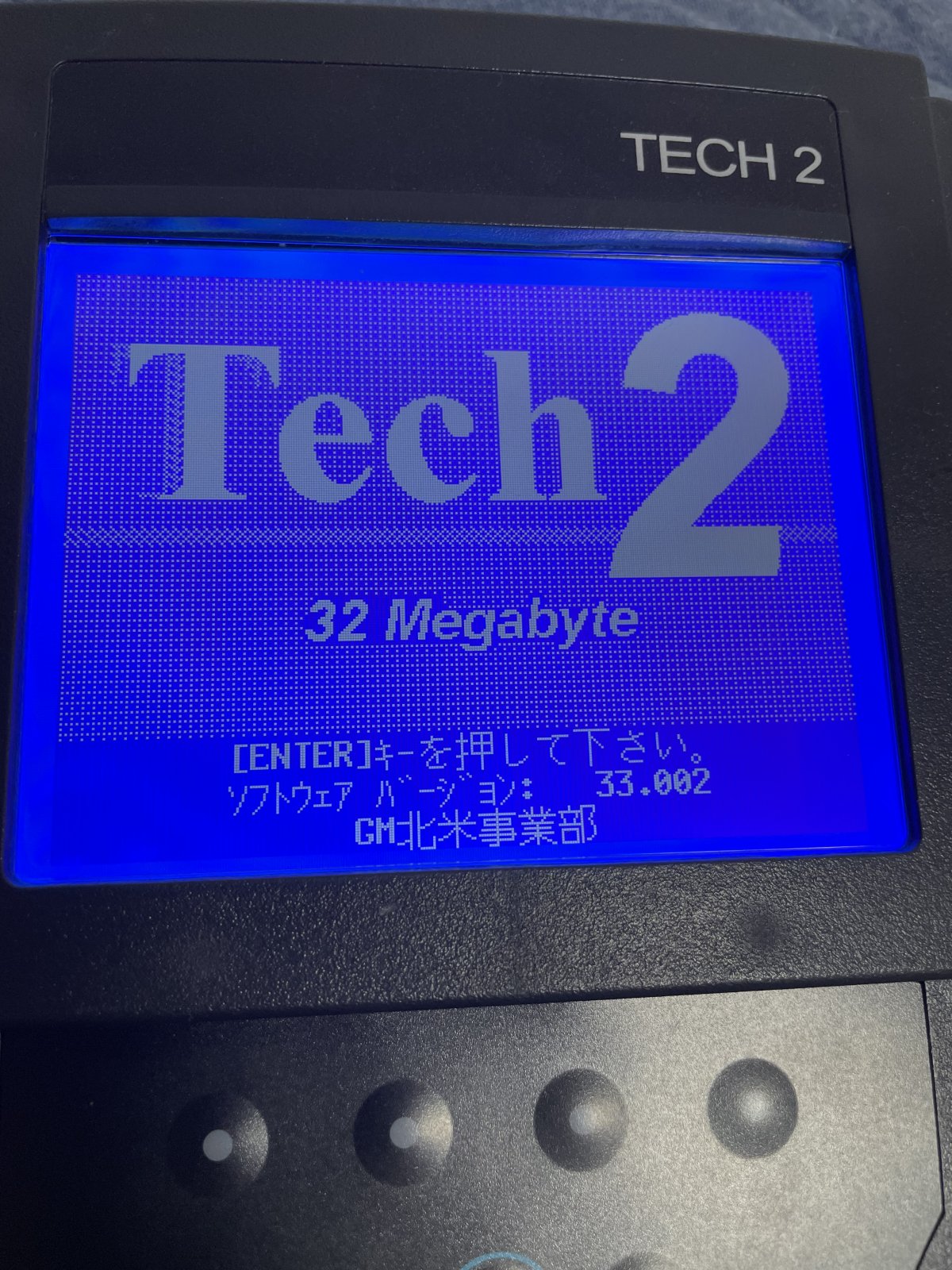

I'm confused by all of the non-English characters. I get absolutely none of those on my Tech2, ever. Do you have the correct language card?
I hurriedly ordered a new English card. I didn't think other languages would cause trouble. I assumed it was a hardware problem.
I am happy with your answers. I understand that you are using the wrong card. I ordered an English card.
