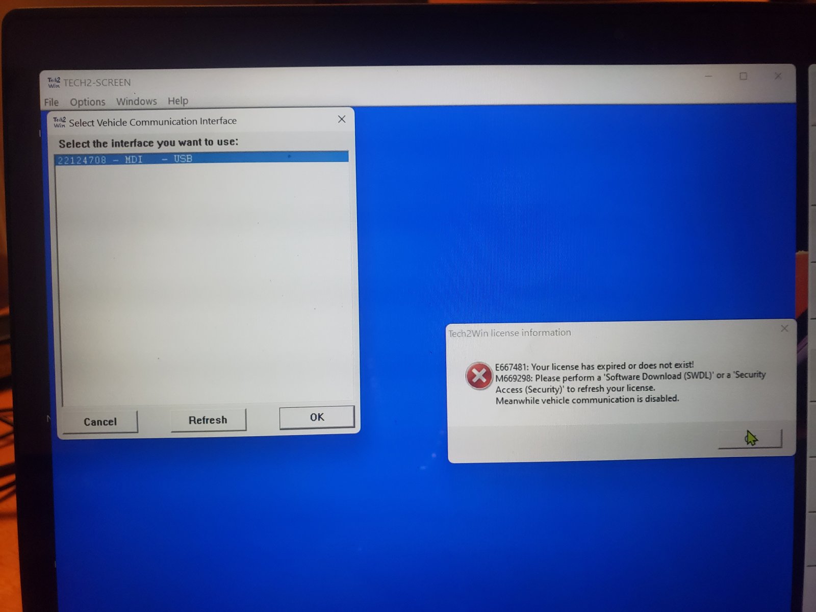

I Uninstalled everything and started over. Still getting this message when i open tech2win. I can see the vcx nano connected on vx manager. What am i missing?
And now this doing more digging within my pc system settings
exp500
May 14, 2017
2,026
1,985
Com port 5 message. Need to check which are active and which is in use. Then compare drivers. Windows has never been good at selecting drivers automatically. You have to give it the right one.

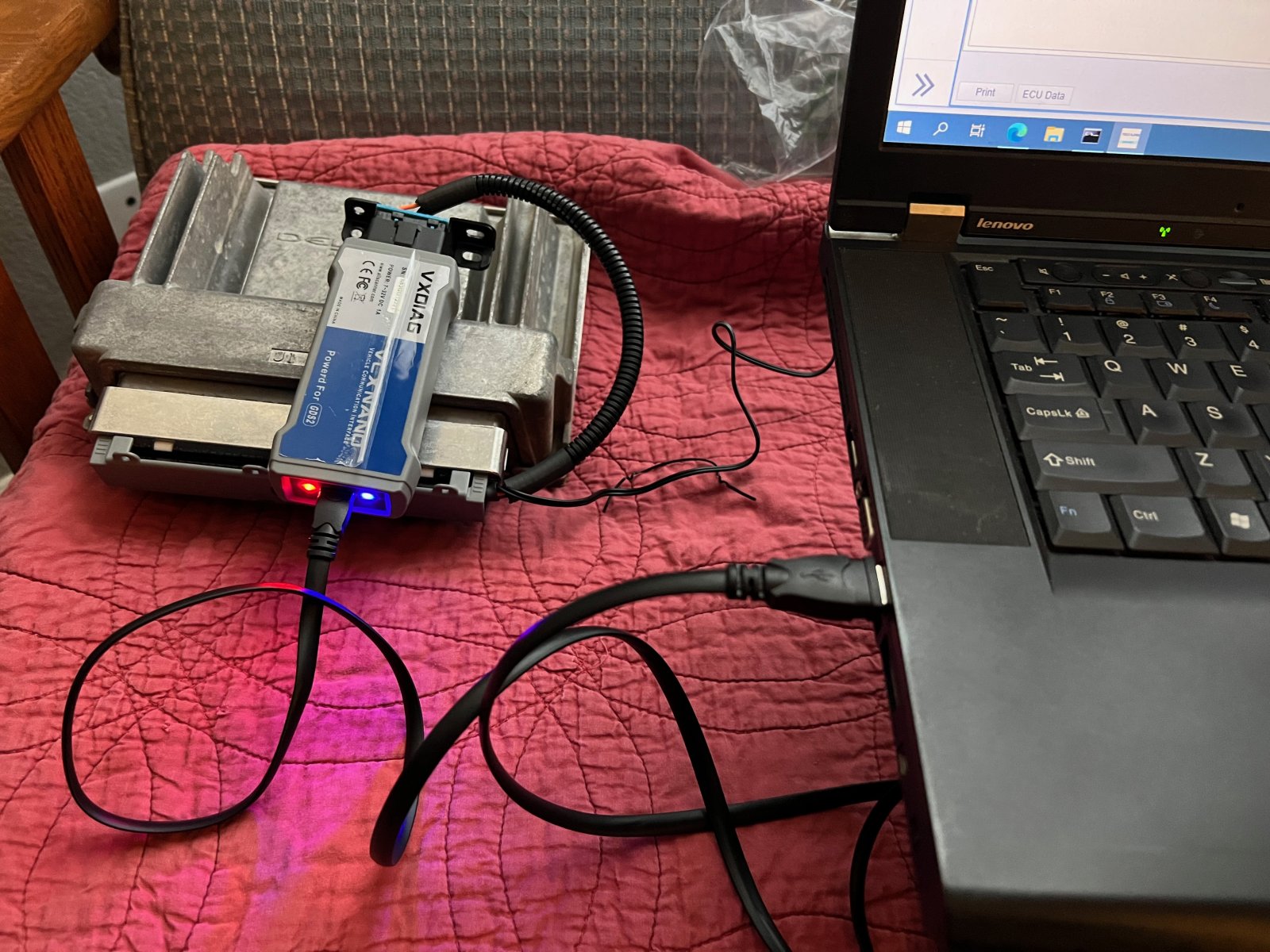

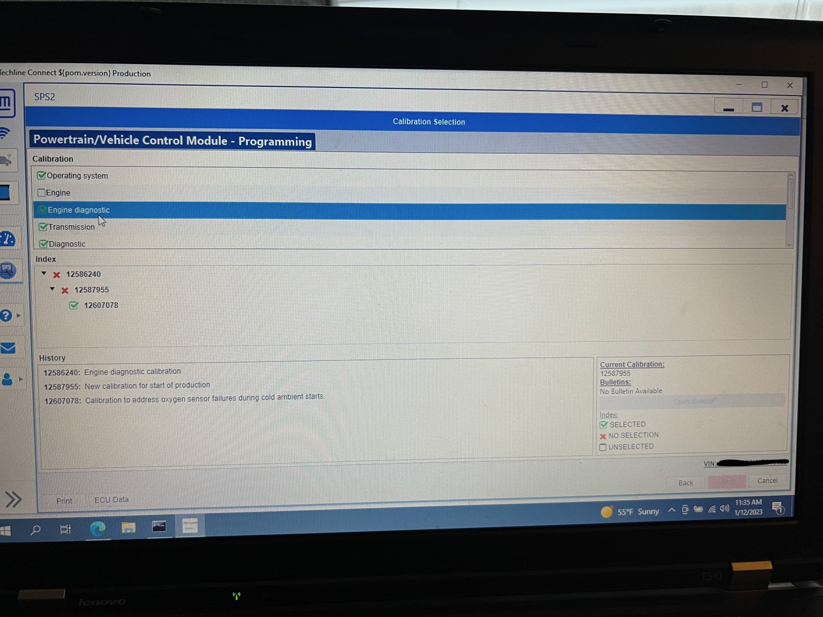

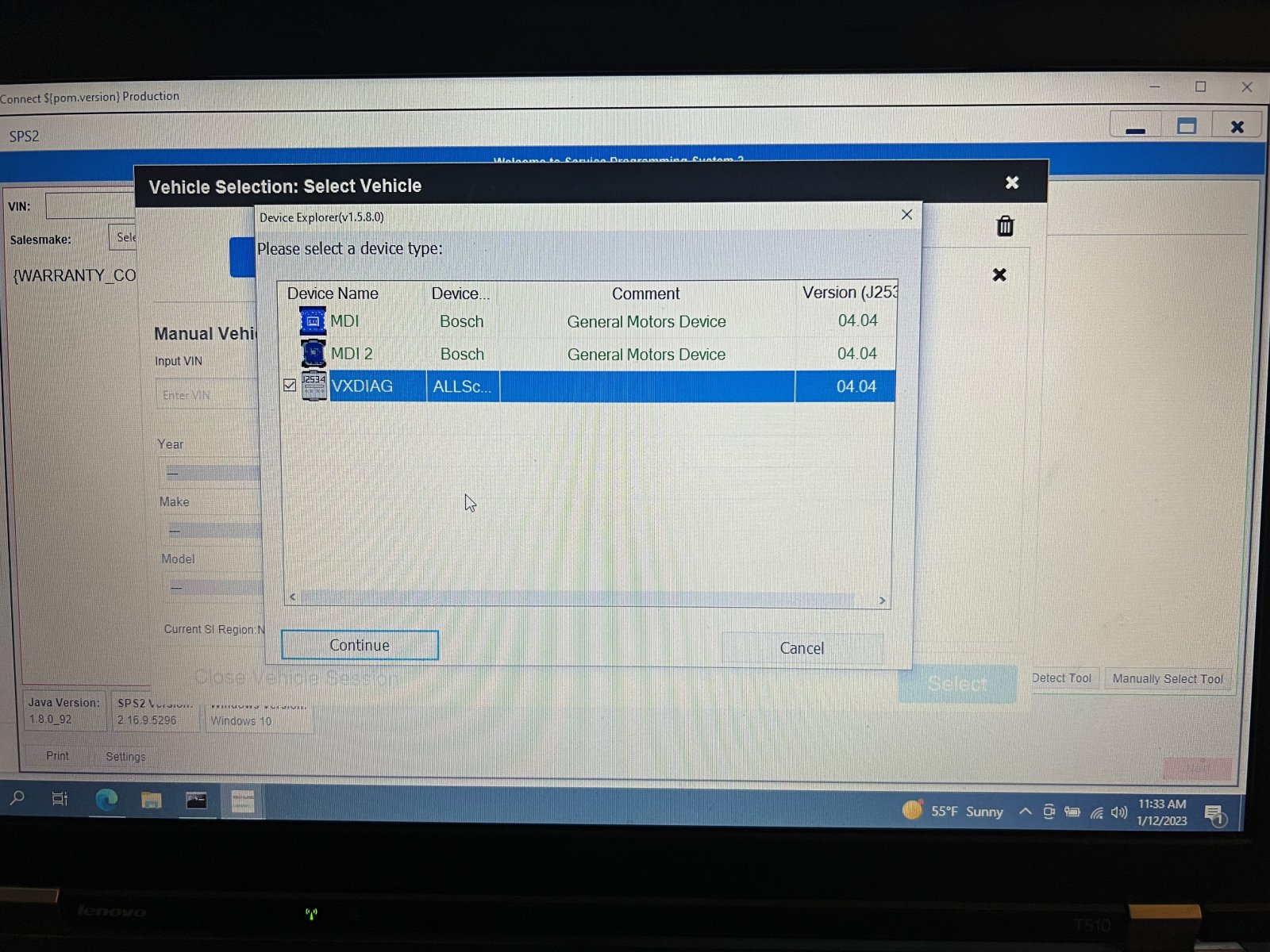

I used an old Lenovo T-510.
Installed windows 10 64 bit.
Installed java 8 32 bit.
Installed VCX Manager.
Installed Techline Connect directly from AC Delco TDS website launcher.
Can program in vehicle or via bench harness.
No VMWare.
