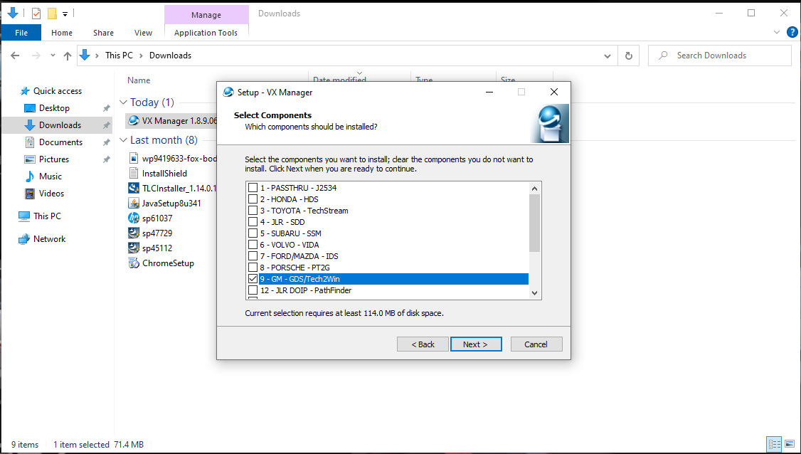

First thing - download VX manager from here and install - be sure to select GM option (see pic) https://mega.nz/file/udohRDTb#xrt4ui1A2yh0GnOWHPmm2jsAdD7PU3G7vcU2K3tCtYA

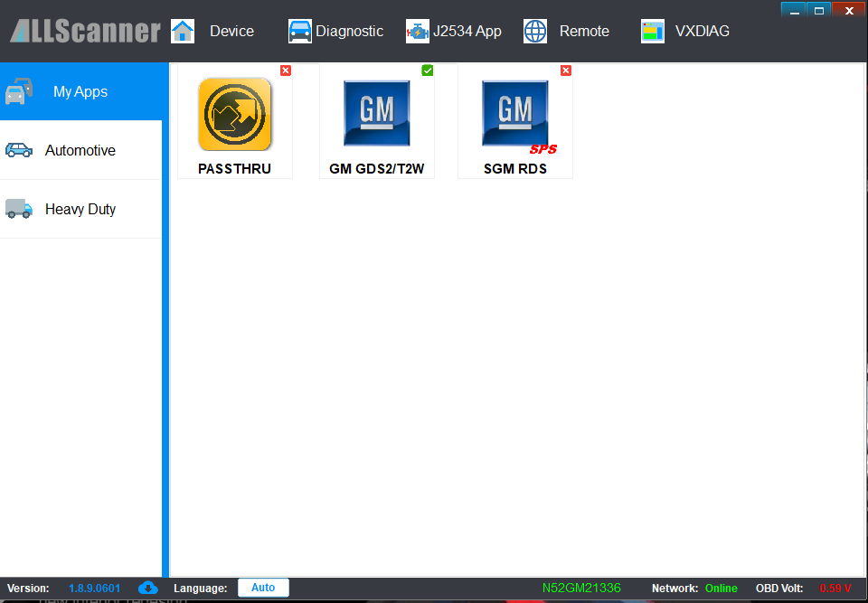

Complete the install using the default settings. Before installing the Diag modules - install TLC (version 1.14.0.1 or most current) which is the Techline Connect suite from ACDelco TDS. You must have an account which is $45 per VIN to get into the SPS2 services website. Once the TLC suite is installed, go back to the VX Manager application previously installed and go to the Diagnostics tab (ensure the VCX Nano is connected to your computer via supplied USB cable) and install the following tools.

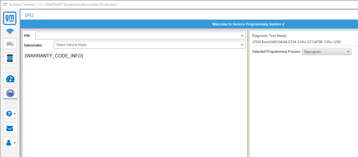

Once these app have been installed, log back into acdelcotds.com website, add vin, and launch techline connect via webpage. The SPS2 site will now see your VCX Nano as a GM MDI device which allows communication with your vehicle systems. As you can see in the pic below - the device is detected as a J2534 Bosch MDI device.

First thing - download VX manager from here and install - be sure to select GM option (see pic) https://mega.nz/file/udohRDTb#xrt4ui1A2yh0GnOWHPmm2jsAdD7PU3G7vcU2K3tCtYAView attachment 377461
