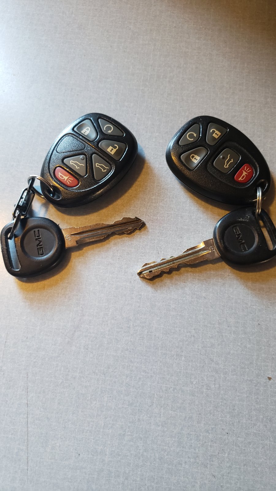

Yup, seperate key and fob.
Left is 2012 Yukon Denali key and fob
Right is 2015 Acadia Denali key and fob
We've only had the Acadia for not even 2 years yet and I'm wanting to get a diagnostic tool with two way communication for it. I have an OBDLink MX+ and Torque Pro app I can pull trouble codes with and see a lot of data, but I want a "Tech2" type of equivalent hardware to be able to use on it when needed.

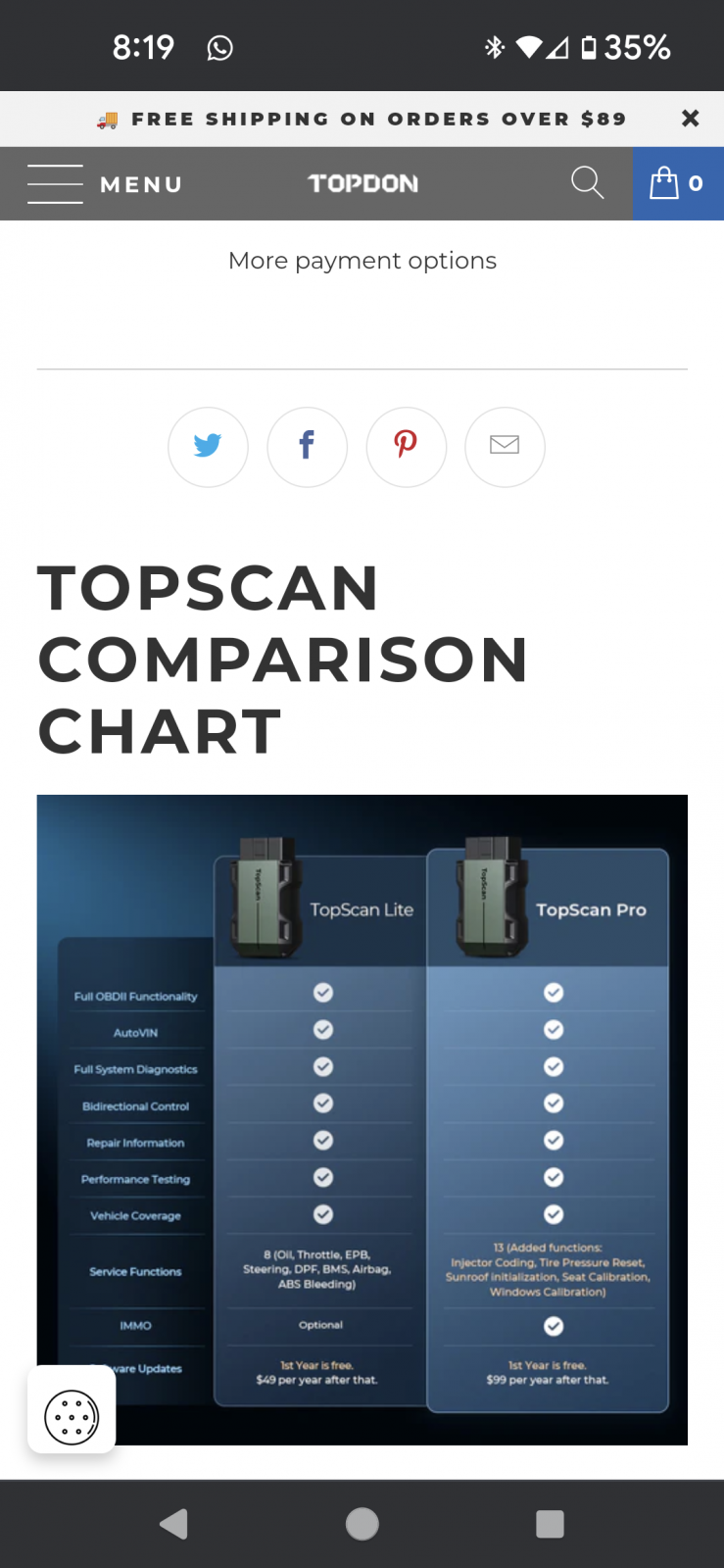

so I've got this little topscan Bluetooth reader I picked up, I really like it actually. I use it a lot at work over the crazy priced oem stuff we have.

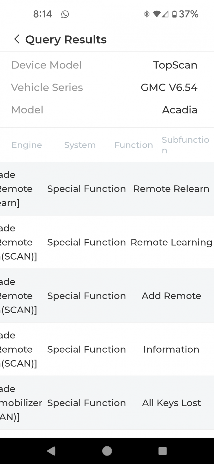

so anyways, it had a coverage tab in the app, you can input your car/truck and it will show you what it can do. now I have the 50$ lite version and it doesn't show remote stuff for a 2015 acadia but if I change the drop down box to the pro immo onr. it brings up this.
now since Amazon doesn't list this pro version, you'd have to buy it from them with no real guarantee it would do it and probably not a easy return. be worth sending them an email to confirm it's the fob and not the easier key.
I find it super handy so I'll probably renew mine in a year but the only real downside is since it's app based it comes with a years access, after a year they want you to update the subscription, which sadly is the same price as the dongle. I'm not sure if the app doesn't works at all, or if it just stops updating. so I don't know if it's something you want to deal with. the clone tech 2 is nice cause it just lays there and then works the same when you need it no matter what.
but I do find it super handy but I also use it about once a week.
