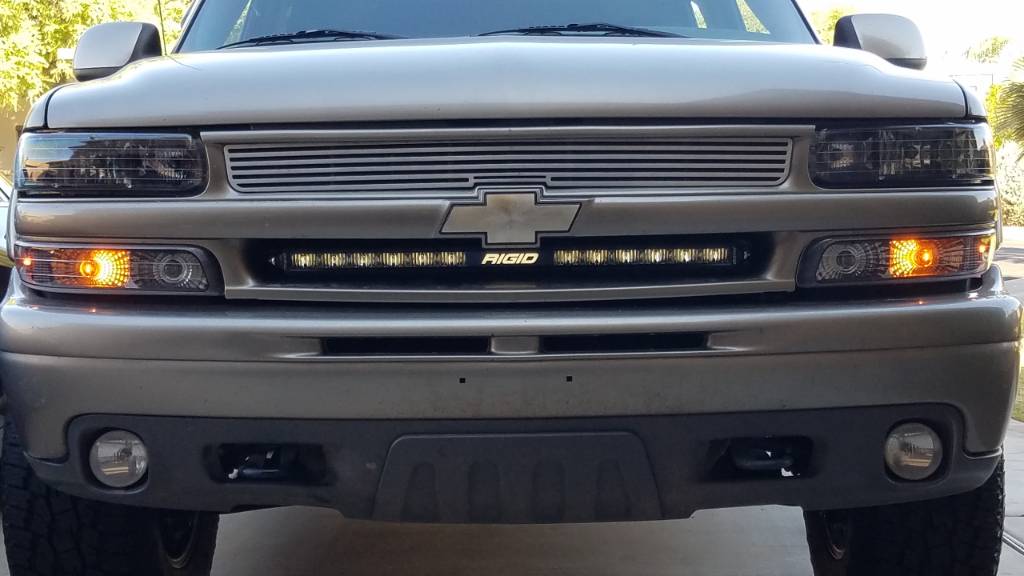

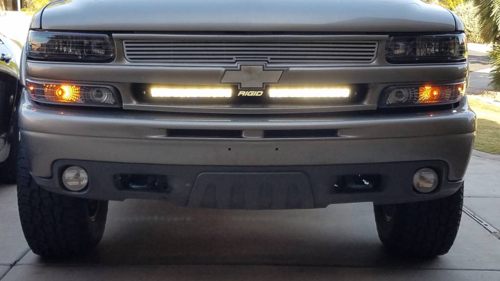

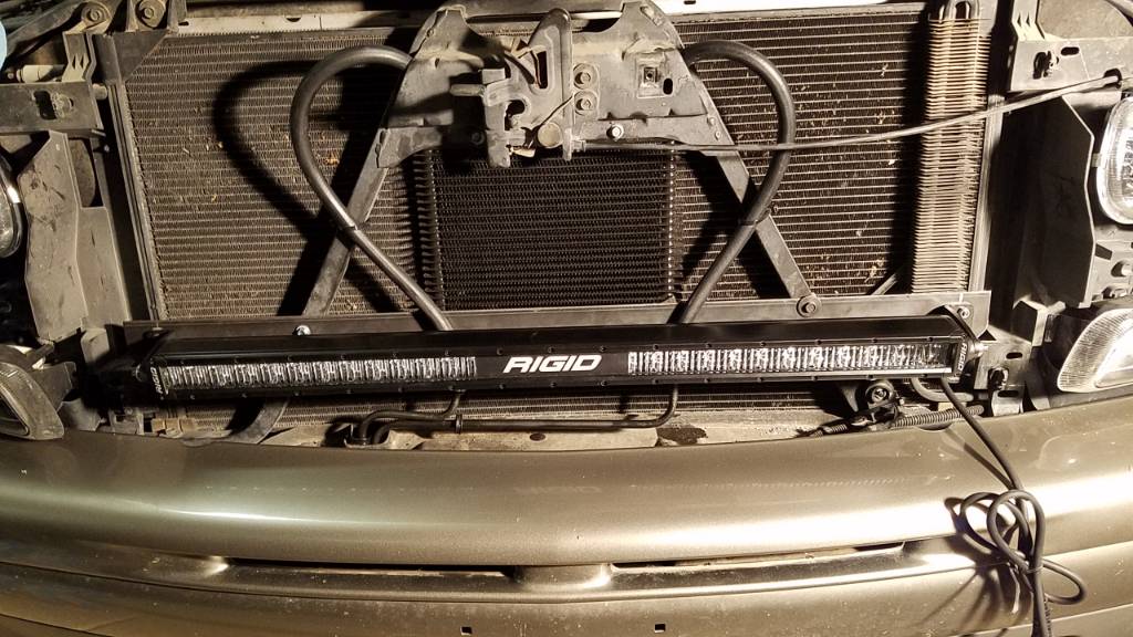

Trying to get my forward projecting light performance up to *****!!
When the factory headlamps got so hazy I couldn't polish them out anymore - I bought some cheaper DNA headlight assemblies (Amazon) a few months back, and have not been happy with the build quality or performance. (They look great, however!)
Just ordered a set of Depos after reading most of this thread. :) i will probably opt for LEDs - and will post some pics when complete.
For now, I installed a 30" RIGID SAE/DOT single row lightbar in the front grille to provide some auxiliary lighting when needed...

Looks good. But now you have to add another up top or paint the upper billet insert black to match :hmm:
It's easy enough to unbolt it. But i had to get on the road!
Now you got me thinking.. i have a pair of 10" single rows that need a home.. :)
