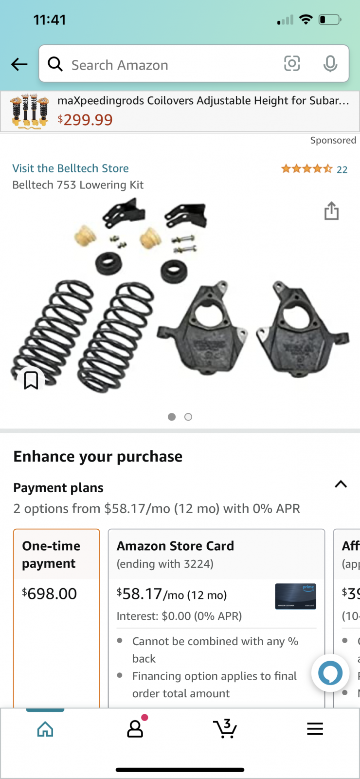

Your right. That makes sense. You know after researching all of this I am now thinking that if I’m about to shell out 800 on new suspension components I could just lower it instead. There’s a Belltech kit for 600 to do a 2-4 drop. In the end the suspension gets updated and I’ll get the subtle drop I’ve wanted.

This is the kit I’m referring to. A guy on YouTube has a video of him installing it on a 08 Denali I believe. Except he kept the air ride but I’m not worried about that.
