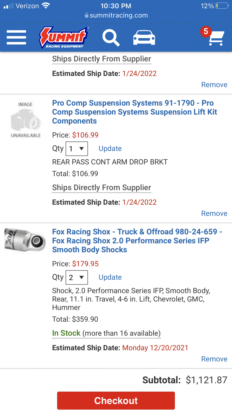

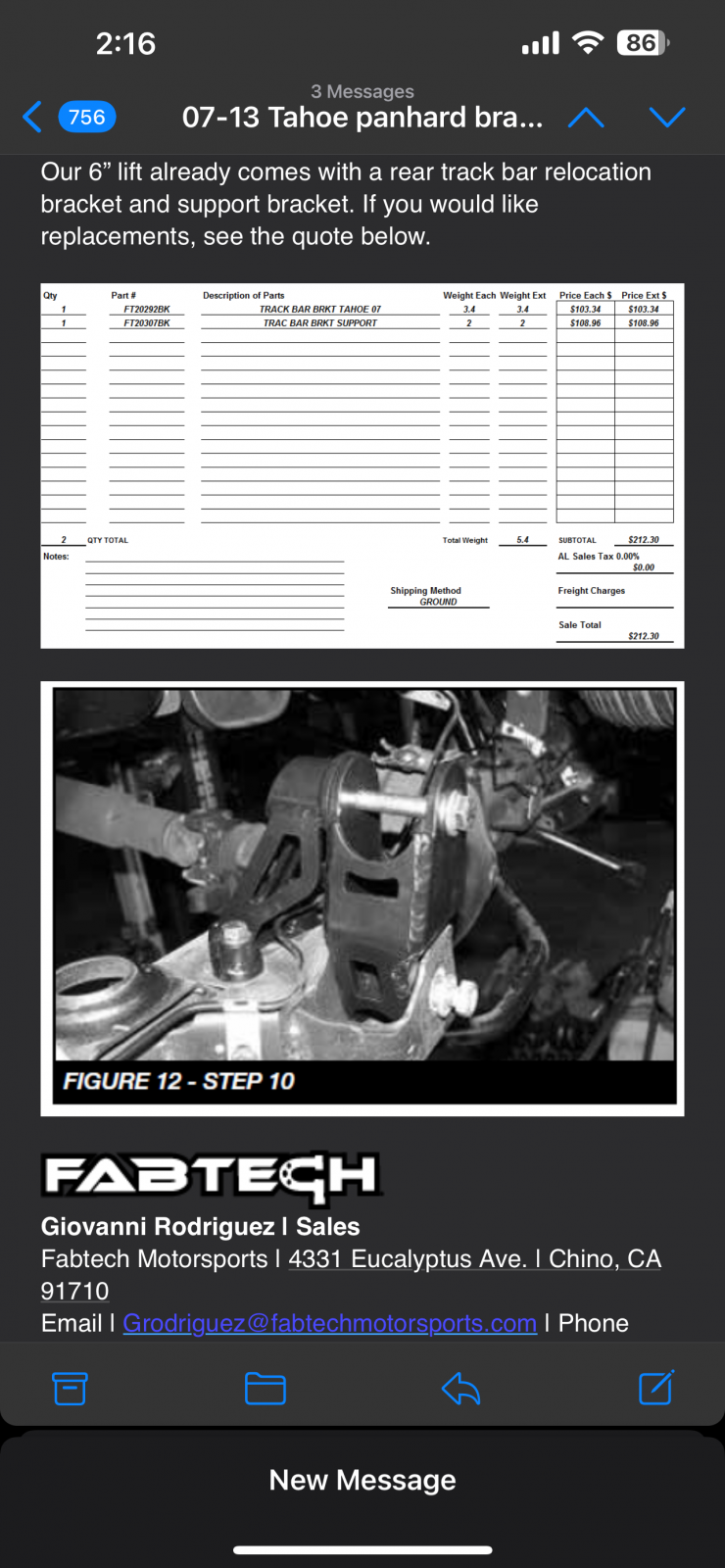

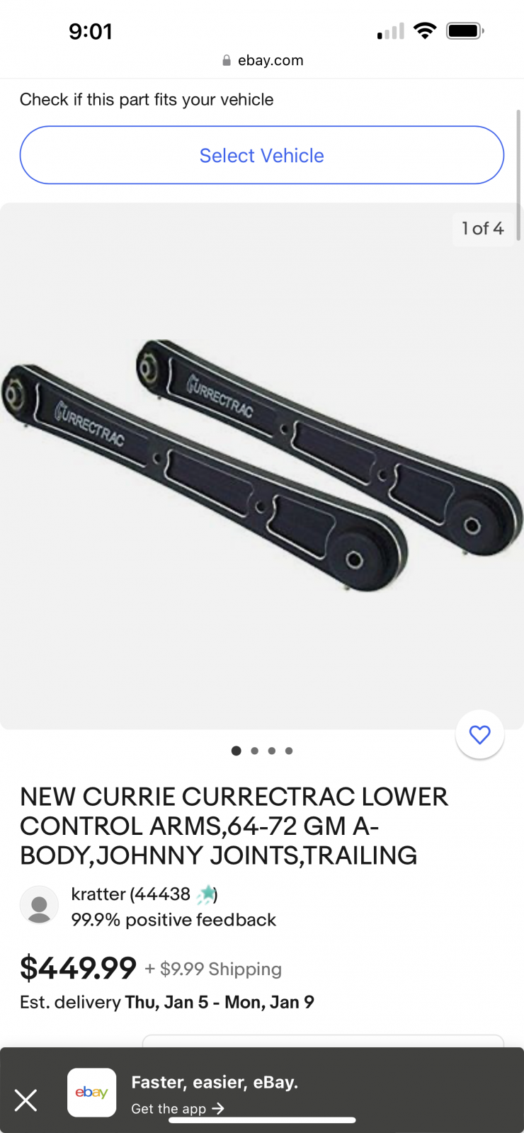

Here’s some pics when I was researching my rear lift
Can’t find the part number for my rough country rear trailing arm drop brackets but if you reach out to fabtech pro comp or rough country and you can buy it separately

Again you could run any brand lift you want and could always buy the panhard and trailing arm brackets separately to get it all right but I get that if you get a lift it should come with everything included with it but for a 4” lift not many company’s add the brackets until you get up to 6”-7.5” lifts
