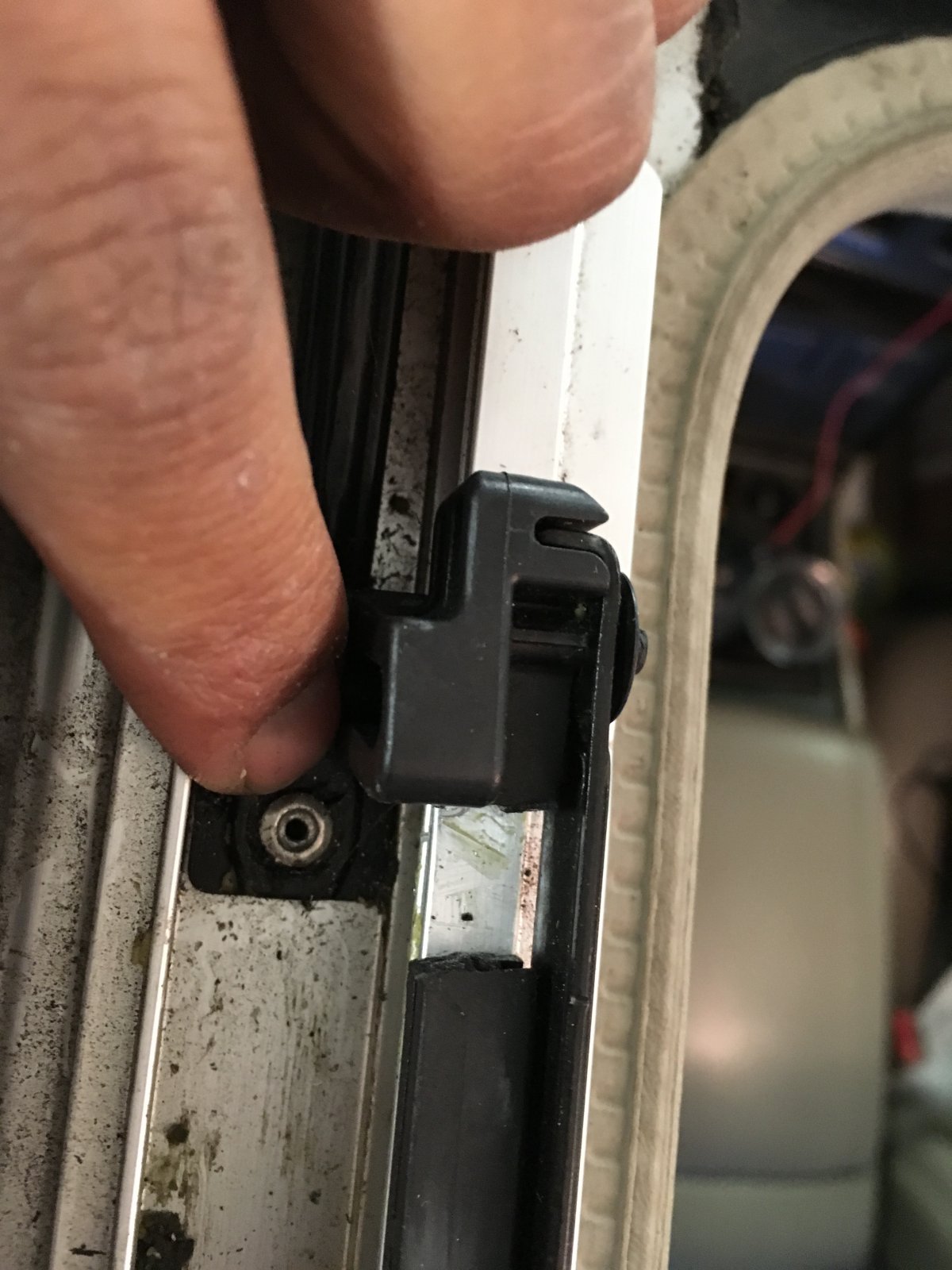

If I trade mine in for a newer one, I’d have to start all over again to get it where I want it! Lol here’s what I used for my sunroof tracks!

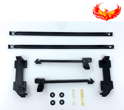

I bought the kit from TG automotive. I don’t believe there were any instructions included with my kit.....

Yeah my kit just came with what was pictured on their website. Interestingly enough when I was trying to pull the little spring loaded clips that attach to the front of the air defector, both of the slides arms broke on the one in the junkyard that I was disassembling to see what I was in for. Such a shame that gm made all the track pieces for these things out of cheap fragile plastic....

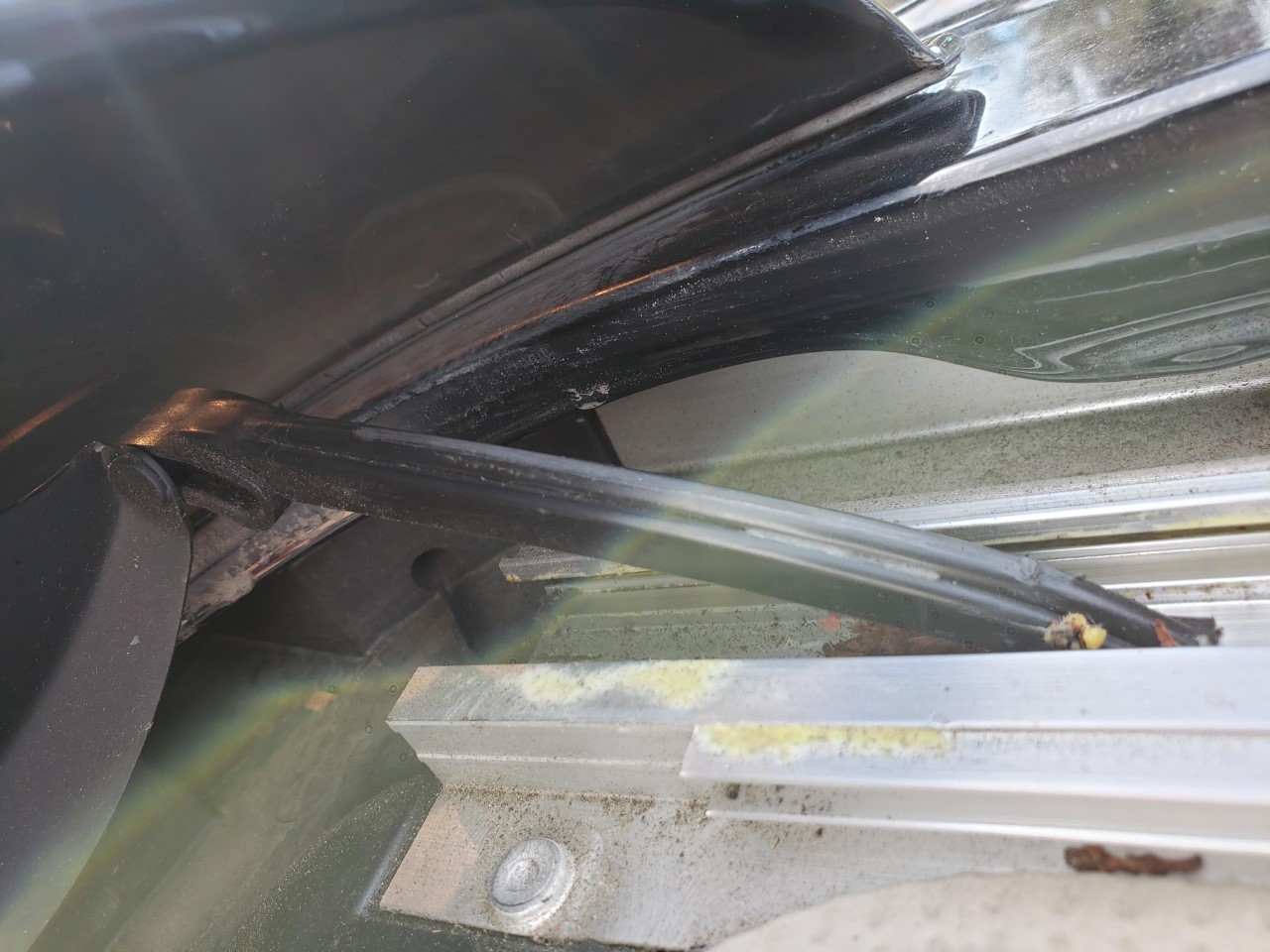

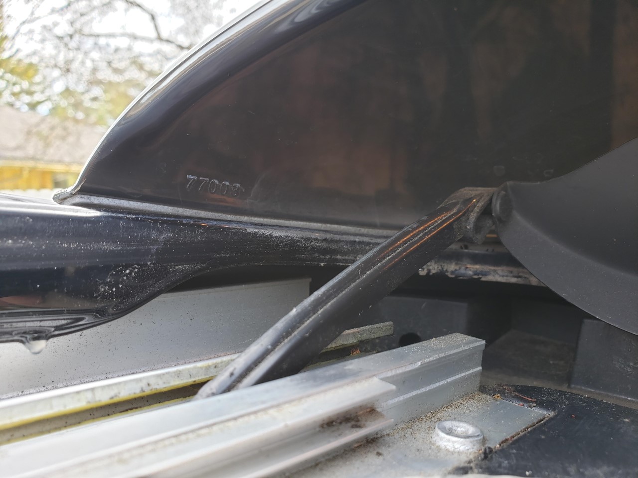

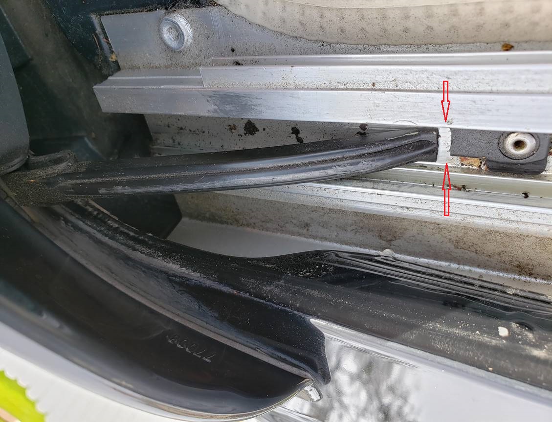

I thought about reposting this as a new thread with a different header for interest however I'll see where this goes.
I contacted Paul at Gruven Parts (www.gruvenparts.com). He said he could fabricate a new pair of arms out of steel or aluminum but needs written commitment for about 20 sets. I sent him pictures of mine. He needs a broken set to use as templates. More research but said in the $100-$200 range per pair. I would be willing to pay this if the flex point (the weak spot) is reengineered and disclosed.
At this point I use my fingers to hold down the deflector until the roof panel catches it. After looking at the shrink tube fix I agree it needs to be long enough to keep the arms from moving forward when the roof panel catches it.
