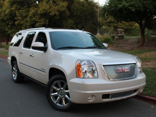

After the 2009 Denali deal fell though (details in earlier post) I was pretty resigned to waiting to find the right 2500. Basically wanted to complete the swap well before a long trip planned to bend, OR this summer. Then this 2012 Denali popped up, literally 2 miles from my work. Offered by a small broker/dealer who cherry picks auctions and tries to turn 5-10 vehicles/month working out of a small industrial warehouse = low overhead. He'd had this one for almost 2 months and reduced from $22.9K to $20,491, which got my attention, so I decided to check it out. He said he paid $19K at auction FWIW.

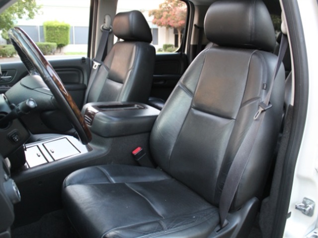

It was the exact version we wanted; tri-coat pearl (see pic), black leather, captains 2nd row, integrated TB, (obviously tow package). I drove it adn did an initial inspection (visual, fluids, under carriage, tried most all the 'bells and whistles'. Everything worked, it was in Very Good condition.
It was a 2 owner, Bay Area vehicle, and using the Carfax report I spent the next couple of days contacting all the service providers and obtaining all the service records. No red flags, some TPMS issues, regular oil changes, nothing major. I even 'Zillowed' the previous owners home addresses (yes, privacy loophole here) and saw that it had come from 2 Very Nice homes. Hitch cover was still on so I removed and saw no evidence of previous towing. All indications are it was a soccer mom rig for the first part of its life.

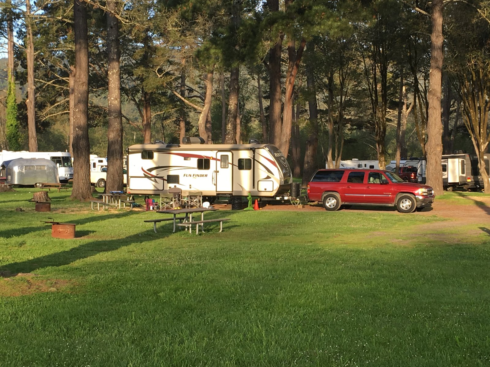

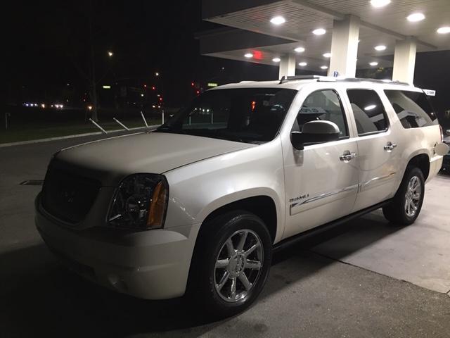

Here's some pics of the new and old:
