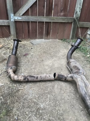

Ok I think I know why I’m having such trouble setting the catalyst monitor. Well as I’ve stated I replaced the cats. Well I bought the whole ypipe assembly. And my only option since I live in good ol California where options for a new catalytic converter is limited because of our ca approved cats. I bought the ca approved maganaflow cat assembly. Well this one was slightly different. It has small precats towards the manifold flanges. The old assembly did not have this. Guess what those little precats are before the front o2 sensors. I think it’s causing some weirdness with the o2 sensors. Yeah other thing also is I have a federal vehicle. But I don’t think these new cats are even a original design in the first place.

Well I’m just gonna punch out the material in those precats that wasn’t made for this car in the first place. I’ll let you guys know if this fixed the problem.
That's what I was thinking. I did the opposite. Mine has California emissions and I put on Federal Cats. The only difference that I could discern are the lack of CARB numbers for my GMT900.

Guess what I punched those precats out yesterday. Drove it this morning and catalyst is ready on the monitors. Just goes to prove the wrong parts can cause some mayhem.
