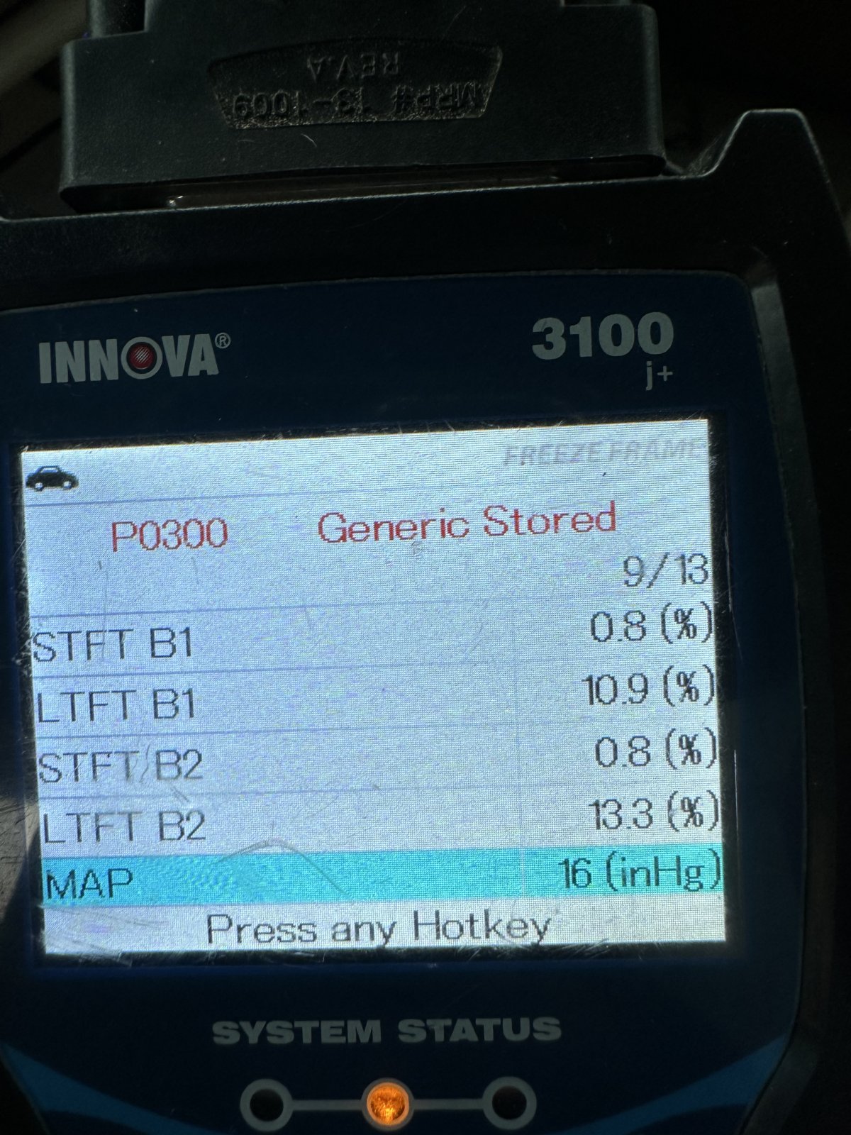

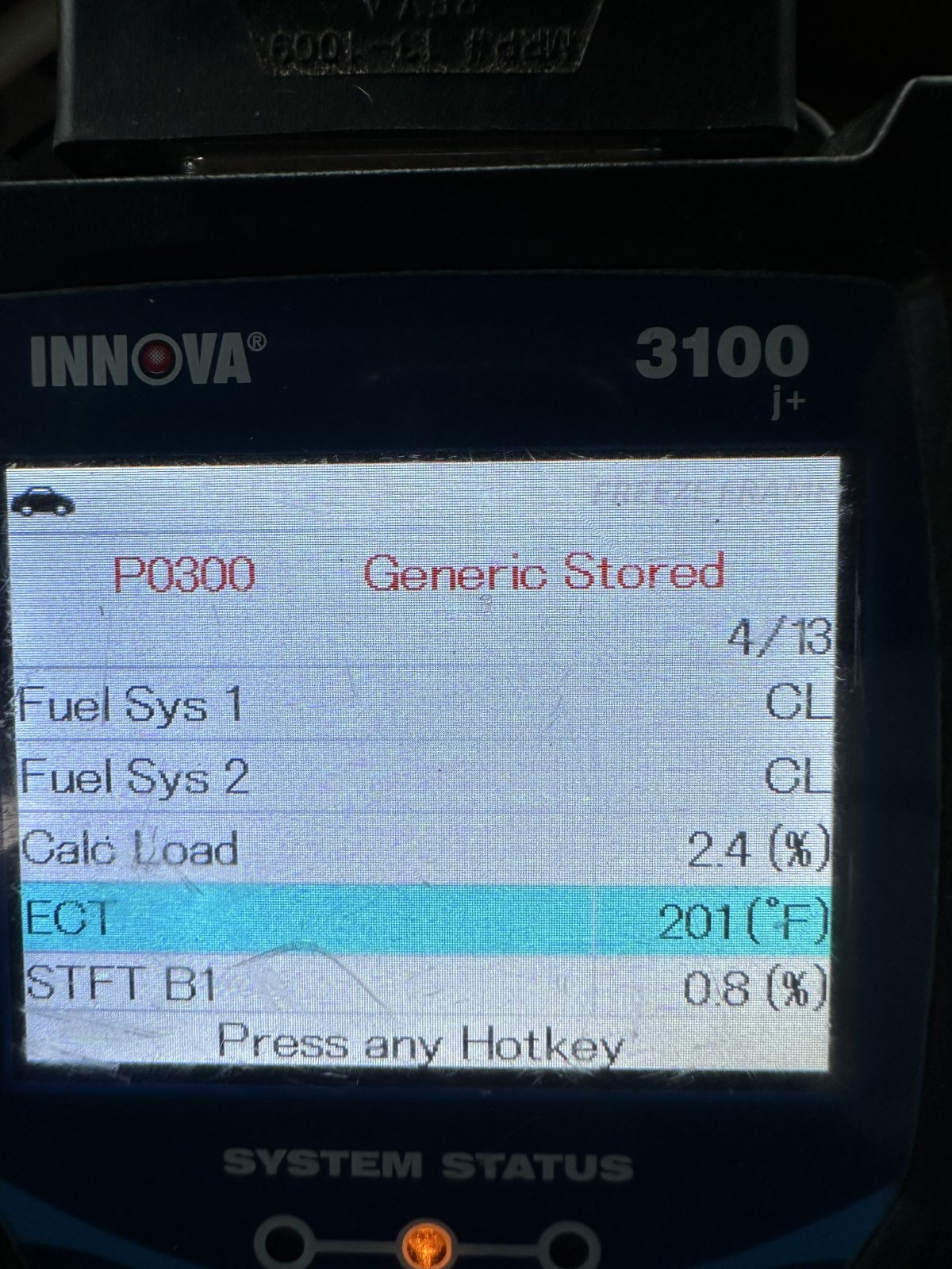

thank for the info, So I guess It a major rich fuel issue. I could not find my newer more detailed scanner but even my old one gave me some much valuable data My LTFT on Bank 2 is above 10% (13.3 to be exact) which i guess to much of the dark web info out there is in the rich territory. So I guess a look at my fuel injectors and MAF is on the check list to check.

Positive fuel trims means that it's adding fuel, which indicates the O2 sensors are reporting a lean condition.
However, your STFTs look okay, especially if that's at idle (couldn't tell the rpm from the pics). Get a scanner that can reset the LTFTs and start monitoring it after a drive cycle or two.

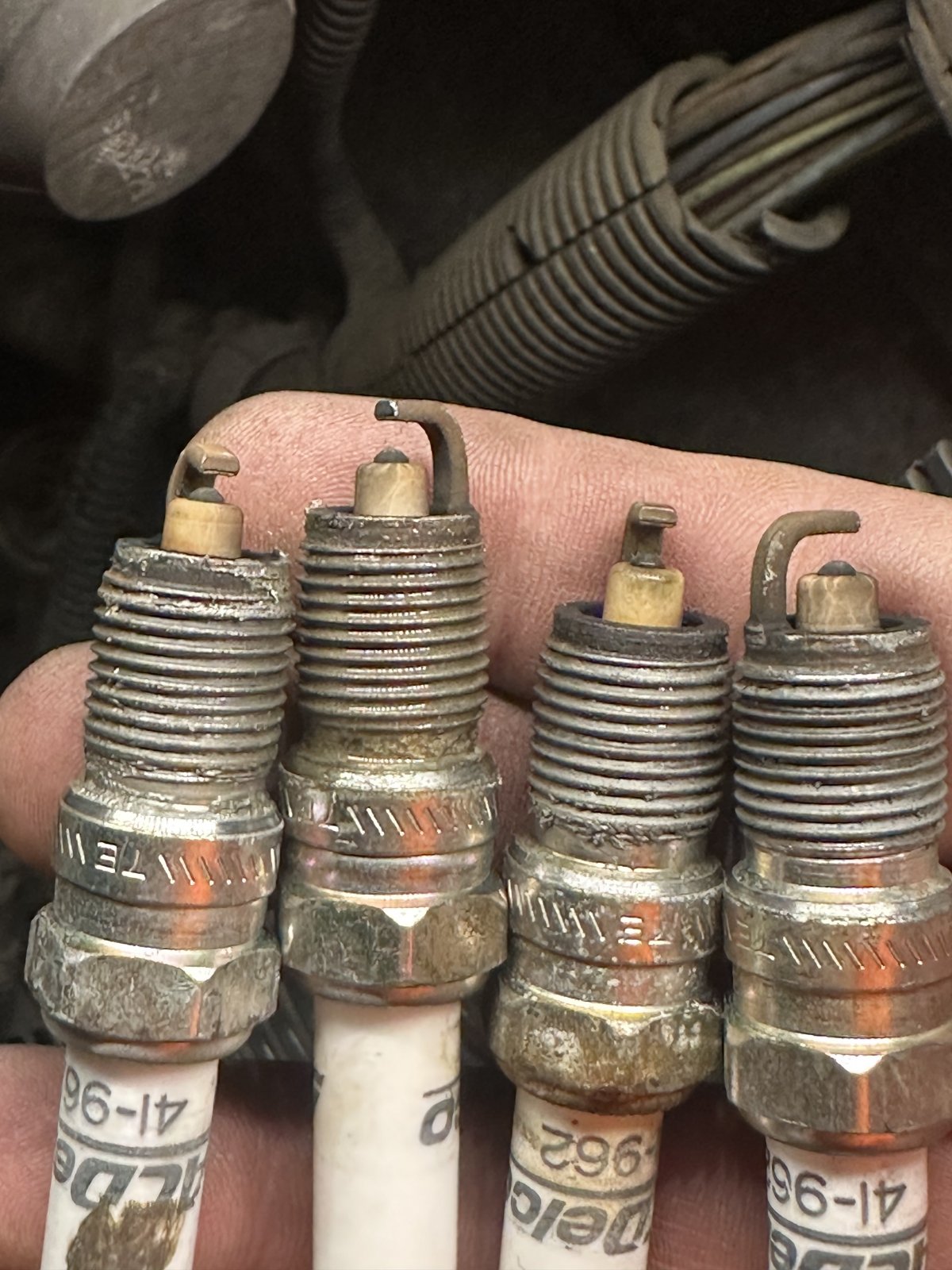

I took out the spark ugs chasing this lean condition. I measured some of them at .080!!! Twice the amount required. Its running better now still need to tune it. But hopefully this at least clears the monitors for smog!!!
Are those counterfeit plugs? I dont see a Iridium tip on those.

They were supposed to be the basic platinum oem plug.
But they very well could have been counterfeit. the gaps were all over the place and now seeing the gap widened by .035in.
The engine is purring again. I hope this was my issue now on to smog and get it tunned.
