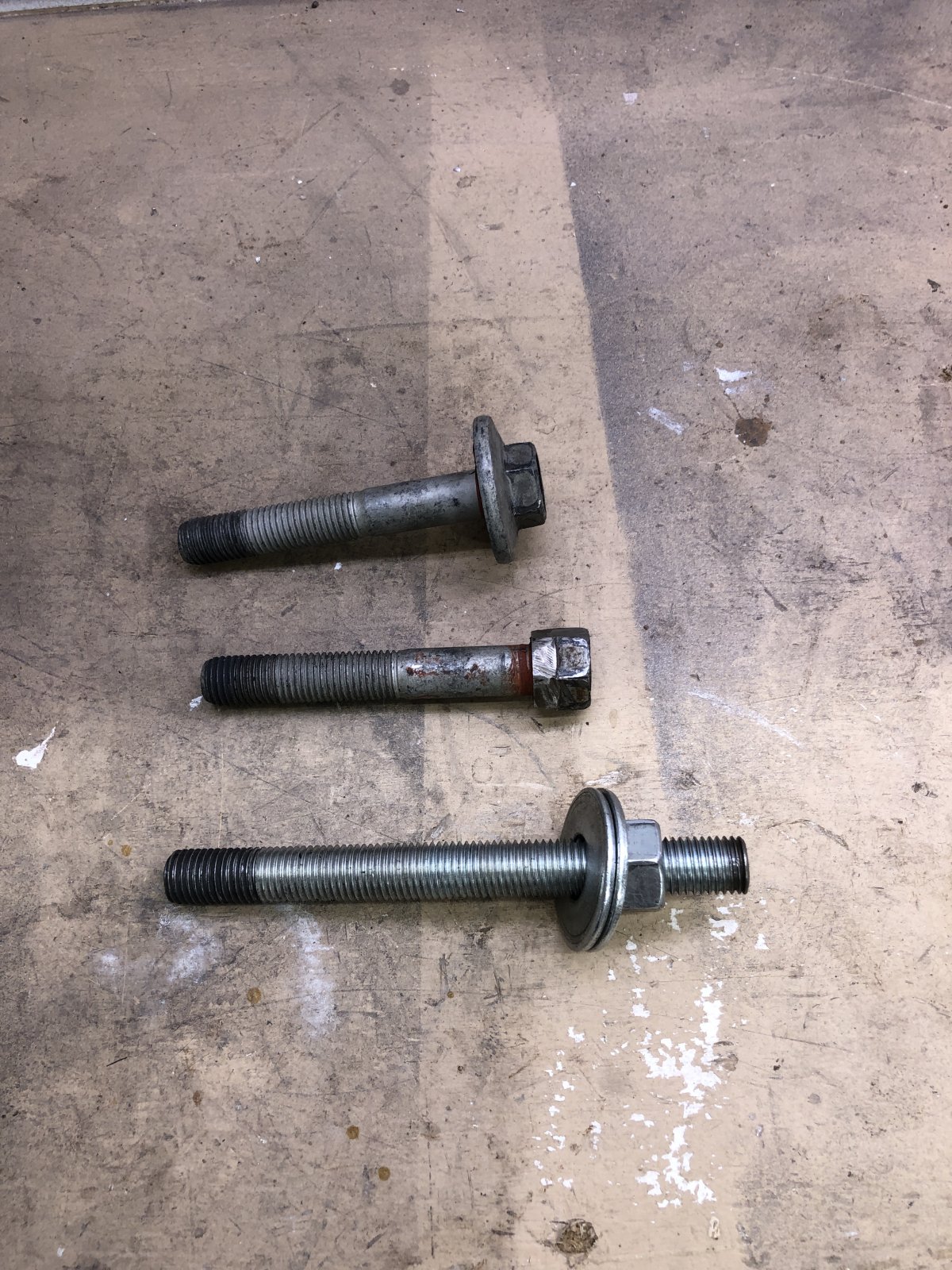

Actually I now remember I do use a long piece of allthread to start the balancer install, for the first 3/4” or so, then remove it and use the regular bolt. Not sure where I got it. Here’s my setup minus the Chrysler puller (OEM tools 27139, available at most parts store loan-a-tool). OEM bolt at the top, modified bolt for the puller to press against in the middle, install bolt at the bottom. The last balancer I did took 10 minutes off and on.

I have the balancer off. I was researching install tools to put it back on. I went ahead and ordered the one from Amazon I pasted the URL for. Seems the commonality is all of them have a long all threaded bolt, some use a bearing some don't and some have a head which to put a wrench on I suppose to assist in removal.
I decided to try the one with the bearings figured it would hurt and hopefully help the process. I see in the thread above -Just Fishing- had some issue with the bearings falling out. I'll keep an eye on that.
