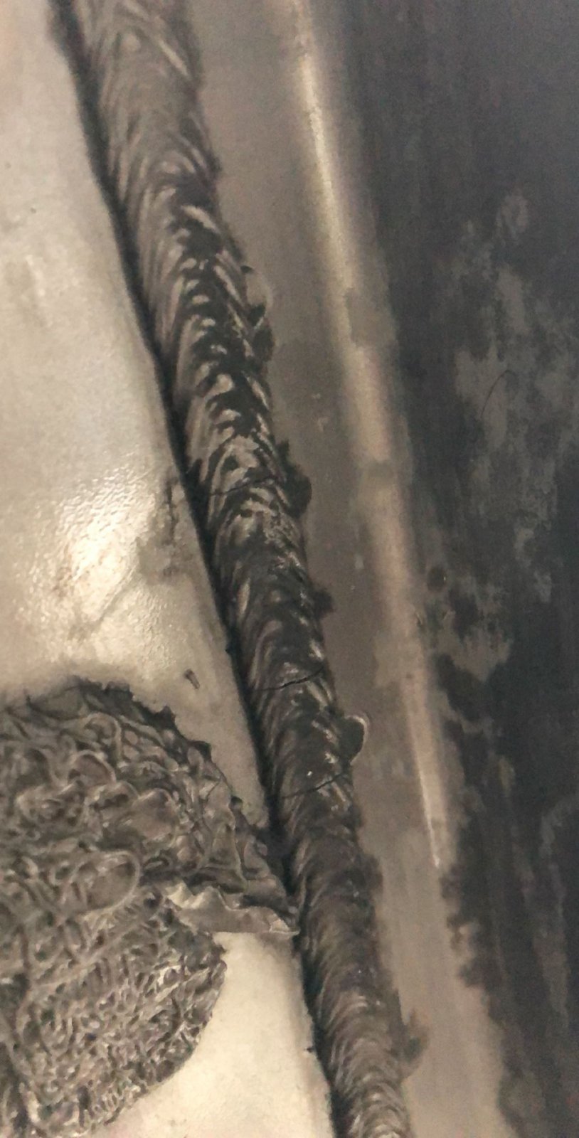

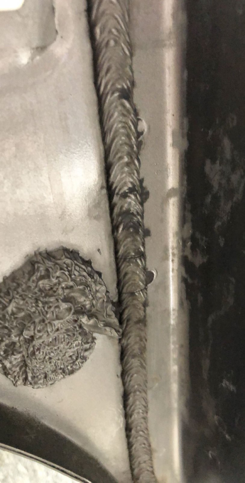

I had like 5 cracks in the body seam sealant stuff on the outside at the firewall. Body shop took the front fender off and resealed it! It was an 11 and water was puddling right there then got the point it was constantly holding water.
